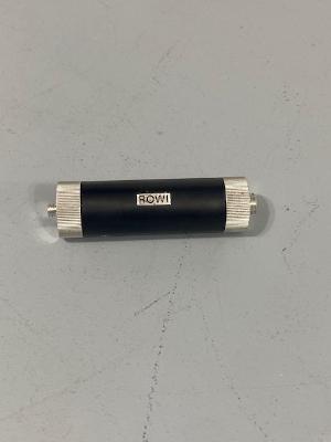

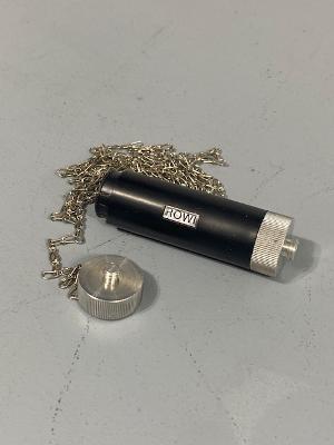

Any idea what this used for? 1/4” tripod screw on either end with a 4’ chain between.
Thanks

Could be. Had thought about that but discounted since the tube is plastic and durability would be limited. Still no sure why the tripod bolts on both ends?

A portrait focus chain. Free end goes in the camera's tripod socket, subject holds the black part under their chin while the photographer sets exposure, loads film holder, pulls dark slide, etc. -- then lowers their hand just before exposure.

Good questions. There is a quarter and 1/8th thread at either end for flexibility of use. I suppose they used crepe shoe soles then. 🙂
Here is something
Look at the third picture down in the description and enlarge. There is a woman standing on a Rowi Chain Pod. the describe it as 180 cm but the pic shows 100

Ok got it!
Could have some application for point and shoot cameras with zone focus (once distances have been determined) or cameras with a tripod socket but no focus at all once closest focus is determined.
Thanks for all the responses!

Thanks Bill, the "Article Number" in the catalogue matches with Article Number 100 on the box.
"Rowi Chain Tripod" with 6' of chain.
Thanks Donald, Rowi didn't know it had a dual application as a "Portrait Focus Chain"!
