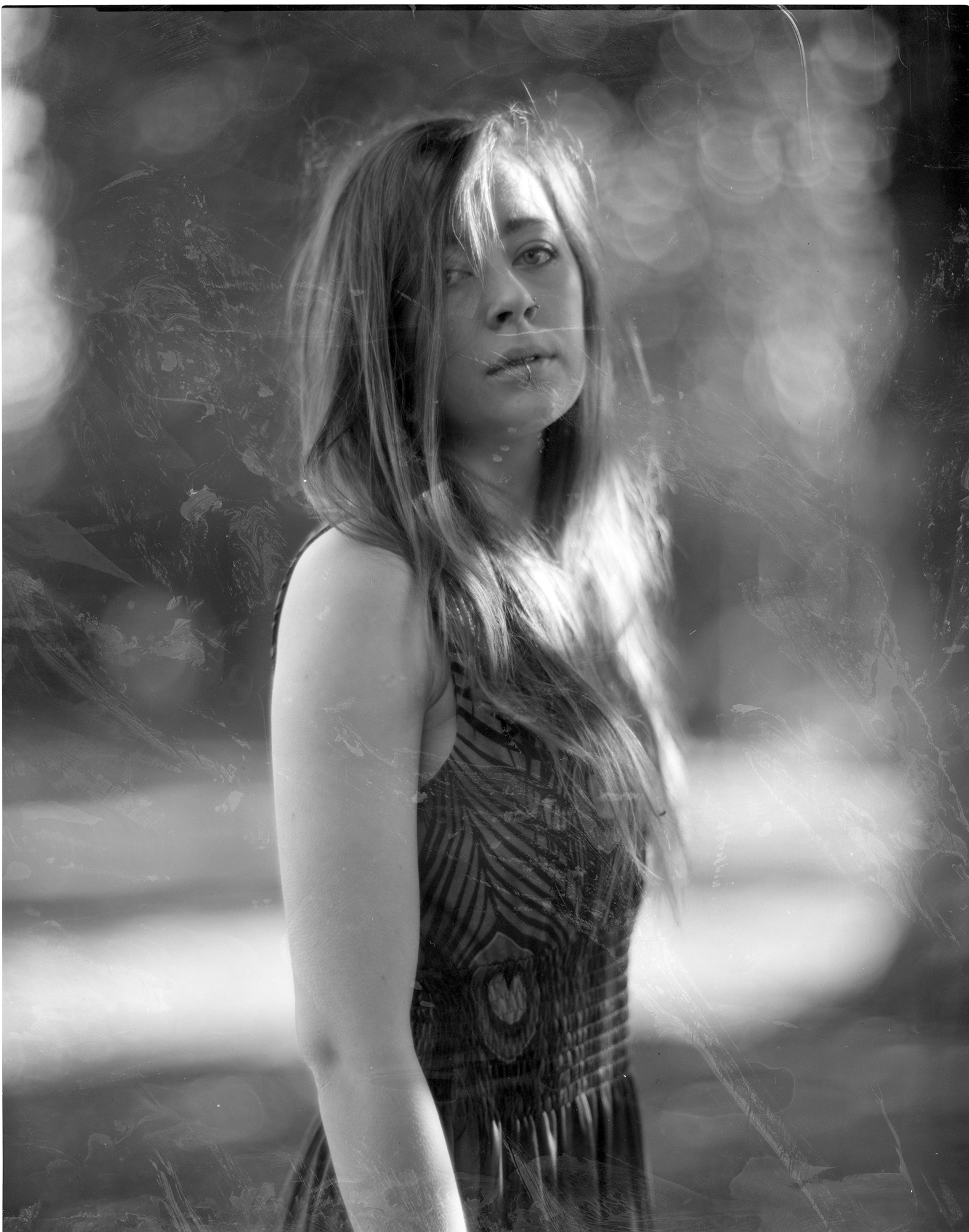

Hi all, I am developing Fomapan 100 in xtol 1:1 in a patterson Autotherm. This tales 4 sheets of film at a time. Some of my negatives usually 2 of the 4 come out with a strange swirly residue that ruins the picture. Any ideas what it is or how to avoid it?
My xtol is used as a one shot, the fixer is C41 fixer. Although I reuse this, the fixer clears a negative in 1 minute when tested today. My process is presoak x3, dev, stop (reusing a stop), fix. then lots of washing. I dry them indoors on a piece of kitchen towel.

Hi Frank. I prop them against the wall on the top edge with the bottom edge on the kitchen towel. Seems to work fine. I used some white spirit to wipe the residue off the negative and ran it under a hot tap. Seems to be fine now but not sure what is causing it!

Any visible stuff floating around in the chemistry, especially the stop and fix which you are reusing?
Are you using a rinse agent (Photo-flo or similar) after the wash?

For your final rinse, try using distiller water with a bit of photoflo.

I agreewith the distilledor demineralized water rinse. Also;if you have hard water in Kentyou may want to add 0.5 g/l of Calgon to your HCA.photocalgon is best;check with Silver Print in London but,regular Calgon will do in a pinch. it will prevent calcium scum from settling on your negatives:cool:

My chiltrens water is real hard with calcium carbonate coming out of solution & boiling and then filtering when cool for final bath is simplest solution.
Add lots of surfant as well
But for 120 and 35mm I need to use a film squeegee post hanging up in clips which if you clean it before every use has not scratched in ten years yet.

Get rid of the kitchen towel and never ever use white spirit on a negative. Don't wipe the negs but just dunk them in some de-ionised water for about 30 seconds after washing and then hang them to dry in ambient temperature for a few hours (be patient).
