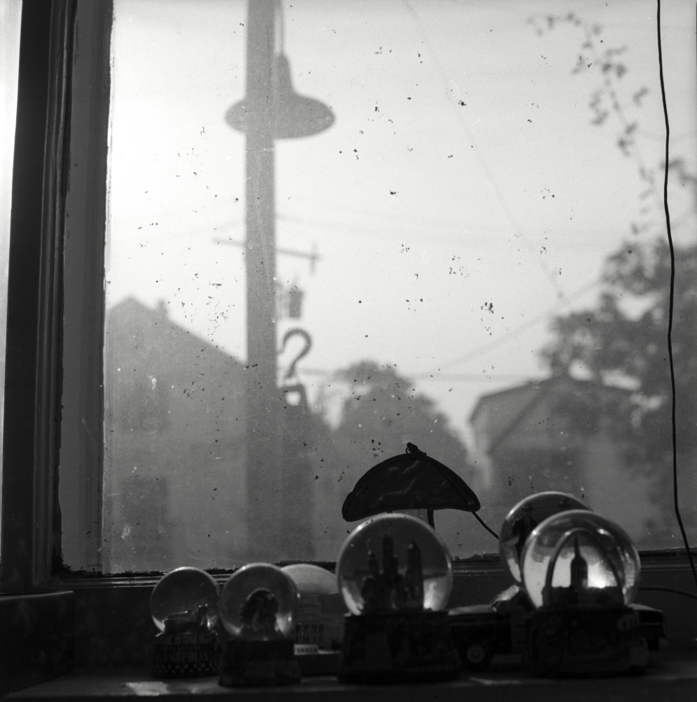

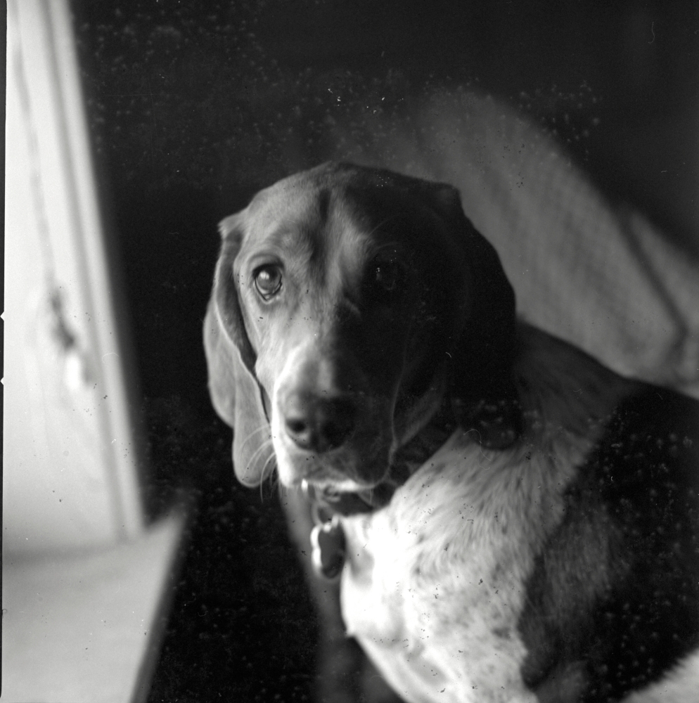

These are a roll of PX125, 120, fresh, dev'd in D76 1+1 at normal time, stop and fix in normal fix. I did some rolls of Tri-X in the same stop and fix and made fresh developer from the same jug and those rolls were fine.

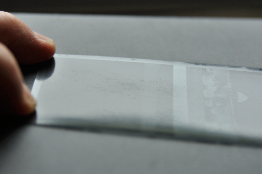

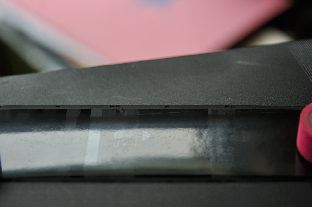

Two types of damage seen in the dog and the window pictures: there are no marks on that window, that's all emulsion holes. The marks in the shadows of the dog picture seem to be rubs or clouds in the emulsion. Then a couple of pix of the roll from an angle to see the emulsion damage.
Anyone know what this might be?
thanks.

You have 2 problems here, at least. In the dog picture the spots are white and in the window picture they are black.
Now thinking of the negative, the dog has dark spots and the window has light spots. Typically, air bubbles or pinholes are low in development and circular leaving lower development on the negative and thus light spots. So, the window picture might classify as having pinholes but they are not round in your example. The dog picture has what looks like dust or dirt. The window picture has some appearance of pinholes.
Did you prewet the film before development? Many films cry for this treatment to prevent pinholes (air bubbles). This varies with film and often vary from film to film type in the same tank.
Is your drying area dust free?
If there are rough spots on the film it can be either dust or lint or even particulate matter in your water supply.

The first photo of the dog almost looks like moisture buildup, like the emulsion was sweating when the exposure was made, then it was rolled up into the paper. You commented the film was fresh, was it ever frozen before you got it? Given what I have seen, I would concur with Thomas that it wasn't fully thawed out. The damage is physical in nature, reticulation doesn't do that (heat) from temp fluctuations. The last photo is the strongest evidence of this concept.
