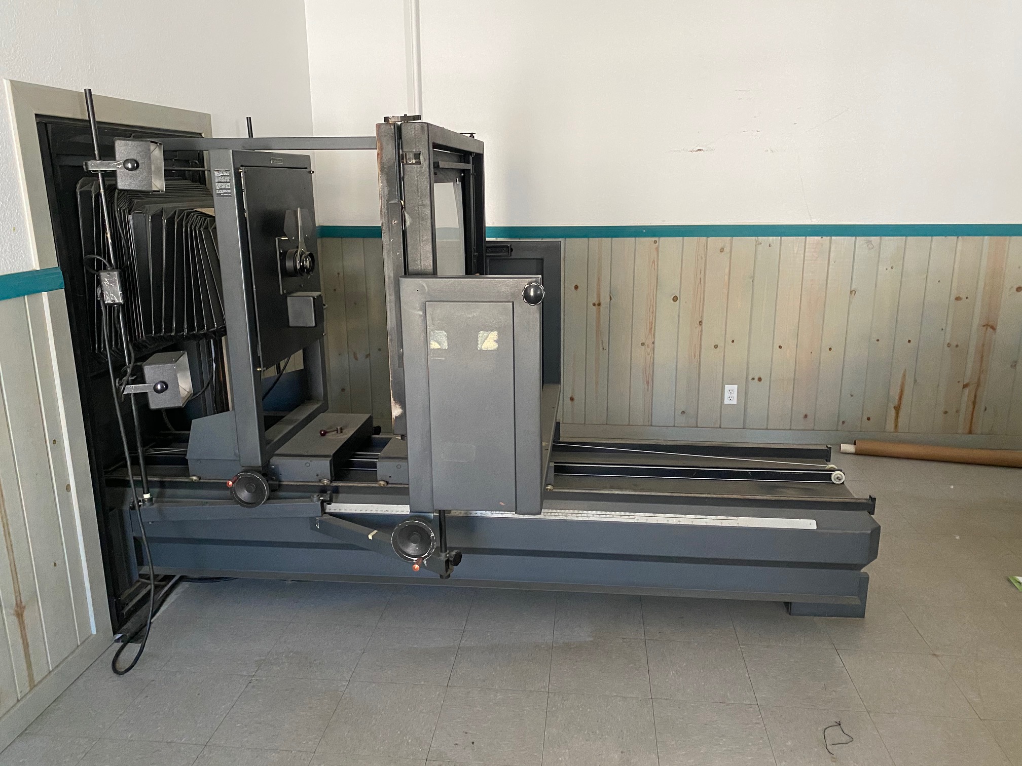

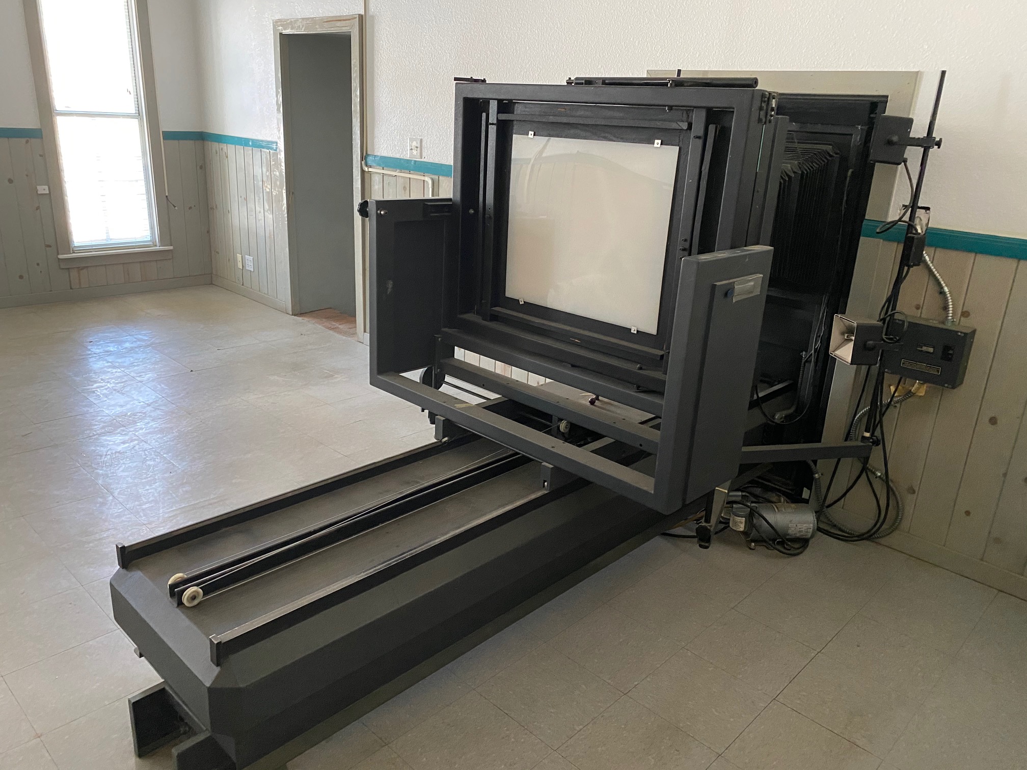

What is this, please? It's inside a building in an old mining town in Colorado.

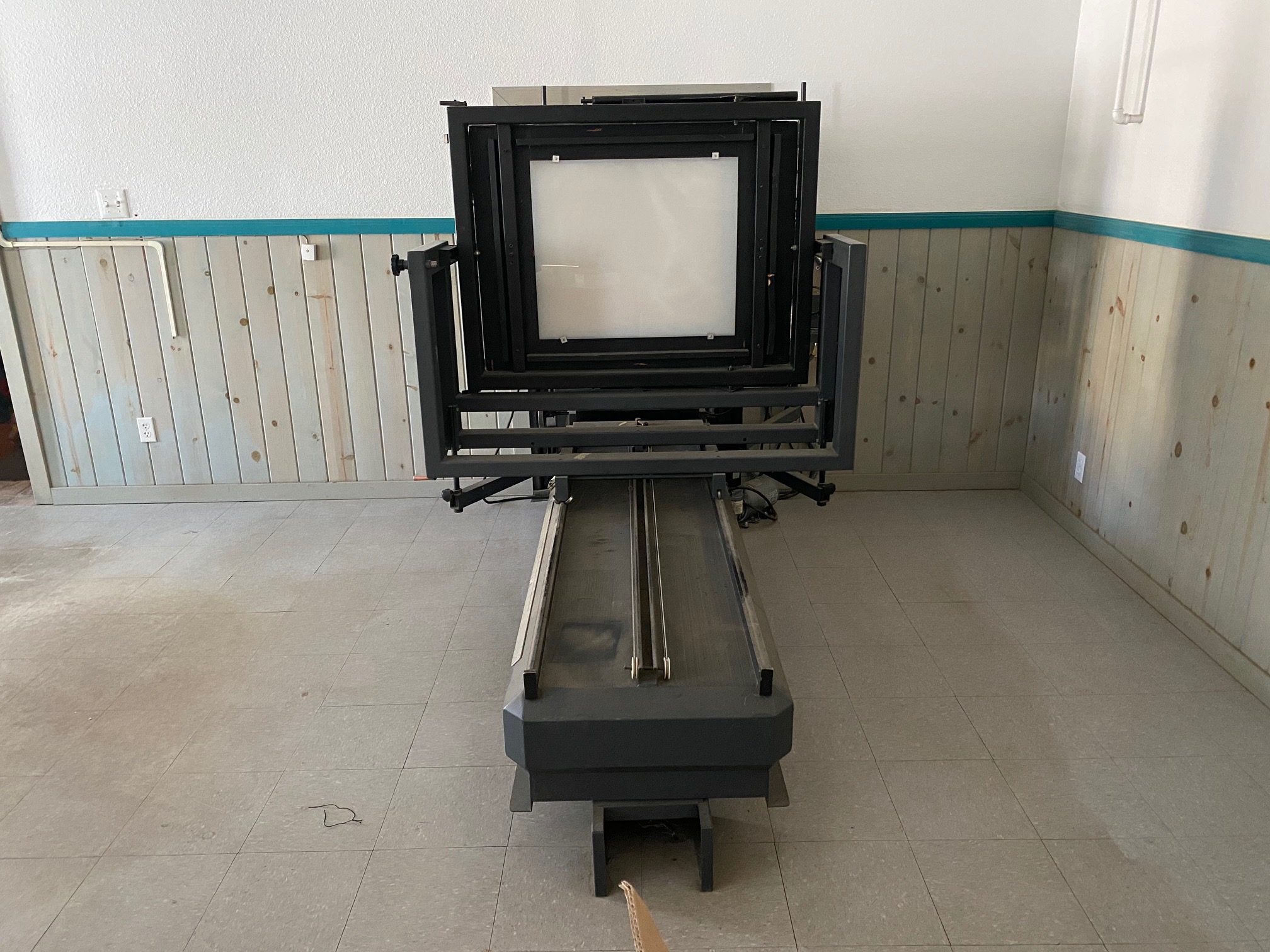

Is it built into the room? Any idea what it's for? Thanks!

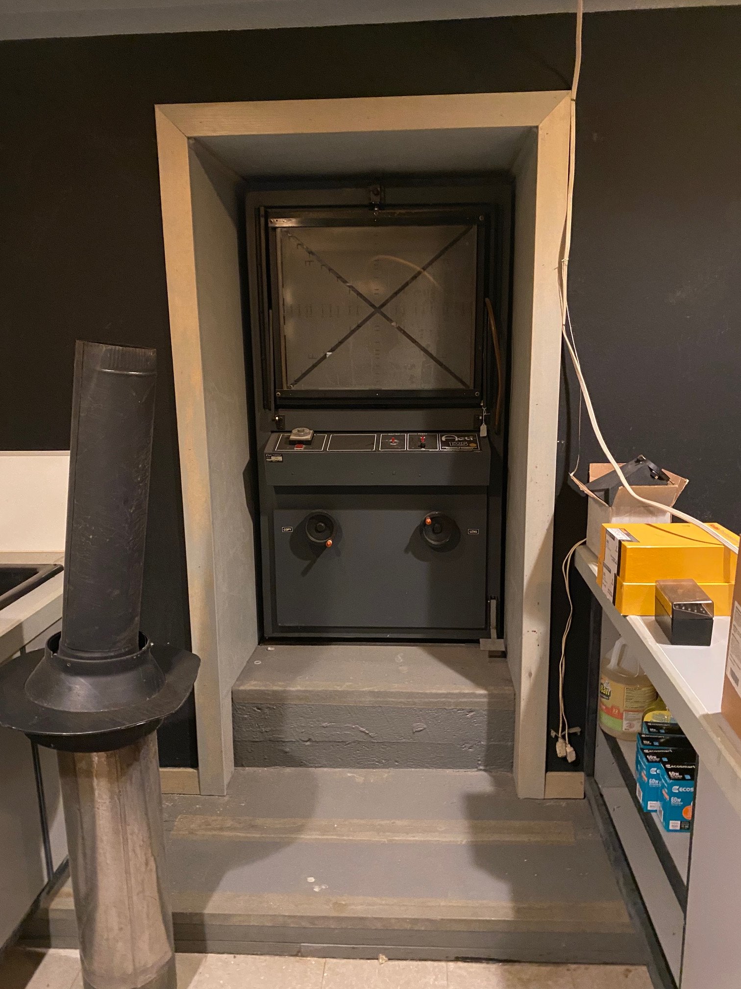

When I worked at the headquarters for a pretty big convenience store chain, they had one of those for making in-store signage. Think HUGE pictures of donuts. The subject photo is vacuum-packed between 2 plates of glass on the rolling stanchion and the ground glass is viewed from inside the darkroom (image14). As I remember, the film sheets were something like 24 or 30 inch squares. The resulting photo would then be taken next door to the gigantic offset printer. The darkroom guy was a friend of mine and he used it to enlarge some 8x10 prints I had to around 20x30. They turned out beautifully.

I used to use one in college, the rear portion was inside the darkroom.

I used to use one nearly identical to that in the ‘70s at my hometown paper, brand name was Clydesdale. 4,000 watts of light, held up to a 24x36” sheet or thereabouts on the vacuum back, could size beween 25% and 200% and it could be configured to copy transparencies as well. Had a ground glass the hinged from the top to check fine focus.

Ther have been a few of these cameras adapted to fit in the back of a van for landscape photography and I guess anything else the van can be parked in front of. I guess any movements needed would be accomplished by the placement of the film on the vacuum back.

The rooms on either side of that camera are considerably less crowded than when it was in operation!
The version that I worked on was smaller, and it was vertical rather than horizontal. Even so, that camera was big!

Newspapers used these as part of the printing plate production process -- a page was made up with printed-out pictures on paper held in place with hot wax ... a negative was produced with this camera that was then "contact printed" onto a special plate that was then exposed, acid-etched to produce a printing plate, and put on the press to print the daily news.

Had one of these when I worked at Ford Motor Co. Was used for copying large drawings. This was in the early 60's, when Xerox machines were just being introduced.
