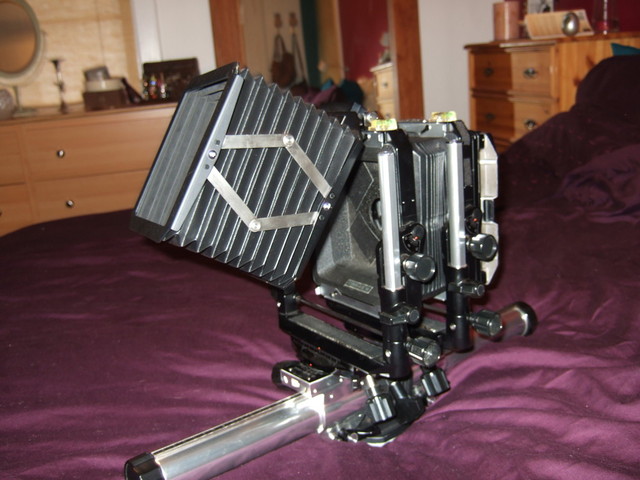

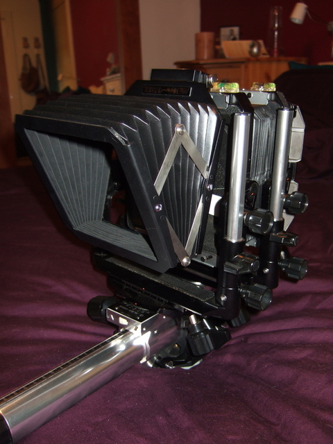

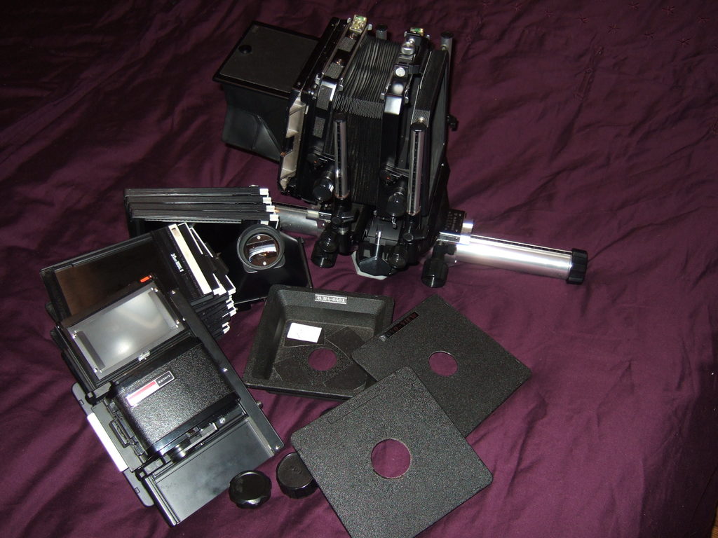

]I searched this site and found quite a few links, but nothing that really answers what this is used for. A set of swing-away bellows in front of the lens. Just a lens Shade? maybe someone can help. I acquired this camera from a work mate and new to large format, but motivated. Someone directed me to Apug today, seems like my kind of place. I work in a custom photo lab.
Here are some pics for help on my question thank you.

It's what is known as a compendium lens shade. You can adjust it such that you eliminate any vignetting.
David A. Goldfarb
Sep 7, 2002
19,974
Honolulu, HI
Yes, it's a compendium shade. If your groundglass has cut corners, sight through each corner after you've set up the photograph and focused and adjust the shade so that it's just outside the field of view in each corner, so that it will restrict the image to the minimum necessary, reducing lens flare and bellows flare, but won't vignette. It might also accept 4" square filters on the back standard and possibly masks on the front standard.
