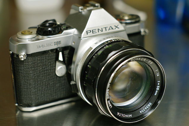

Thinks for the pointers guys. So what is the difference between XD and XE? Don;t seems to find it in the Rokkor files. I think X-700 is sooooo 80s looking it is better left to the Hipster crowd.
@Jedidiah Smith, Oh yes I do like the 58mm, I picked one up for $5 with missing parts and stuck aperture. So I converted it to Pentax-K and loved the results. Now I have to experience the 58mm on a proper body as the Gods in Tokyo intended. Hence my request for an OM-2 equivalent Minolta body.
It really is pity so many in the m4/3 crowd are buying the kit and dumping the body. At $20-30 a pop 35mm film bodies are like interchangeable film backs these days.
