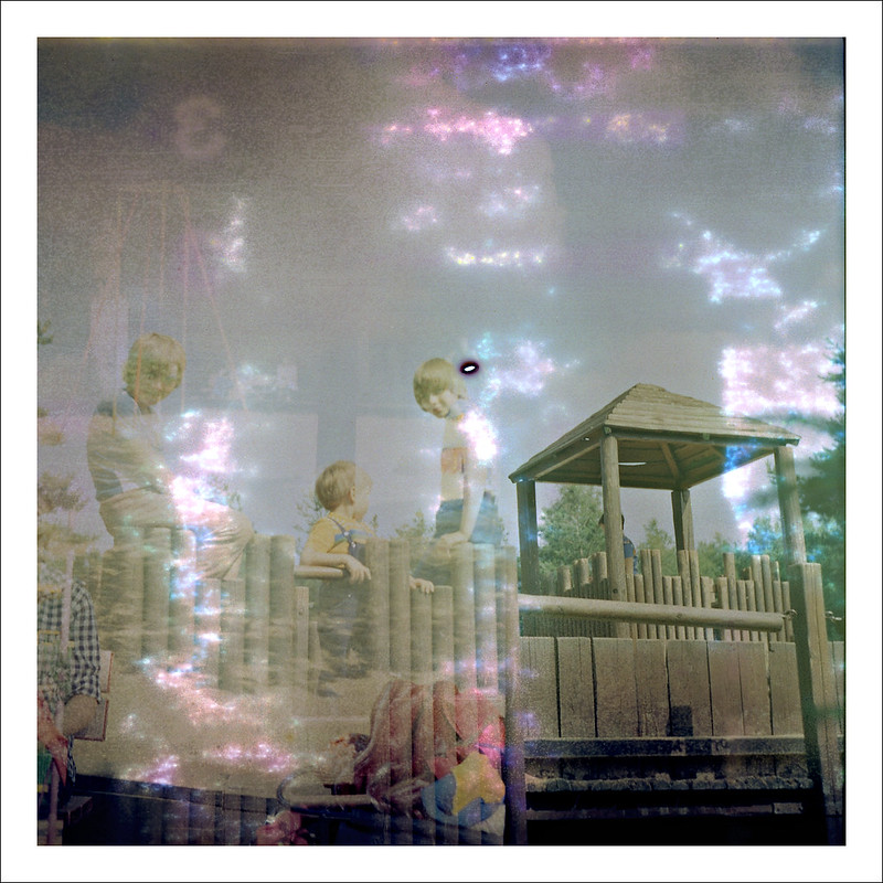

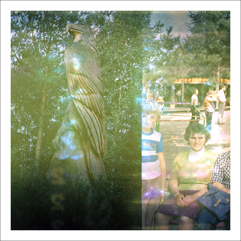

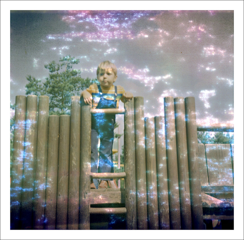

Some times ago -while cleaning up my parents-in-laws house- I found some undeveloped, Kodak branded medium format color negative films. This is what I got - the little boy in the pictures is my brother-in-law (today in his mid-40's):
Regarding the imprints here even 40 years ago Kodak had a backing paper problem ... :wink:
