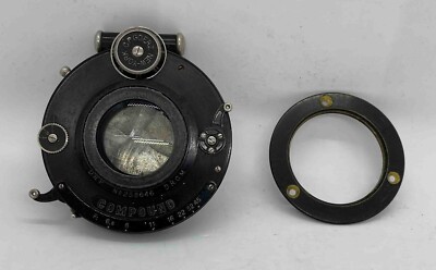

It doesn't seem like the number is printed on the shutter anywhere for me to recognize in a photo. My chatbot told me the #5 has a maximum speed (or minimal duration) of 1/50th of a second.
This seller below kindly measured the interior diameter of the shutter, gave me a measure of 78mm, which I thought is close enough to the #5 diameter of 83mm to be a match. But he also said the fastest shutter speed is 1/150th of a second.
Is my chatbot wrong? Is the seller wrong, do you think?
Thank you for your wisdom.

Isn't a Compound shutter a very different shutter from an Ilex? I think so...

A. Compound with a top speed of 150 ought to be a no.3 Compound, with a SHUTTER mounting flange of 60 mm. So the measure iof 78 mm is confusing, from the top of my head this seems to indicate a no. 4 Compound? But a no. 4 Compound has a max. speed of 100, if I'm not mistaken. And a 210 mm Dagor should easily fit into a no. 3 Compound.
I believe a no 5 Ilex and a no 5 Compound have approx the same sizes. But please note, they are not interchangeable!!
