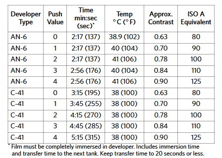

Aerocolor aims to a much higher contrast for aerial photograhpy than what we are used to in still photography (contrast around 0.60), so the developer is more energetic than C41 one. Take a look to the table below taken from the film datasheet.
Or is it almost identical, but designed for higher temperatures...
