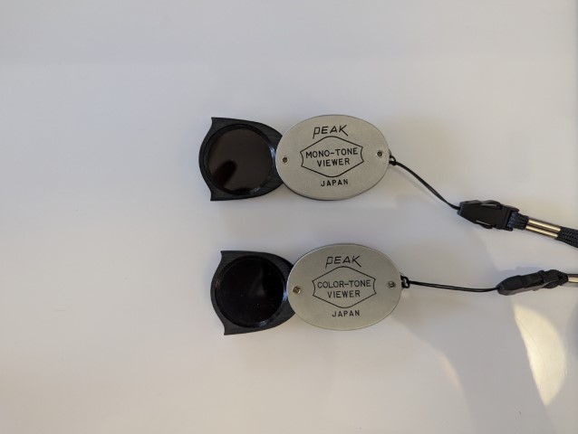

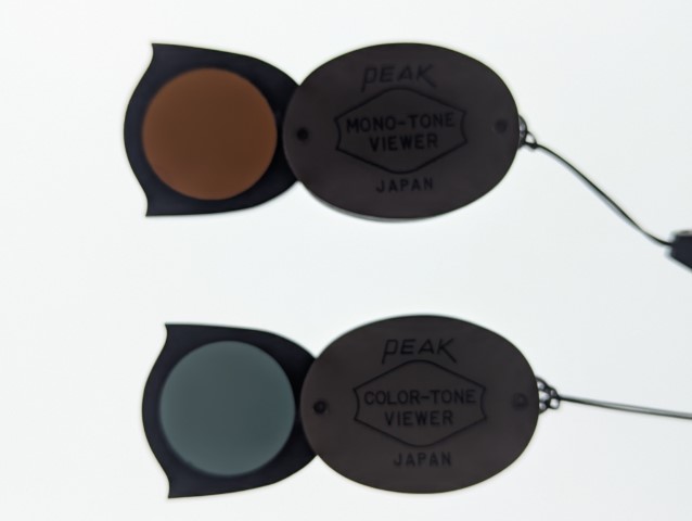

The Peak Mono-Tone and Color-Tone Viewers
To show the filter colors: Mono Viewer top and Color Viewer bottom. Hope this helps.

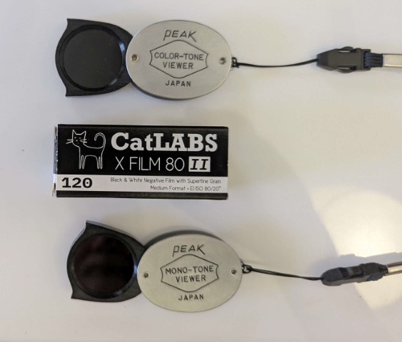

For size comparison

It looks pretty much like a 2-stop ND filter. Which I suspect is what it is, for all intents and purposes. An old friend of mine used to work in the cine industry and I recall him telling me one time he used to use a viewer to guesstimate/get a feeling for highlights & shadows. He described the same procedure @Kino gave:
You are supposed to look through it with one eye and "flick" it in and out of your field of vision to see where the high, mid and low tones are falling.
It's a bit similar to using the DoF preview on an SLR camera very momentarily.
