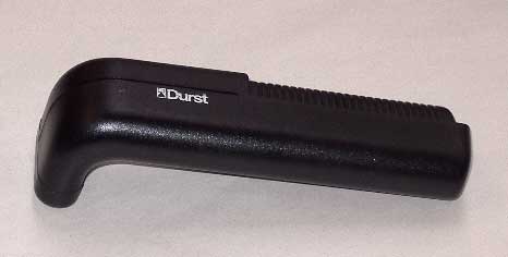

Ok, folks. I am at a loss. I have found this thing in a cabinet in the darkroom I inherited from another teacher (long gone.) It says Durst on the top and clearly functions as a hand-held static electricity generator. The point of the exercise is what I seem to be missing. Why would this be useful in the darkroom? Was it used to recharge a brush to collect dust? ( best guess so far and not, I think, all that good a guess at all)
You're right, they where sold around 1980, saw one at a local shop that days.
I have one of these from Rowi. They have a Piezo generator in them to produce high voltages as an ionization "zapper".
One holds them to the film and presses the button (perhaps a few times) until the static charge is completely neutralized. Mine even has a little lamp which shows when things are done (it lights during the zapping but stops when there is no static charge left).
They are actually very effective for treating a single negative (KB or even rollfilm) just before you put it into the enlarger. I use mine in combination with a Kinetronics "Mini-stat" brush. The pairing is a bit like a subminiature and highly portable variation on the big Simco :smile:

So, now that I know that the thing is not just an evil toy meant to zap your hand when you innocently hold it to your palm and squeeze the handle... how does one use it? Do I zap my negative after blowing it off with gas or do I skip the blow off hoping the dust will simply leap from my neg after a wack with the magical zapper? Do I zap a brush and then brush the neg? I was guess I was mistakenly thinking that it would deliver a charge, not clear one (my physics is a little rusty, I'm afraid.) Should I put the negative in a carrier before zapping?

I've read some interesting articles and reviews of this thing since finding the first web site. They can be had for about $69 on all the other sites by the way...
Anyway, two thoughts.
If you zap a neg, it would force a charge on the entire item, including tthe dust particles. Like charges repell and the dust should technically pop off the surface of the neg. Technically...
The other thing. It has been mentioned that too long an exposure to the zapper will create enough of a charge to then attract dust.
I have seen many writings about it's use in the scientific field and it apparently works as advertised. But it apparently needs to be used correctly and with just the right amount of 'zap'.
It also apparently is a simple piezo device almost identical in mechanics to a barbeque gas lighter. One person suggested simply removing the return lead from the lighter tip to prevent the spark, and you have a static zapper for a couple of bucks...
- Zap the negative holding the "thingee" a short distance away (not touching!) and pressing the button. It probably does not have much a charge.
- Blow off the negative. This will, of course, create a charge (triboelectric effect).
- Zap the negative. Then another blow and another zap. For blowing I use a big rubber bulb from the corner pharmacy.
- You can also use a good brush to dust the negative off. This can be one of the fancy ones from Kinetronics (or other specialized vendors) or a good goat hairs brush from an artist's supply.
The combination of air, brush, zapping etc. is really a mix of mood and contamination (dust) problem. Blowing off a dusty negative tends, however, not to be a good idea. Here start with the brush! Whichever way you do it, the other way is just as logical. That's why the industry has delivered anti-static air guns; non-contacting (brushless) film cleaners (use a bunch of tiny air jets); brush and vacuum (typically a fan); brush, anti-static; and brush, antistatic and vacuum models. (much like the mountain of shoes in Doug Adams's "Hitchhiker's Guide" which can drive some to digital, aka "shoe event horizon", only to then have dust problems on their sensors).
Another tip: Get a small piece of Dycem sticky rubber and use under the negative. Much of the dust falling from the negative will land on it and stick. (and yes there are even film cleaners made using this property).

Thanks edz, and all who added to my poor sum of knowledge. I'll give the thing a try. It has been hanging around the art studio where I teach and I could always tell when somebody picked it up and played with it as I heard a small "ow!" as some kid held the business end in his hand and squeezed the handle. I finally put it away. Now that I know it may be useful, I'll dig it out.
