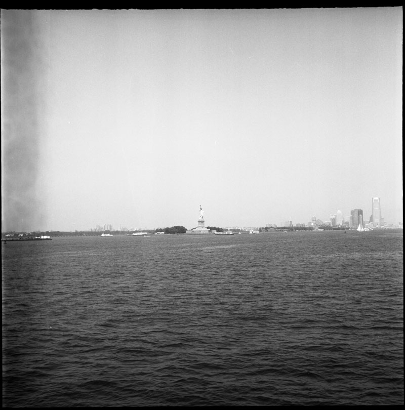

What is causing these smudges?
202,083
2,834,856
101,105
admirall
freecom2
Feb 7, 2011
116
I'm pretty sure this is a processing problem - it's happened on negatives from two different medium format cameras. My developing is:
Kodak T-Max Developer, 6:45 at 20 degrees celsius - time adjusted according to Ilford compensation chart
Ilford Rapid Fixer - for 3-5 minutes, depending on how fresh the fixer is
FotoSpeed RA50 wetting agent
Paterson Universal tank, Samigon Multi-Format reel, agitation by inverting 5 times every 30 seconds.
These marks appear on both T-Max 400 and Acros 100. Any idea?

Which camera?
It matters to determine which way the film runs through the camera.
If that is on the edge of the film and not width wise, I'd GUESS you didn't have enough developer in the tanks and the top edge is underdeveloped.

That was on a Rolleicord Vb, although the same also occurs on a Rolleiflex 3.5F. Looking at the negatives, it seems to occur mostly on the photos towards the end of a roll, typically negative 8 onwards.
It's on the edge indeed. Is 500mL inadequate for a Universal tank?

That's uneven development and air bubble as Bruce says. Could be not enough developer in the tank, or the reel has moved up the column during agitation. Ive seen reels move in Paterson tanks they usually have a collar that helps prevent this. 500ml is fine as long as the spiral isn;t loose.

If it's the same patterson I've used (System 4 possibly, I forget what mine is called) I never go less than about 18 oz for a 120. A 120 roll doesn't extent as high in the tank as 2/135 rolls but I still don't skimp.
I think the bottom of the tank will list needed capacities.
edit: per usual Ian makes an excellent point. I actually have one of those plastic collar and some of the reels are looser than others.

That might just be the ticket actually - now that I think about it, I've opened the tank before and the reel wasn't completely at the bottom of the tank. The inversion agitation and and weight of the liquid must contribute to it moving.
Both my Super System 4 tanks didn't come with any form of collar though, and I can't put an empty 35mm on top because there isn't enough space. Is there any well known improvisation for it? I was thinking rubber bands but I'm sure there must be a better way...

I've heard of rubber bands I think but just add an extra ounce and be done with it.
I don't like foreign matter in a tank, the tape on a 120 roll even bugs me :wink:

Another thing to consider, I always tap my tank bottom on a hard surface after inversion/agitation sequence. This dislodges any air bubbles and keeps the reel on the bottom of the tank if it's loose.
I usually run 2 120 rolls on one reel so I want as much developer in the tank as possible and always fill it but overfilling can cause issues also.

I tap the bottom after every inversion, so I'm pretty sure it's not that. I've just had a play around and a thick rubber band keeps the reels in place. I'm reasonably sure it'll do the trick, thanks.

I'm definitely sticking to 500mL - I'm reasonably sure it's not the amount of developer, just the coverage that is the problem. Disappointed at just how many rolls have this problem - it's not that obvious on the negatives, it's only when scanned where it becomes very apparent.

With the Paterson tanks: When the reel is set for 120 film, depending on which side of the reel you put the black light trap column in, it will change the reel height in the tank, it's not much, but could make a difference. I always use 525ml for 120 film, just in case. :smile:

You could cut off the bottom of a plastic 35mm cannister in order to create a collar that is the height you need.
I have clips that came with some AP tanks I have that also work.
Will 1/2 of a Samigon reel fit and do the job?

An interesting thought, just tried it and unfortunately it means I can't screw the top on properly unfortunately. A thick rubber band tied multiple times seems to keep it from moving, so the next time I'm developing I'm going to try it. Just disappointed in how long it took me to realise there was a problem, you really have to hunt for them on the negatives but they show up instantly on scans.
