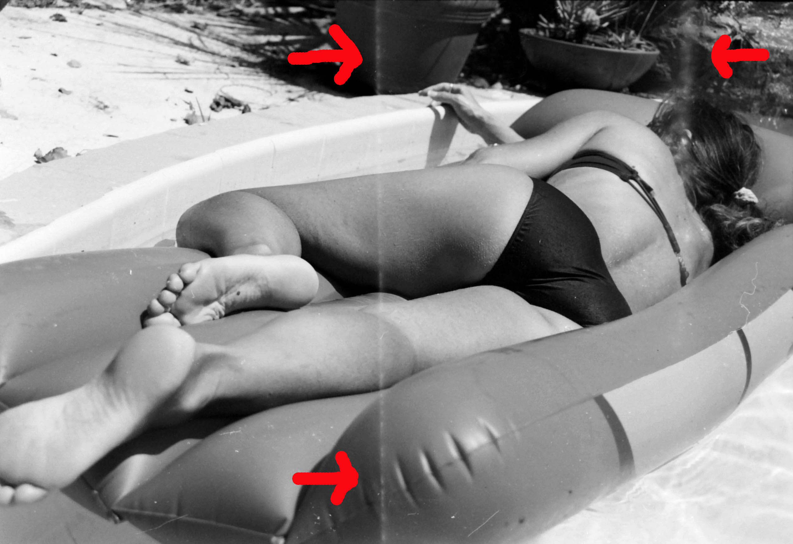

The last 3 rolls (maybe 4) that I've shot/developed have had a vertical line running through the last frame, and only the last frame. Film is Kodak SO-370 Traffic Flow Recording Film, shot at 64 ASA/EI.
The first roll I shot of this did not have the vertical line, and was ran through a Canon 630. The second roll, was through a Rollei 35, and did not have the line either. The last 3-4 rolls have been shot through a Nikon F4s, and all have had the vertical line. This of course leads me to think it's the camera, but wouldn't there be a line on all the frames then?
The line is not consistently in the same location, but has been only on the last frame, and on the left side of the frame, anywhere from just to the left of center, all the way to just about the left most edge of the frame.
One thing I've noticed with the Nikon, is I get 38 exposures out of the roll of 36, and the last frame is <1/2" from the spool edge when I cut it from the spool, whereas with the other bodies there was more 'room' at the end of the roll. The trailing edge of the film on the spool is secured with masking tape, and upon examining the old spools, there is a bit of a 'ledge' or bump in the tape where it overlaps itself.
Any ideas of what the cause of the line is, whether it be body or film?
Here is a sample of the line -

Q #1 - Yes, it's on the film
Q #2 - No. I initially thought that was the problem, but because it's the last frame to go on the reel, there is nothing touching it, or after it on the reel.
I'm really thinking it has something to do with the little 'ledge' of masking tape on the spool. While I can't say for sure that the ledge lines up with the line, it seems to me to be the most likely. The film has been resting on that ledge since 1977/78, and I could guess that something is happening because of it.
I can't understand how it could be the camera if it's only on the last frame.

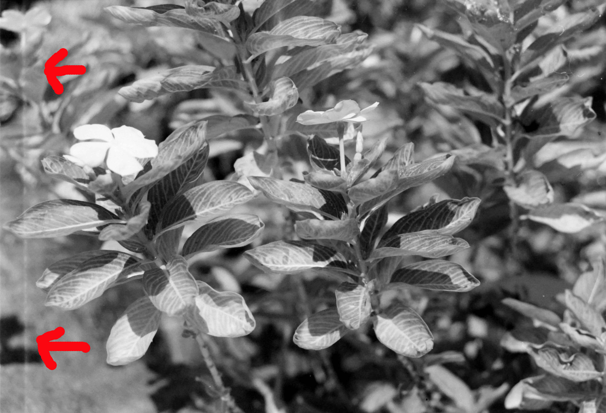

Here's another 2 examples from other rolls. See how the line location varies?
I have figured it out.
It does have something to do with the masking tape. On the negatives of the last two images, I can see a faint black line that goes outside of the frame, into the rebate. The line is only showing on the "bottom" rebate (on these two). On the negative of the wife in the pool, the dark line goes down to just into the rebate, then takes a 90° turn to the right, across the sprocket holes and then off the negative.
I guess that 35+ year old masking tape adhesive has a detrimental effect on film.
