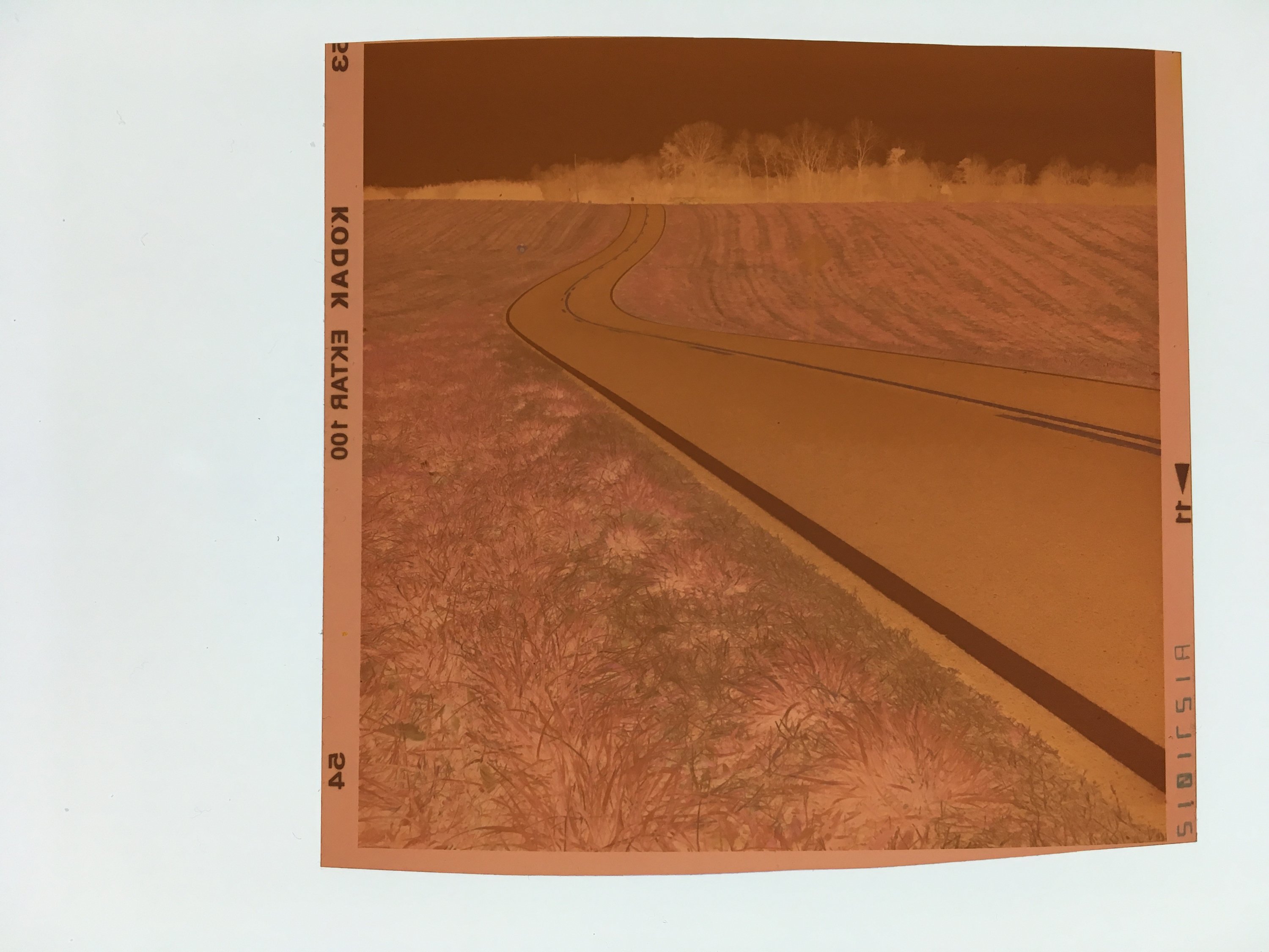

Here is a frame from my grain test. There is grain in the road and sky in the scan - but looking at the scanned image now, maybe it is noise and not grain.

Thanks for showing us the actual negative!
The exposure looks good, as does the developing - at least to the naked eye.
When I copy the image over to my photo editing programs, enlarge it and enhance the contrast, I don't see much sign of grain.

Yes,the negative looks fine, and if your blix was mixed just before processing it should be OK. Indeed, the separate components should have a shelf life of quite a few years.

Nice image.
Lots of grain in the sky, as you mentioned. It looks like the blue channel is clipped, not unusual in my experience. This is upon examination in Ps with ColorPerfect plugin.
What scanner software are you using? I use Epson Scan. Turn off all checkboxes, and pull the exposure sliders to 0 and 255 for all channels, and change gamma to 1.0. Scan at maximum resolution. Then see what you come up with. The goal is to remove the scanning software as much as possible from the process. Some people refer to it as a "raw" scan.

Others can probably explain it better. Have a look at the histograms in the scanning or post processing software. Blue is the only channel that piles up on the vertical axis. Furthermore, look at the white stripes on the road, and the sky on the right edge of the frame. There is a lot of yellow there, which means there is not enough blue. Try adjusting blue to achieve a neutral road stripe, or to achieve a non-yellow sky. With mild, global adjustments, it is difficult to do. The image posted in this thread seems downsampled, so that is having an effect on what I am seeing. Have you looked at the negative with a loupe?

Oh ok, I think I understand. You are saying the blue is blown out on the film? It is just photographed with an iPhone on a light table, so the iPhone may have altered the colors in the negative (the colors kept shifting on the iphone screen when I tried to shoot it)... but probably not. It was a very grayish-blue day and there was strong reflection of the overcast sky on the wet road. I suppose a warming filter might be in order, but I wasn't trying to hide the drear.

The negative looks fine. Deeply analyzing the histogram of an iPhone capture doesn't make sense. Going by the density of the edge data compared to the sky, the sky is exposed and developed nicely and should most likely print just fine on RA4, and if it does that, it can also be scanned alright.
If you're using an Epson scanner, try making a prescan and adjust the curve sliders so that they just contain the entire histogram of the image and then do the final scan. This way you ensure that you capture all color information in the final scan.
