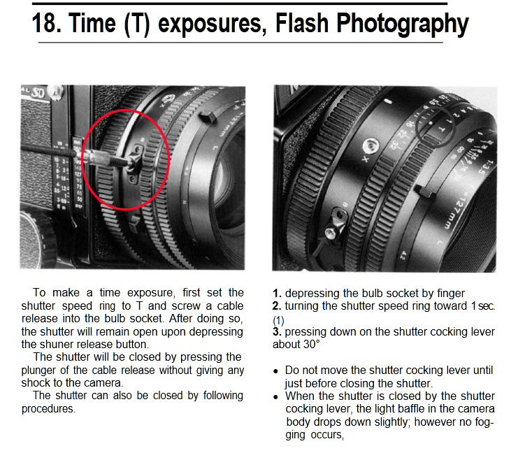

Also trying to connect a standard shutter release to the T spot on the lens for time exposure .. this appears to be a very small release and I can find nothing on the web. Short of that I will resort to turning the lens shutter back from T towards 1 sec and place a black card over the lens as I do it.
And another lesson... the RB67 manual suggests (at least that is what I read) to connect a shutter release to the lens when doing time exposure... but taking my lens into the only remaining old fashioned camera shop and the young bloke was very polite telling me it is a flash connection :smile:

Uh, actually no.
The connection with the red circle around it in the illustration is where you connect a cable release when you want to do time exposures. You start the time exposure by pushing the shutter release on the body. You end the time exposure by pushing the cable release again or by choosing the options listed in the manual. Essentially, the screwed in cable release stops the opened shutter from closing until the listed steps are taken.
It is the terminal nearby marked X which is the flash connection.
On the other side of the lens is another place you can screw a cable release into. That is the one that the double cable release is optimized for. It is used for mirror lock up photography.

Hello Matt.. and thanks again. Now I am really confused. The screw thread is very small and my standard or double shutter release cable does not fit into that connection.
I am familiar with the connection on the left side of the lens to work with the mirror up etc... is it a special cable that screws into the red circle area.. I can find no reference on the web.
MattKing
Apr 24, 2005
55,127
Delta, BC Canada
It should fit a normal cable release. It and the mirror lock up connector are threaded the same way, and fit the same cable release.
I checked this on the one K/L version lens I own, and it works this way with my standard cable release.
For clarity, I want to confirm we are talking about the same connector. It is the one with the small "B" beside it, not the flash synch connector with the X beside it.
EDIT: one further thought. Is there any chance you have an older, C series lens attached? They don't have a separate "B" connection for time exposures - just the flash synch X and the mirror lock up connection.

EDIT: one further thought. Is there any chance you have an older, C series lens attached? They don't have a separate "B" connection for time exposures - just the flash synch X and the mirror lock up connection.[/QUOTE]
Hello Matt... that's it... I must have the older C Series lens... it is a flash connector next to the "x". Mirror lock up on other side is OK. So when taking T exposures I need to open shutter, time the place a card or hat or whatever in front of lens the move the shutter from T towards 1 sec to close shutter. Thank you very much for the clarification and taking the time to assist me.
