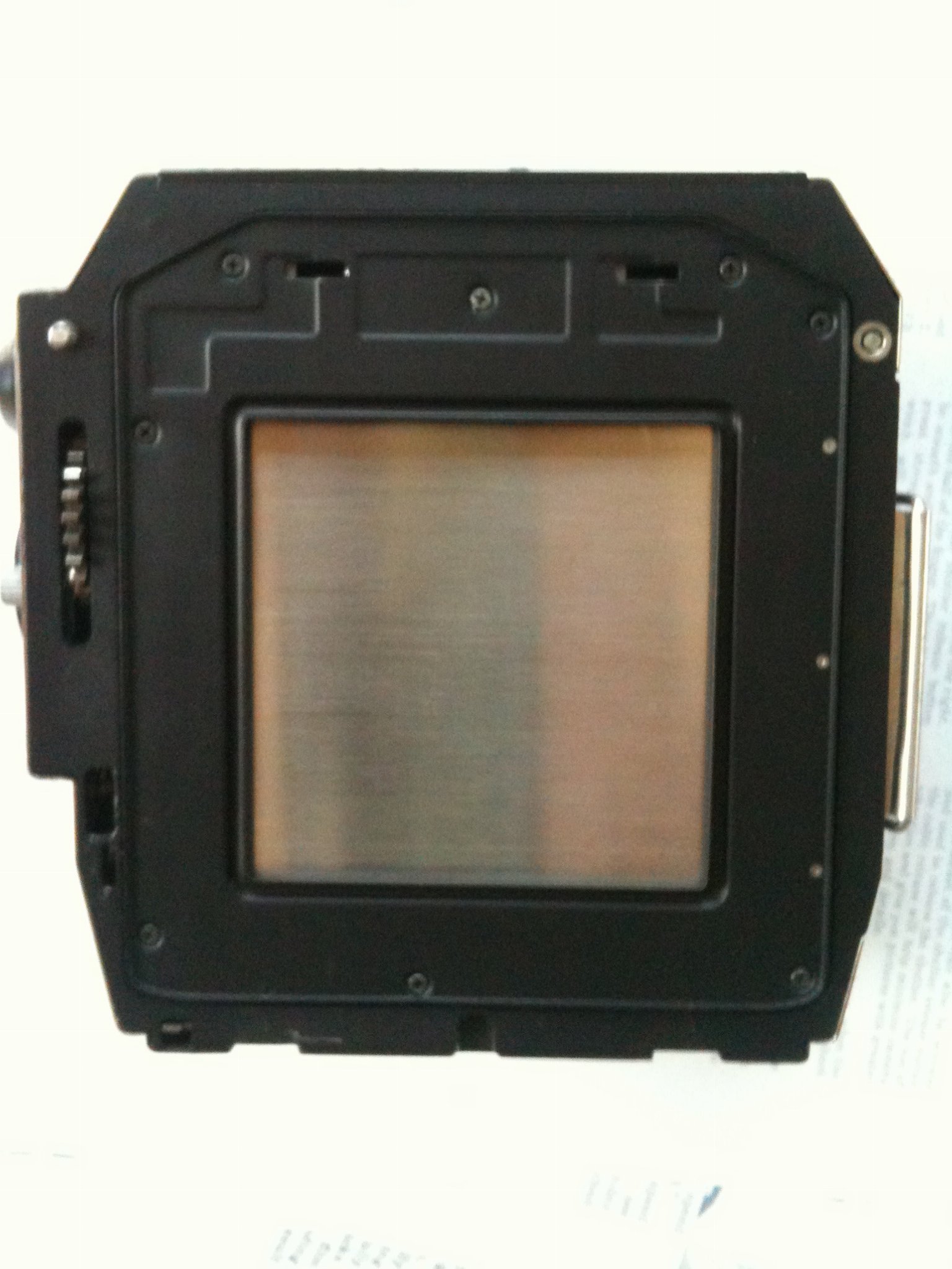

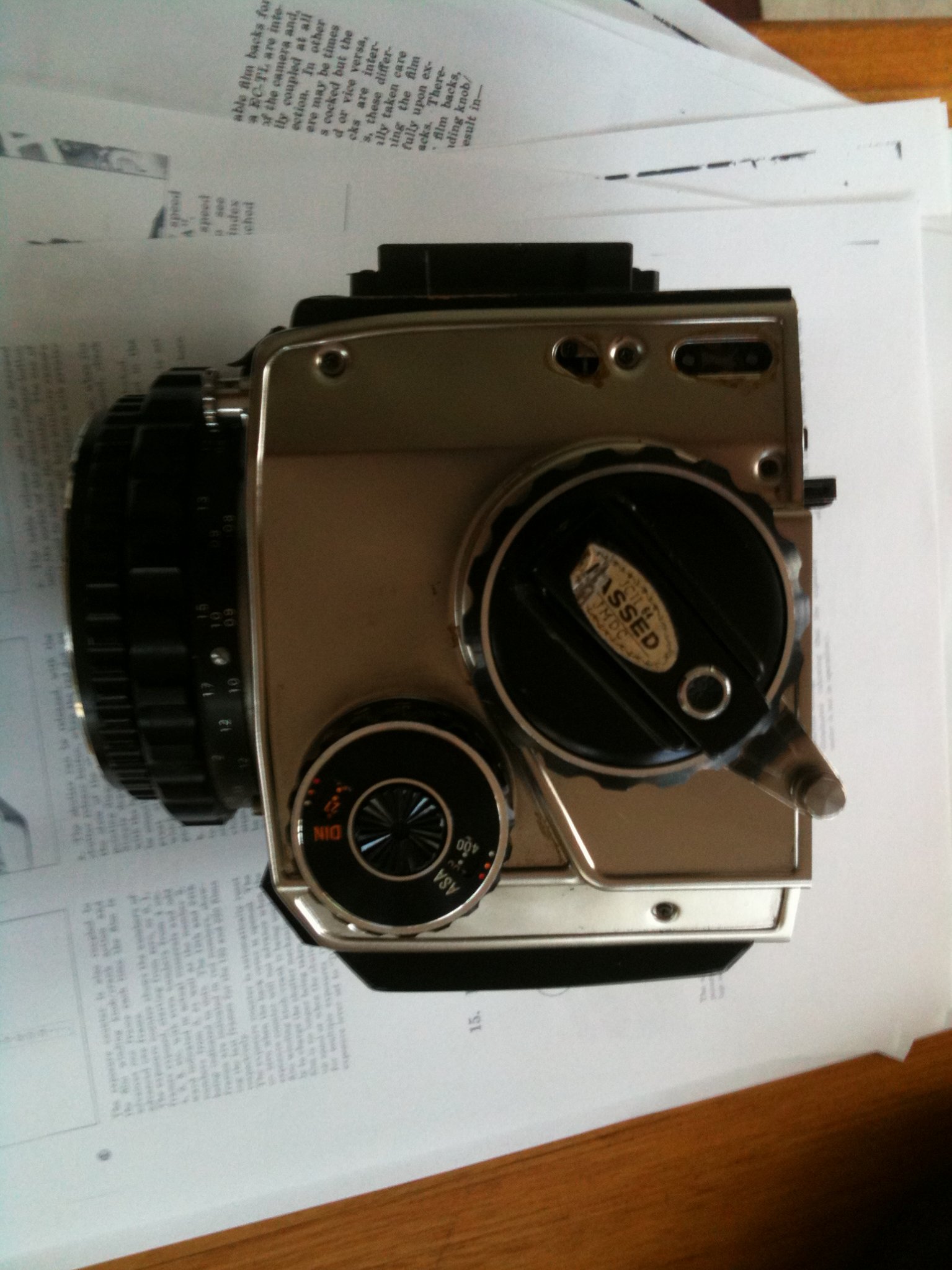

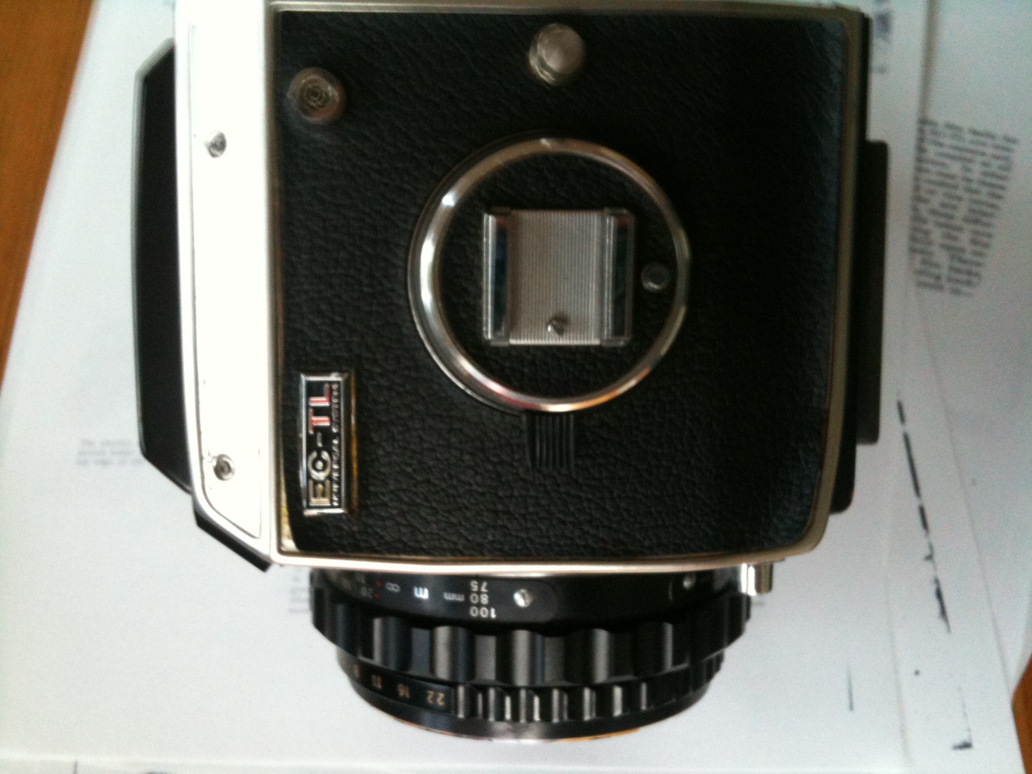

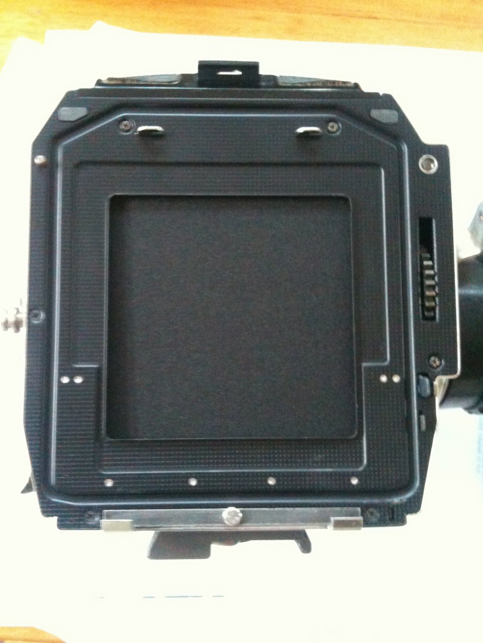

Here are images of my EC-TL.
Camera Back back (film back off)
Film Back
Camera R. Side
Camera L. Side
I cant find the dots you mention - can you point them out?
Thanks!

I don't think you'll find any of the dots mentioned on your lens. Those instructions apply to the more modern SQ series of cameras with leaf shutters. The EC series of Bronicas use focal plane shutters and, if they are like the the "S" series Bronicas of which they are a derivative, then the mirror should return to the taking position after each exposure. It's been a number of years since I last used one of the older type of Bronicas, but I'm sure if you do an internet search something will turn up.
