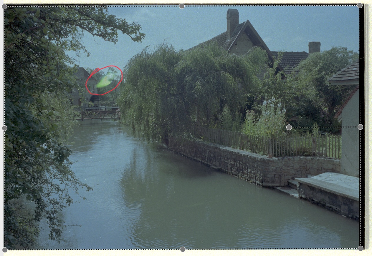

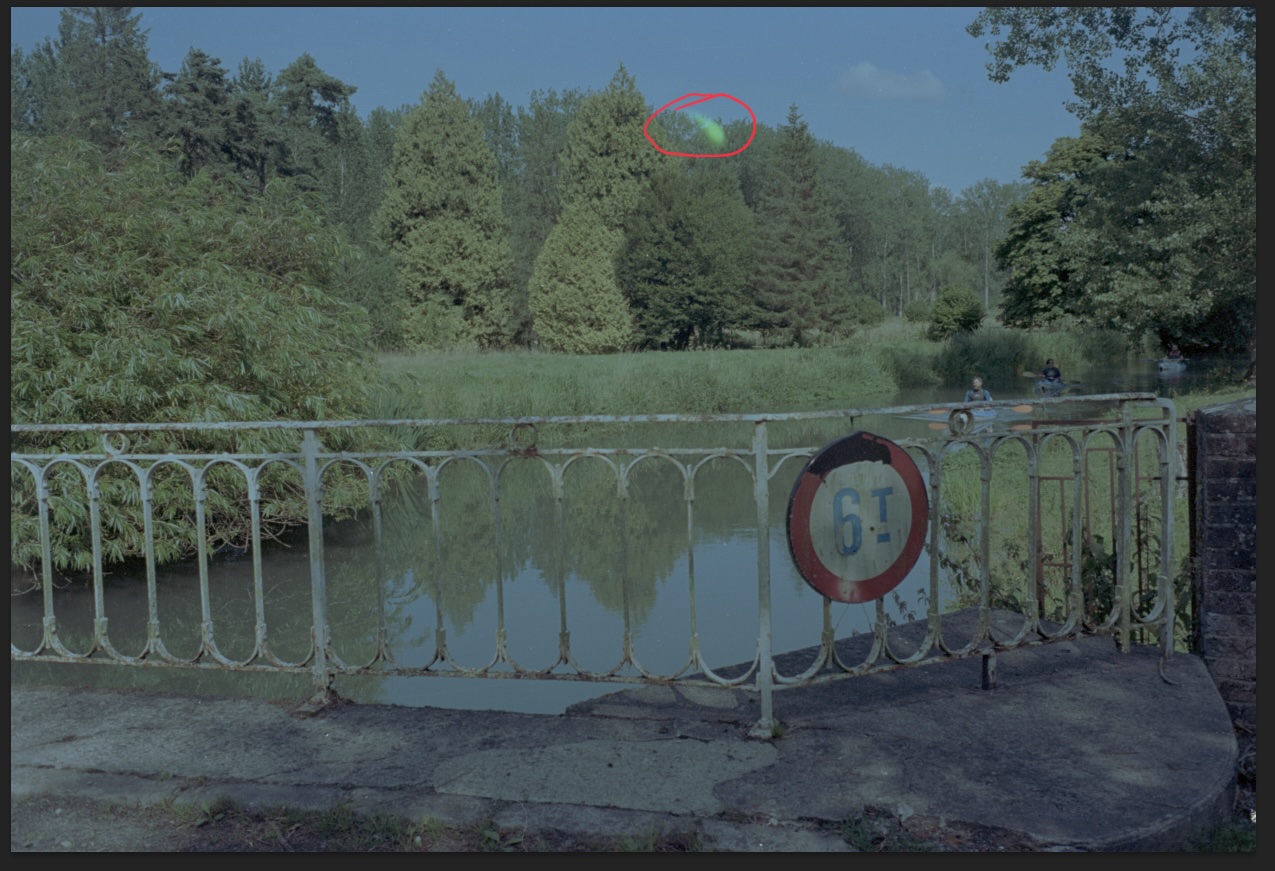

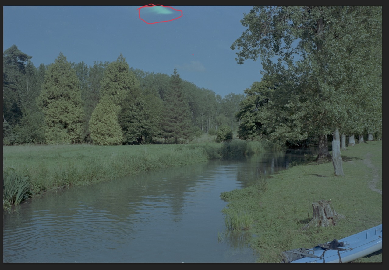

Some of my pictures have this very strange artifact:
So the question for me is what have I done wrong during the C41 process?

Maybe the film wasn't spooled onto the spools perfectly?
Looks like some kind of contamination. Just check it is fully bleach-fixed.
If that was the case, and the film was touching on the spiral, you would get the exact opposite.

If it's the bleach/fix there could be silver left in the emulsion, on drying and scanning this will darken. Try re-bleaching, increase the time, then re-fix.

So, I just tried, I double the times recommended by Bellini and nothing changed...
Could it be bubbles during the development time?

It could be a light leak.

No it is not air bubbles, as I said initially it looks like some kind of contamination. As Matt says it could be a light leak, or possible stray light from an LED in the darkroom.

For the light leak, I doubt it. I don't have a light room and I use a charging bag. And do that in a room with very low light.
And not from the camera as I have processed another film I shoot with it (film was shot after the one with issues)
So probably a contamination indeed...
I will process anothe roll later and see what is going on...

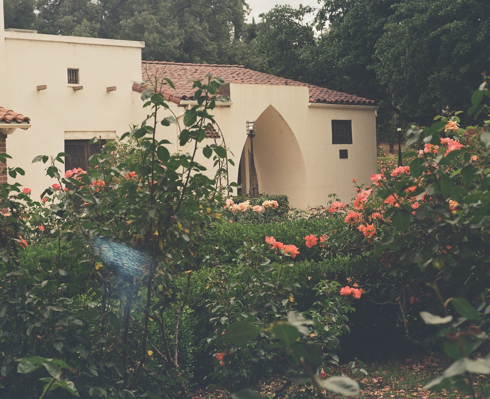

I, too, have been seeing some similar artifacts lately with 120 Kodak Gold 200 and commercial processing. It's not regular but seems to be 1 frame per roll. And it too often seems to be the "best frame". Light leaks have been discounted and I'm in the process of eliminating weird glare from a spot on my lens hood where the black wore down to bare metal... which I think is a long shot but I'm out of guesses.
