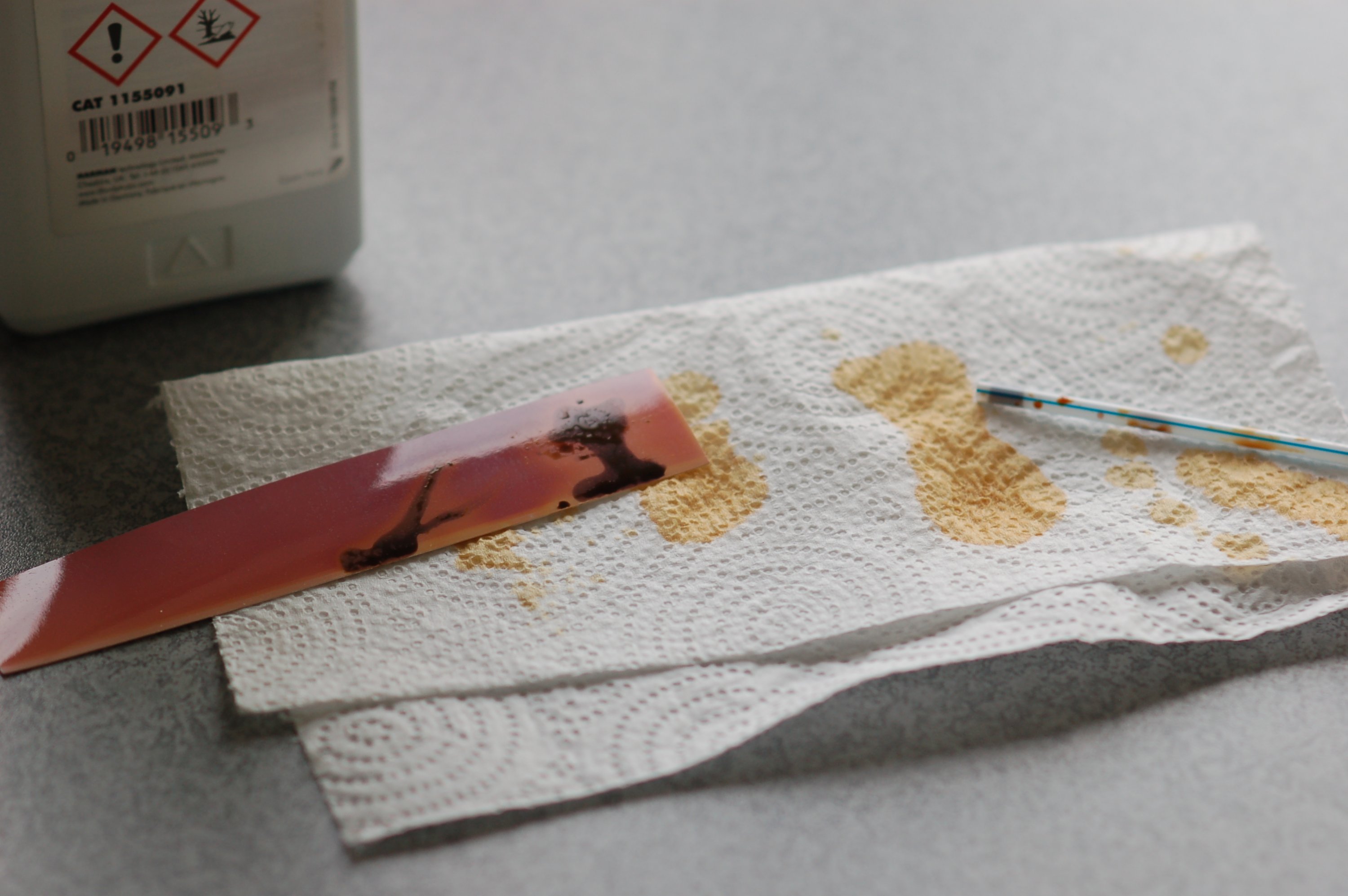

Attached is an image of applying concentrated [albeit old] Ilford PQ Universal developer on a scrap of 5x7 Ilford Cooltone paper.
The colour of the developer can be seen from the kitchen towel, but the developer "seems" to be still active based on the tar-like blobs on the paper.

Now try the same test with another scrap of the RC Cooltone and a sodium carbonate or sodium hydroxide solution -- to see if the blackening is slower or about the same. Most Ilford papers are DI (developer incorporated) and will develop and image after exposure in a plain lye solution, probably even in a sodium carbonate solution -- just due to activating the developing agent incorporated into the emulsion.
If the reaction is about the same in a solution of sodium carbonate (likely similar pH to the developer you're using) then the developer is probably bad (try a clip test on film to confirm; film doesn't have DI).
