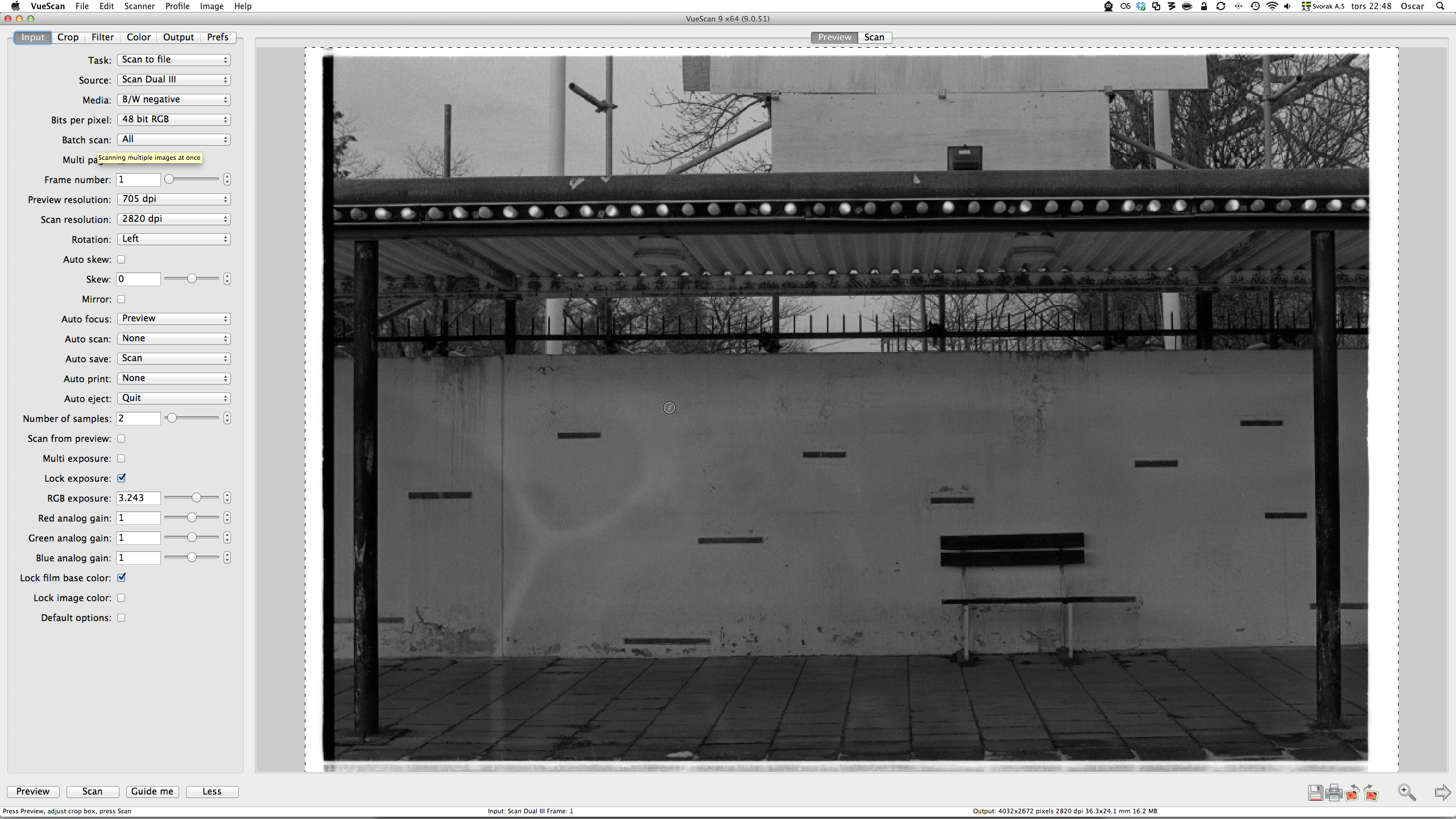

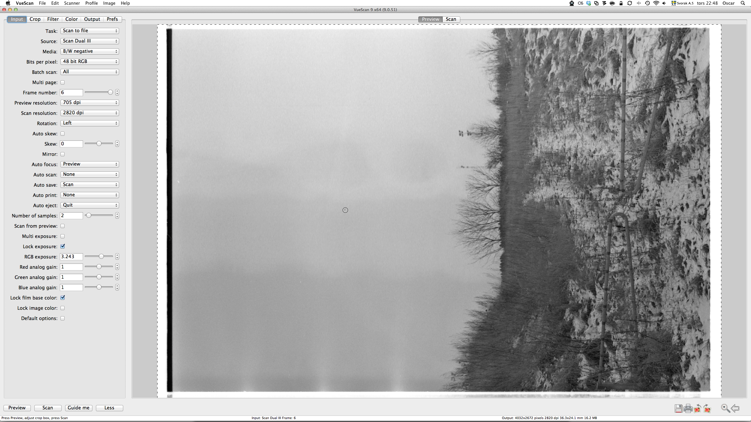

See the attached images. The film is Foma 100, developed in R09 in Paterson tanks (plastic reels), according to my standard procedure (2 minute pre-soak, 30 s initial agitation, then 2 flips, rotation, and 2 more flips each minute).
Any ideas? I used a bit more chemistry than actually necessary (300 ml instead of 290 ml, iirc) but I think it was in the larger tank (that takes two 120 spools) so maybe the film wasn't all the way down on the bottom all the time? Or what is it that has happened here? :/
I developed a roll of TMAX400 using the same chemistry a few minutes prior to this Foma 100 roll, I haven't had any issues with doing so earlier.
Forget the pre-soak.
Is there any chance that your fix was exhausted?
Are there any signs that the film hasn't totally cleared?
Did you put an empty reel on top of the one with the film to keep it at the bottom of the tank? Using a larger volume of chemistry wouldn't hurt things at all.
Keep the prewet!
Looks like uneven development due to low agitation. There is a hint of bromide drag in the left photo. Films react differently to the initial wetting and the continued re-wetting with each solution. The initial agitation must be strong enough to fully wet the film and the pouring process where the prewet or developer enters the tank must be rapid and even.
PE
Looks like uneven development to me. Initial agitation is crucial, so make sure to agitate well for at least the first thirty seconds (after pouring the chemistry into the tank).
unless you are doing some sort of nutty development method like semi stand, or stand &c
or continuous agitation in tubes or rolling around your darkroom sink ...
manufacturers usually recommend agitation for the first full minute, and either 5 sec's / 30 or 10 sec /60
agitation should be solid and consistent ... i was always taught like a figure - 8 and at the same time turn
the hand tank over ... again and again for the 5 or 10 seconds ...
agitation for fix is the same routine as it is for developer ... and stop bath + fix remove are continuous agitation ...
nice views ( less the streaks ) good luck getting the kinks out! ( and belated welcome to apug ! )
john
Regardless of what other says, most of the world stopped using pre-wetting in the 1930-ies because of problems with uneven development.
Besides that, modern film doesn't need pre-wetting in anyway.
In addition to this you may have to little agitation. Rodinal and R09 contans a development agent that is very sensible to bromide, so insuficcient agitation will give you bromide drag.
As mentioned earlier, agitation with inversion of the tank works best.
Maybe! :wink: You can see that it moved up. Probably a centimeter each time you agitated. Try putting an empty reel in there to hold the lower one down.

I can't tell a difference between pre-soak and no pre-soak.
Rodinal and bromide drag... With 120 film I can safely extend my agitation intervals to every three minutes, and with 35mm every five minutes. I do this to control the tone curve of my negatives. No problems there either. Longer than that, you're on your own, but many people make standing development work just fine without bromide drag (although problems do get reported).
What I DO notice, however, is that if I don't agitate properly, insuring sufficient flow within the tank, I get uneven development. AND, that initial agitation is so utterly important. I always agitate continuously for the whole first minute, using full tank inversion while rotating the tank along its long axis. Getting agitation technique properly under control is, to me, the most important aspect of film developing.
That's a really good point! If the film spool moved up the column, and gradually out of the developer, that would certainly be detrimental. Yup, always fill the tank up with as many reels as it will hold, whether there's film in them or not.

A prewet allows film to imbibe developer more evenly and it helps reduce pinholes caused by air bubbles.
In the OP, one of the pictures shows an indication of bromide drag along the edges. You can see streaks upward from the bottom in a regular pattern that is typical of bromide drag. The other frame shows a streak that looks like uneven wetting of the film with developer.

With Ilford delta films (I don't know about Foma), I often see a fair amount of what looks like foam when I pour out the developer if I don't presoak. So, for that reason alone, I use a presoak every time with 120 film. (No chance of photoflo contamination, separate containers and off the reel by then). But your images have a bubble like quality to my eyes, is it possible you have photoflo from the last film on the reels or tank before developing the new rolls? Do you see any foam when pouring out the developer?
If not, I would still keep the presoak, go for at least a minute after pouring in developer, then agitate for at least 15 seconds each time, to ensure complete exchange over all the film. I also have measured the amount of liquid necessary to cover both reels, and use just 20cc more than that, just to ensure room in the tank for the chems to move.
Also, as Thomas indicates, you can go for 2 - 3 minutes between agitation cycles with 120 film, as long as the cycle itself is long enough to get good movement. It may take awhile to find the right cycle combination for the right contrast.

I am not aware of pre-wetting being a "known cause of problems". I didn't presoak for quite a long time, now I do, but I've had no problems with uneven development either with or without presoaking.
Both methods work.
Most uneveness problems I've seen are due to agitation or insufficient amounts of developer in the tank.
+1!!!
Oscar:
Your agitation doesn't seem vigorous enough to distribute the chemistry. Also, did you reuse the same developer, or are you using a one-shot developer? If you reused the same developer in that small amount, then it could have become exhausted by the third roll.
I used to develop (dearly departed and hallowed) Techpan following the Kodak directions. Get the film on the reel, and then drop it into the developer and give it a vigorous up-and-down shake, like mixing a martini. Never had a problem.
As for pre-rinse, use what works. The Ilford instructions say no, Kodak says yes for tray processing. Test it and find out for yourself.

Whoa, my initial question seems to have spawned quite a discussion.
Anyways, I started pre-soaking my films quite recently as I didn't like the magenta cast in TMAX negatives, and the pre-soak seems to take care of it. Also I like the thought of beginning with a perfect temperature, both for the film and the developer (and since Tetenal C41 recommends using pre-soak to get an even temperature I thought what the heck...). Maybe I'll stop using pre-soak once I've tried a more vigorous agitation scheme, but I'm trying to change only one variable at the time.
However, it seems to be more important to use a bit more developer and also using additional spirals to make sure that the film is all the way down on the bottom. And perhaps use a more vigorous agitation scheme.
