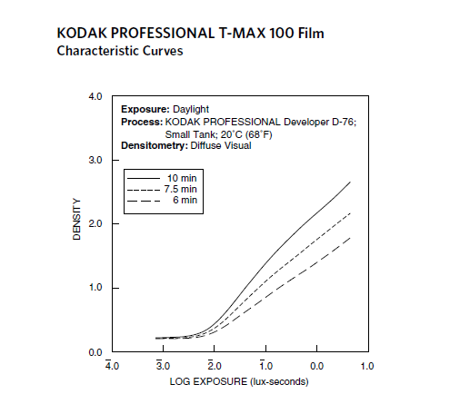

I like charts, sometimes they show what is going on better than words can.
The meaning of "overdevelop" is usually taken to mean an increase in development time.
This chart shows what happens to the contrast of a film when time is increased. Note that at the left hand (lower end) of the curve not much changes (this is also known as the "toe" of a film curve) however at the right hand side there are big changes. The left hand end are where shadows are recorded, the right hand end is where highlights are recorded. An increase in development time causes a significant increase in highlight density (which makes the highlights in the print brighter) this is what is meant by a change of contrast, the difference between shadow density and highlight density, more development causes increased contrast.

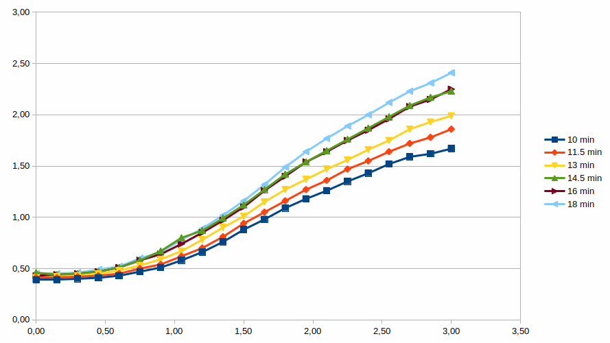

Here is series of charts from a recent test I made. Test was done with Promicrol 1+14 on Tri-X contact printed through T2115 Stouffer wedge. The two test rows were done with different exposures, therefore please make no attempts to overlay these graphs.
Graph 1 is an H&D plot, i.e. transmission density over exposure for different developer times, all times somewhere around the Massive Dev Chart time of 13 minutes. There is this odd thing, that the 14.5 minutes plot strangely overlaps the 16 minute plot, which should tell how accurate or reproducible these test are (i.e. they aren't). They still show a standard tendency: as development time goes up,
  1. contrast goes up
  2. fog goes up
  3. threshold speed doesn't change much

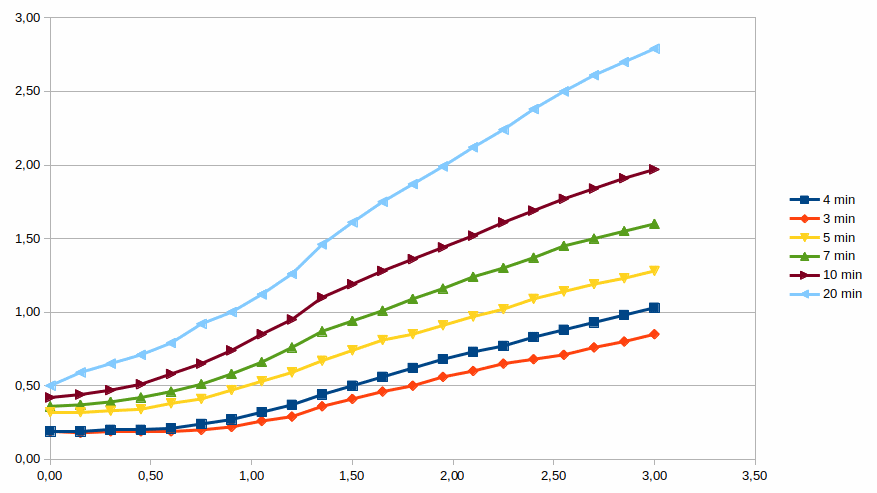

The second chart shows H&D graphs for developer times which deviate more from the Massive Dev Chart time of 13 minutes. What becomes obvious now is the extended toe region we get when we underdevelop film. Contrast is visibly reduced, and useful image contrast requires one more more extra stops of light.
Once you get close to the recommended dev time of 13 minutes, threshold speed doesn't change much any more. Extra development gives additional contrast in the toe region, which could in some cases create useful shadow detail where normal development wouldn't.
