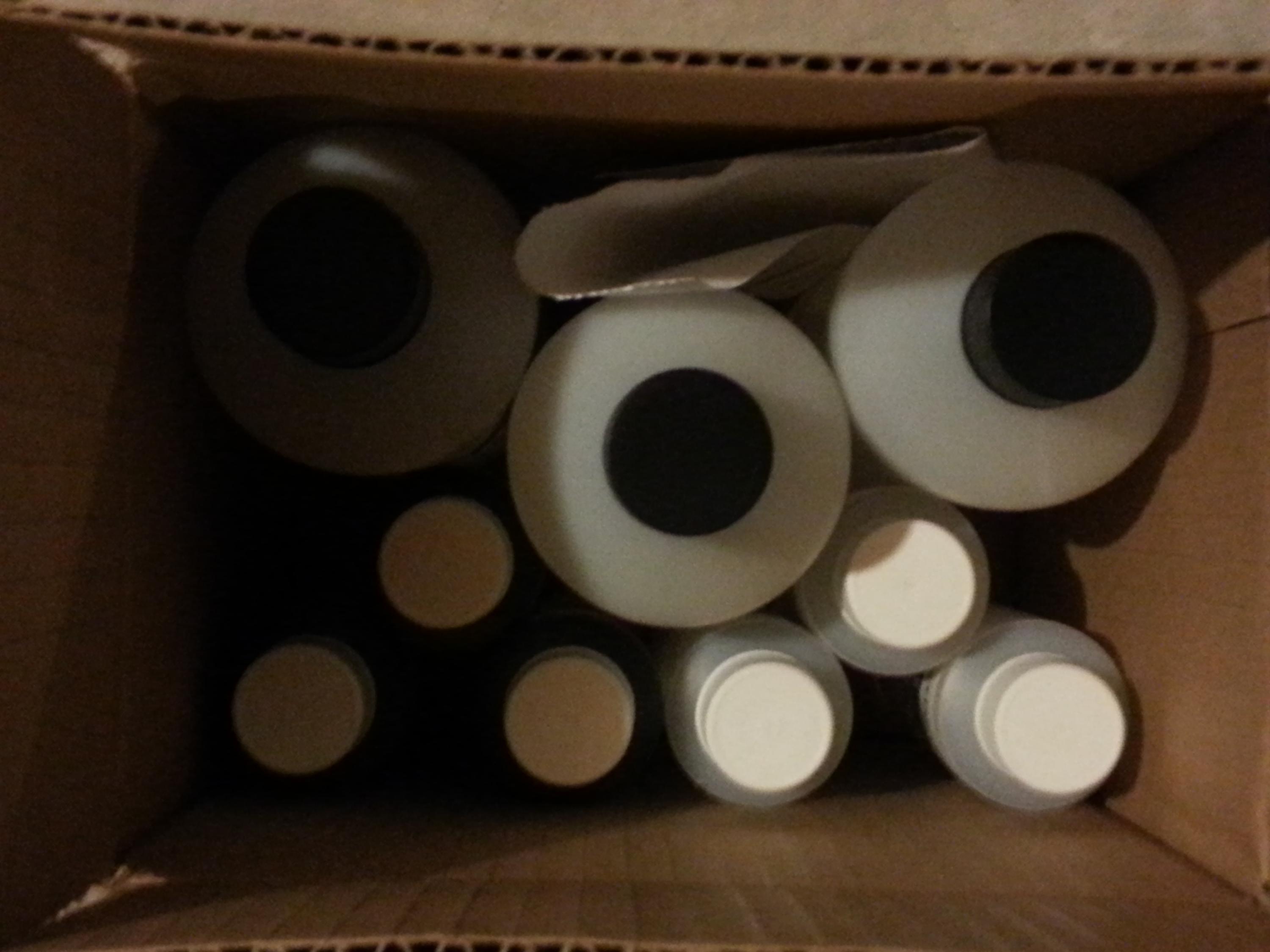

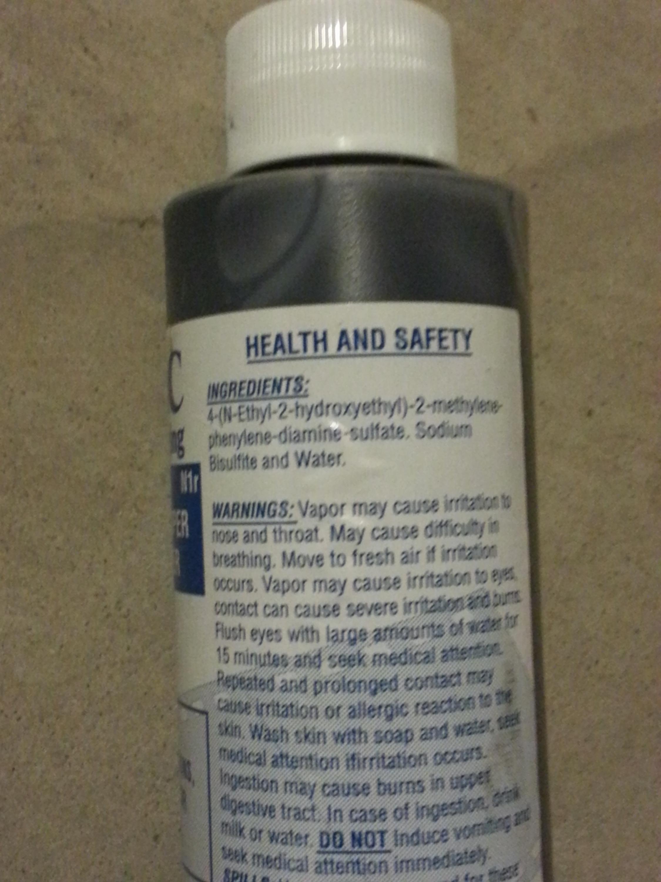

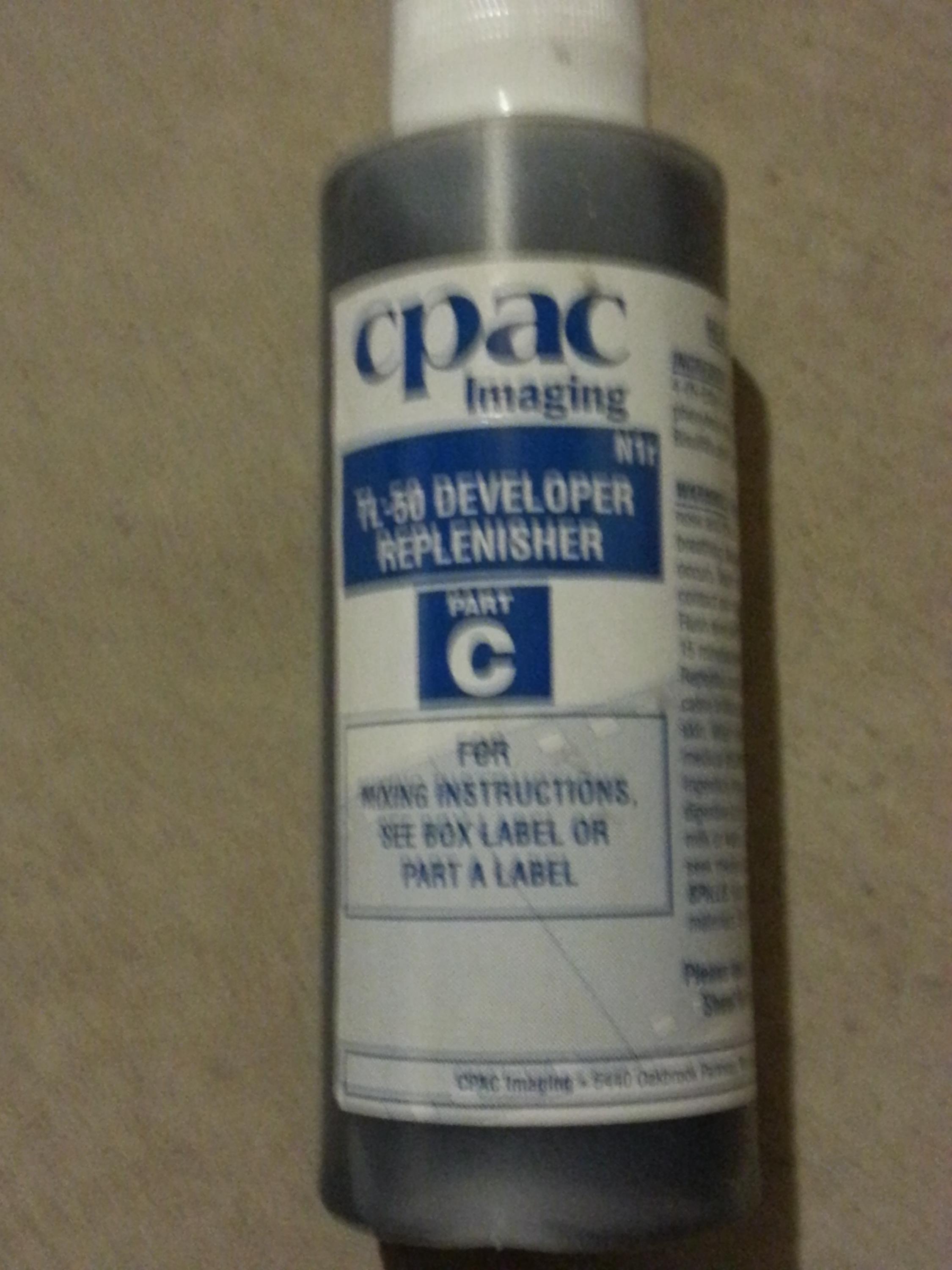

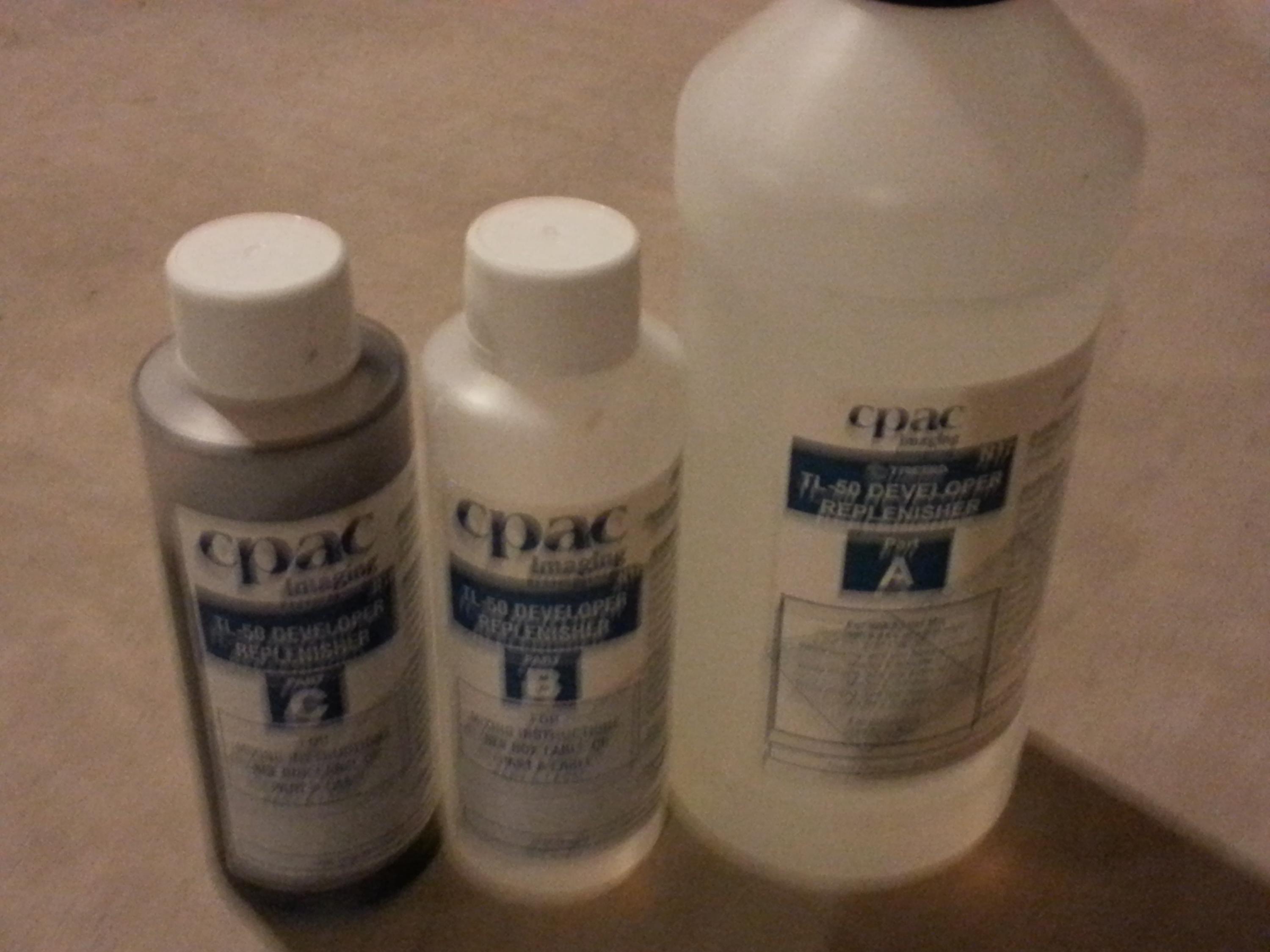

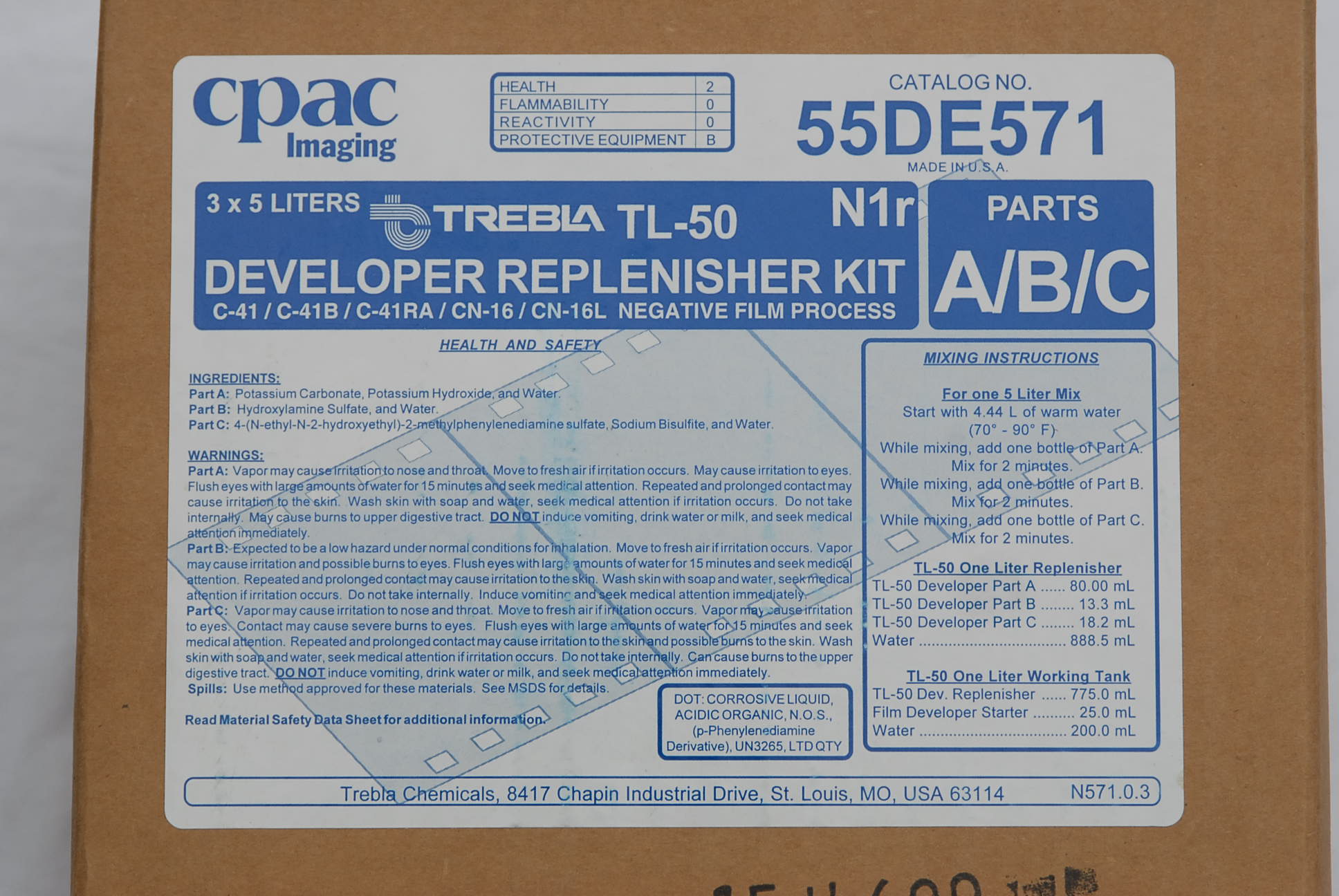

Here is what I have. Developer kit, box of 3 sets, with each set to make 5 liters C-41 developer. The part C is dark. Sry for the bad cellphoe photos.
20140428_200117.jpg 20140428_200137.jpg 20140428_200301.jpg 20140428_200902.jpg 20140428_200929.jpg

This is a good photo.

However, Trebla is a reputable company and their chemistry is high quality. OTOH, that stuff looks bad.

Today I opened a sealed bottle of the part C. This stuff is black. And it won't dissolve in 120F warm water. The content is flaky, float around, pretty much like the loose ground coffee in your coffee.
The fixer and bleach look just fine....
