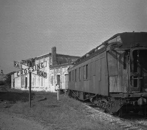

The whole reason behind my asking this is my determination to get a good negative with Rodinal stand development. Everyone else seems to be able to do it without problems. So I'm trying to eliminate and find the source of my problems. It could even be my scanner as I have not yet printed the negatives yet. I read a post (below is a link) about developing for scanning after I started the post about the anti-halation...I'm seeing a lot of this type of banding and thought it might be from the pre-soak. Now I know it isn't so I need to narrow it down. When I scan the negatives they look grainy with that banding. So maybe its a) the scanner, b) the water bath -incorrect agitation, c) developer agitation, d) me! doh! :surprised:
I used to get heavy purple stain until I did the longer presoak which I now don't need to worry about and this is going in freaking circles! The banding goes away depending on what dpi I scan at. It's an Epson 1200 Perfection - yeah - old, but it's paid for. hmmmmm....... so...
Donald Qualls states ... "...This depends very much on the scanner, but most if not all will eventually reach a point where you see excessive grain and even banding in the scan, even though the negatives in question still print well...."
I hope these aren't too big, but they show the difference.
Thanks for your patience!
Dorothy

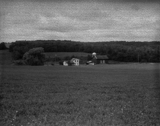

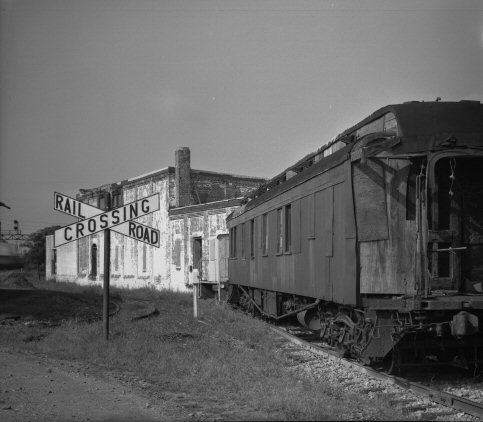

here's another example...the images aren't that great, but they demonstrate what it is I'm having difficulties with.

Looks like scanner artifacts to me. Not that I am an expert, but I'll bet you sixpence that the bands are running in the same direction as the travel of the scanner head. Print them in the darkroom and I'll bet they are fine.
Cheers, Bob.

I hope you're right. Boy! What an ordeal! But I did learn something.
Thanks
-Dorothy

I agree with Bob, that looks very much like scanner noise. I've seen some similar things in scans and I've never seen anything like that from uneven development. Now you know why high end film scanners cost so much! I had a friend who cursed the focus of a lens only to find out after much hassle that the film was buckling in the scanner at the lab. If you can print one with an enlarger that should settle the matter. I too would bet they are fine.
Best, Erik
