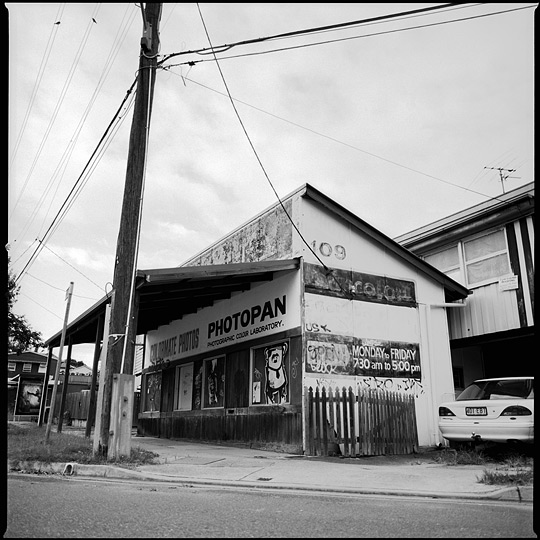

Ian David
Dec 19, 2006
1,132
QLD Australia
Here is my closest colour processing lab. Makes a good canvas for the local graffitists...
