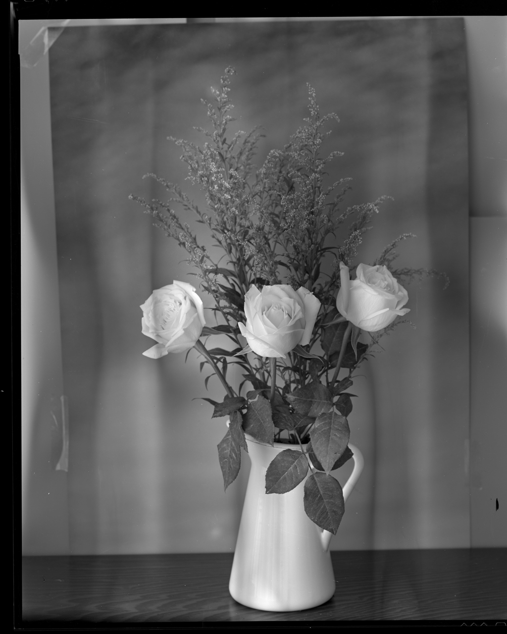

First of all forget about the background..........well no don't forget about the background, its the neg I want to talk about. With regards to the stupid background, that shit aint going to happen again, I WILL in future make sure that I have the correct size background to fill the frame.
You can see I have got these horrible vertical lines on the neg, initially I thought it was due to the defused window light coming through the net curtains, you know the ones I mean )see attached picture
And with the exposure being over 1 minute (1 min 17 seconds) to be precise I am thinking that that is the reason for these horrible lines is due to the curtains.
Then to my horror I thought about this some more and I am now thinking that it could possibly be coming from the developing process. I'm developing in trays in my dark room and the trays are the normal 8x10 trans from B&H that have channels in the bottom so that it is easy to get the neg out. I use 1 ltr of each of the chemicals so I think there is plenty of liquid in the tray, I also shake the trays to get some turbulent flow. Maybe the lines are due to the uneven developing of the neg (god forbid).............is that possible or am I just over thinking this shit??
I will be able to fix the background in PS, but not so sure I can do that in the darkroom (make burn in a vinaigrette)........theres one thing for sure I will try and do something with it in the dark room
Heres the Neg, and later I will post the finished print

A couple of questions:
Are you developing emulsion side up?
What sort of agitation pattern are you using - & how much agitation are you giving it?
Looks a lot like you may have placed the neg emulsion down & given it massively insufficient agitation in one direction only. A 9.5x12 tray is also a very good idea with 8x10.

When I think about it after I took the neg out of the holder yes it was emission down. 8x10 trays and constantly agitating buy creating waves buy lifting one end of the tray............this is the 10th 8x10 I have developed this way and never seen this before.........but I also have not consciously made sure the emulsion was up or down?

Emulsion up is good practice in general - the patterns on the bottom of the tray are not unknown to be a cause of uneven development. I tend to agitate the tray both up/ down & side to side - no specifics as to how much each way, but basically enough to ensure that the agitation is not only going in a single direction.

Cheers mate....I will make sure in future emulsion side is up

Another vote for emulsion-side-up. I had similar streaks when I tried emulsion-side-down (it had been touted as superior-NOT!). You don't say what size negative you are developing, but it's good to have a tray one size larger than the negative size.
For me, tray development is quick, easy and the most consistent method I've tried. Keep at it and you'll be fine.

Coming back to the OP's problem - I am sorry to say so but I can't remember such kind of sharp lines coming from
agitation failure with developer.
You can hit me from less experience I might have, but the more reason of having no developer problem is the constantly structure of this phenomenon.
It would be very hart to reproduce this -
even with absolute no agitation at all.
For me the reason is elswere - not the
developer. ......
What can be the failure the OP may have
done? Sorry I have no Idea:cry::cry::cry:.....
And now? Am I allowed to speculate a bit?
It is looking like a double exposure.
The first exposure is with your flower,
the second is only your background as
a picture with higher E.I. because it is
an underexposure.
Let me ask : Is this a test ndwgolf ??
Because you mentioned explicitly the
background and advised us not to care
about:happy:????

The marks match the shape of indentations on the bottom of a Paterson 8x10 tray.

I am using Kaiser trays. ..? But Lachian ?
I can only count 3 intentations on the bottom of 8x10 Paterson trays......
