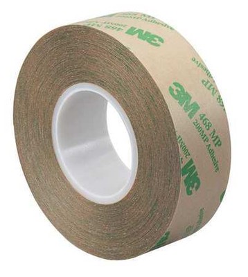

Is the rubber ring flexible enough to reverse? Put in position, then pull one end back to expose. Apply glue, roll back into position. Repeat for other side.
There are a few clear flexible adhesives that come to mind but names elude me. Dupont 621?? In the green box at hardware stores?
Another approach would be a double side tape. Get into position, roll back an end, apply tape, and repeat. Or tape the shole area, them put a non-stick material around the tape, slide the ring into place, then pull the anti-stick out. I've had good luck with these materials for holding up over time-

I had been thinking about tape, so I'll check those out. Thanks. I just keep thinking that I can't be the only one with this problem.
