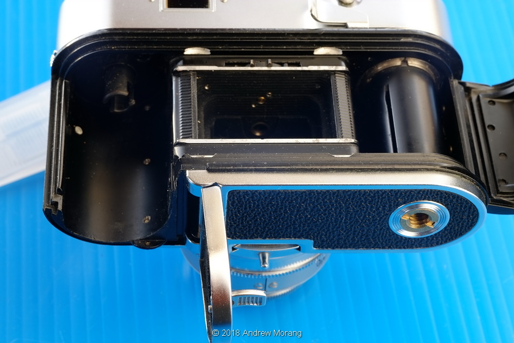

Here is another quirk: the Voigtländer solid body B series of cameras (B, BL, BR) from the mid-1950s used the film sprockets to cock the shutter. Above the film gate is a toothed gear, and as the film advances, it turns this wheel and cocks the shutter. At least until recently, these cameras were a decent price on the big auction site because many sellers thought the shutter was not operating. It is hard to turn the wheel by hand - my index finger can attest to that. By the way, this is a fun little camera, back to basics, with a great Color-Skopar lens.

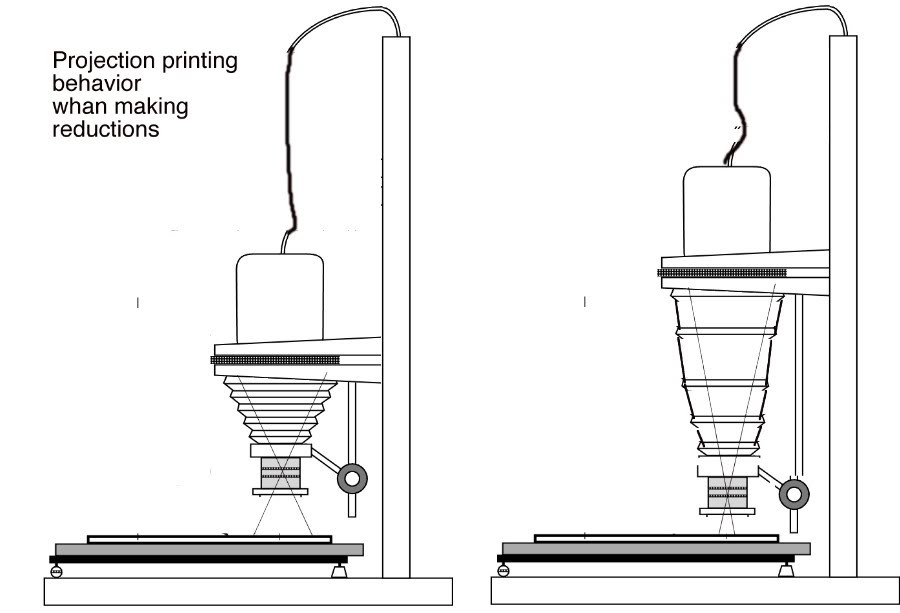

IC how about Durst quirks? There have to be a gozillion of those!!
This is not unique to Durst, but small format enlargers usually don't have enough bellows draw to experience this. When doing a reduction, if you raise the head the image gets SMALLER.
