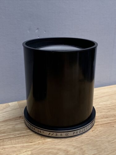

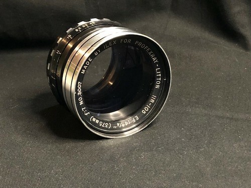

Worth a look;
I have the 14" f3.5 Wolly mounted up and a curtain shutter form an old 3X4 speed graphic out in front of it, but haven't had time for a "play" yet. Pretty spectacular on the ground glass though. I seem to like 14 and longer. Just finished restoring a 14 1/2" Verito and a 14 3/4" Eidoscop found it's way to me last fall also. 15" Cooke Series VI is beyond grand but you need to rob a bank first. So many lenses, so little time (or is it talent?) Don't "settle" for old slow graphic arts lenses. Artar's et al are fabulous for some things but lack soul with portraiture.
