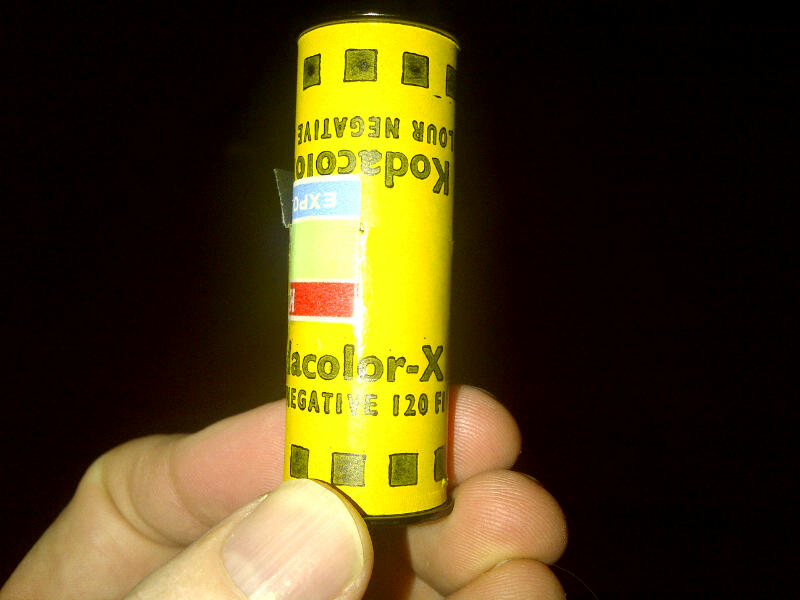

Hi everyone,
I picked up an old Yashica-Mat in Scotland last weekend and it had this roll of film in it. Does anyone know which process would be required?
OK, i have just read up that it used the C-22 process. My question then is, can it be cross processed or what are the alternatives?

It will have printed on the backing paper either the letters C41 or C22. The C41 is little problem. You will have to send it off to somewhere like Peak Imaging in Sheffield or do it yourself in normal C41 chemicals. The C22 process is long extinct in every day use, but I am sure that someone on the forum can suggest a place to send it to get it processed.
If it is C22 it will be at least 30 years old and it may not be worthwhile getting it done. You could always try developing it as a B&W film.
AgX
Apr 5, 2007
29,972
Germany
It is Kodacolor-X.
This film was the last of the Kodacolor-series to be processed in C-22.

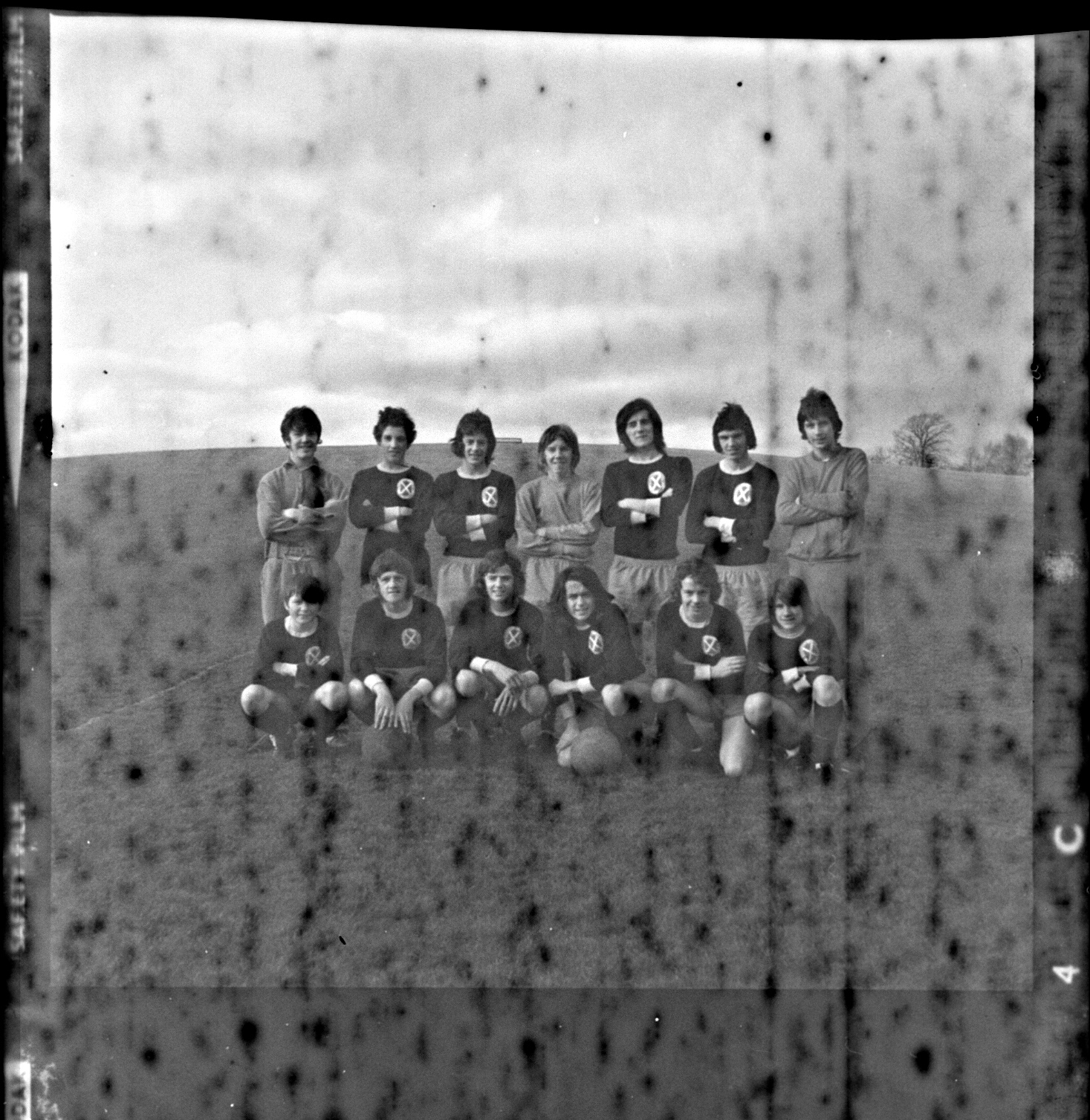

I developed the film this evening, 10 minutes in DD-X 1+4. The film is badly damaged but a few frames have some detail on them. I can see the shots were of a sports team, most likely a football team (British), from Scotland. I look forward to scanning them and trying to salvage some details.
It was fun anyway.

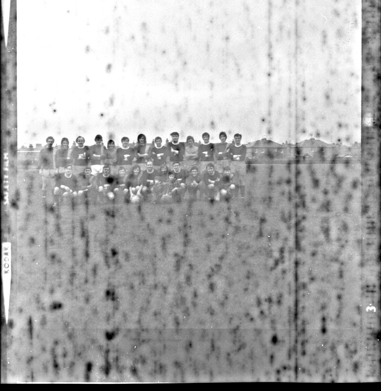

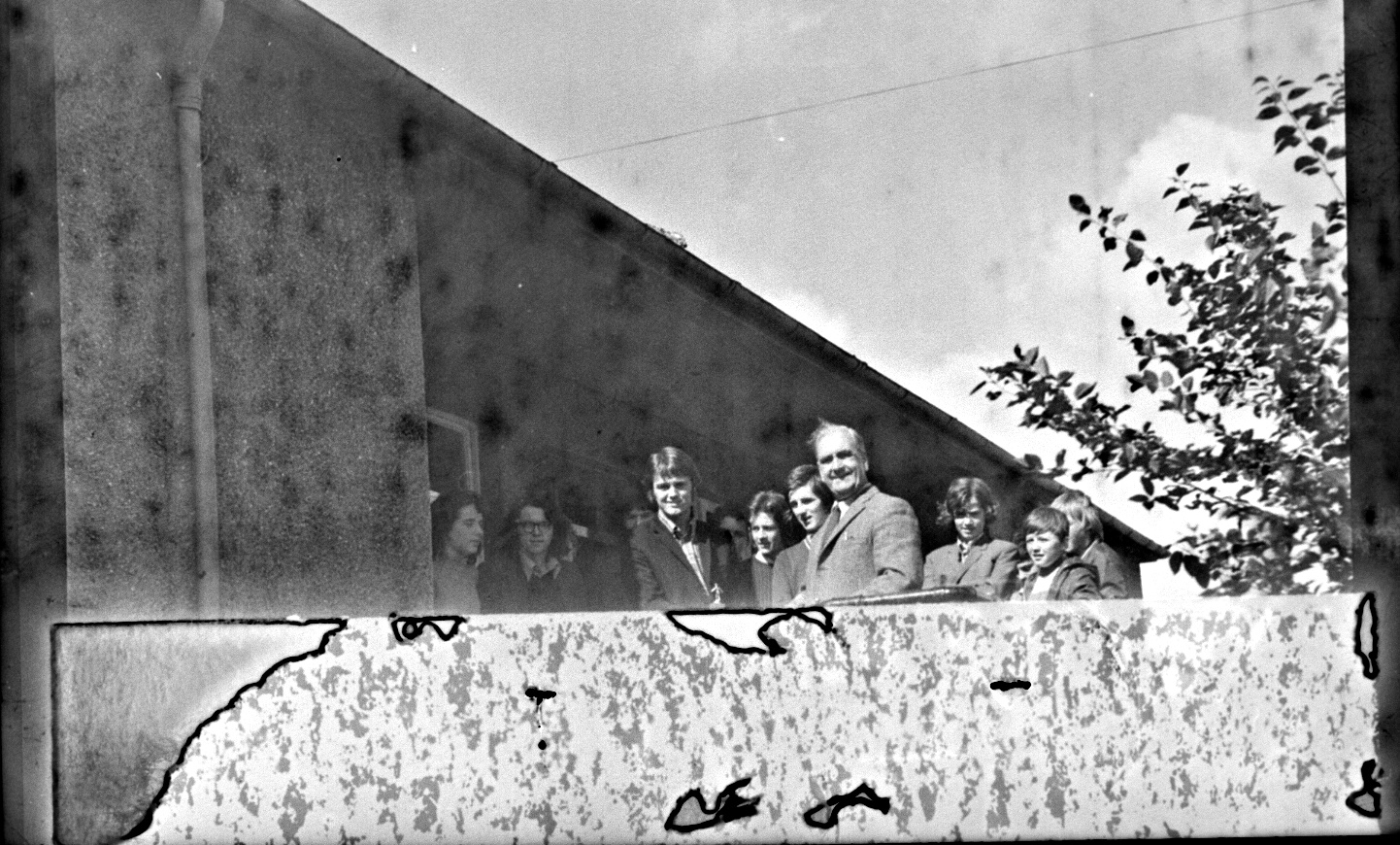

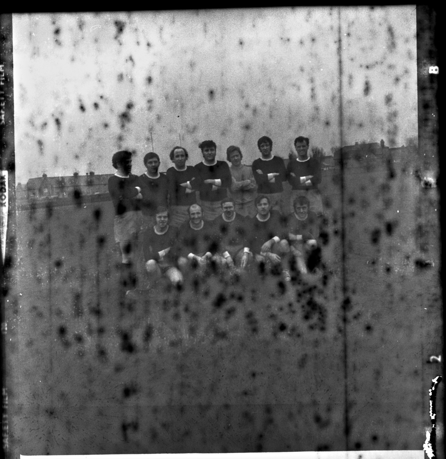

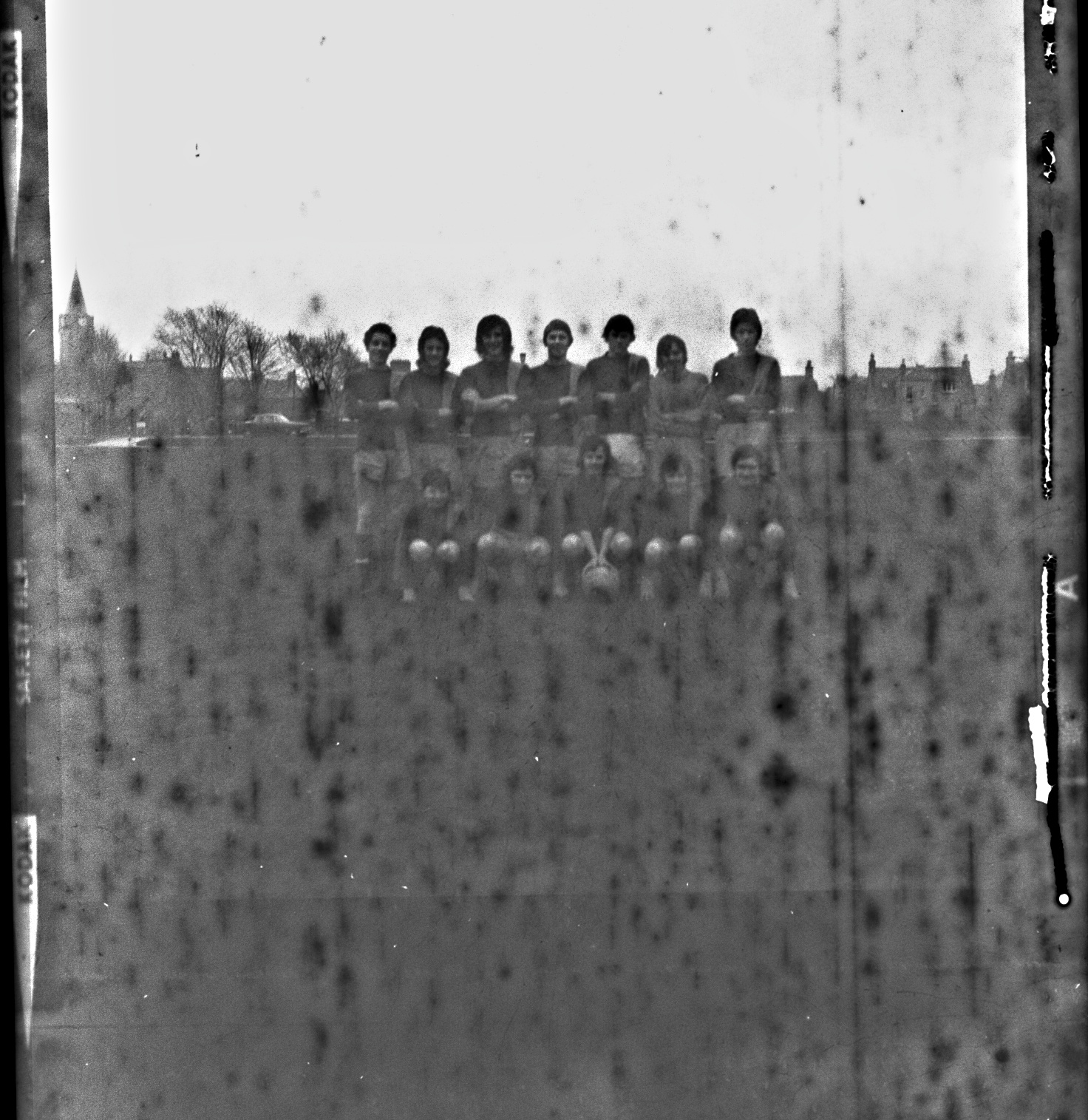

I developed and scanned the film. The film was very badly damaged, but I got some feint and interesting results :smile:

great haircuts. definitely 1970s. what a terrible decade.
Thanks you very much for posting the time/dev guideline and your results, they are great, even if the film base is damaged, the latent image seems to be correctly developped !
