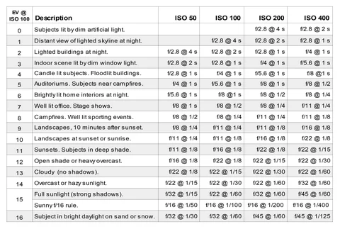

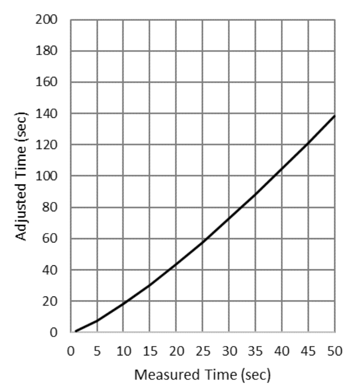

This gets you in the ballpark, then you need to add more for reciprocity failure.
Dim night street scenes are going to be around EV 0. f/2.8 4 sec would go to f/8 30 sec. Reciprocity for Delta 100 at 30 sec is about 70 seconds. On dim artificially lit streets try exposures of 1 or 2 minutes... if there is a lot of strong lighting from shop windows, etc. you may get into the 15-30 second range.

Ilford has a publication that provides reciprocity factors. This can be fairly helpful.
Dale
  • Reciprocity-Failure-Compensation-v2.pdf

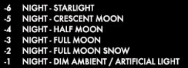

It’s probably in the minutes. Acros has good reciprocity characteristics— just half a stop compensation for exposures over 2 minutes. Try that out instead of delta if your times are longer than 45 seconds.
In addition to what others recommended, The black cat exposure guide (google it) is a handy tool to find exposure times for a given scene. I’ve found the recommendations to be pretty good for night time. The exposure can vary a lot based on what phase the moon is in/where in the sky it is. The guide has several different moon phase and night scene descriptions.
