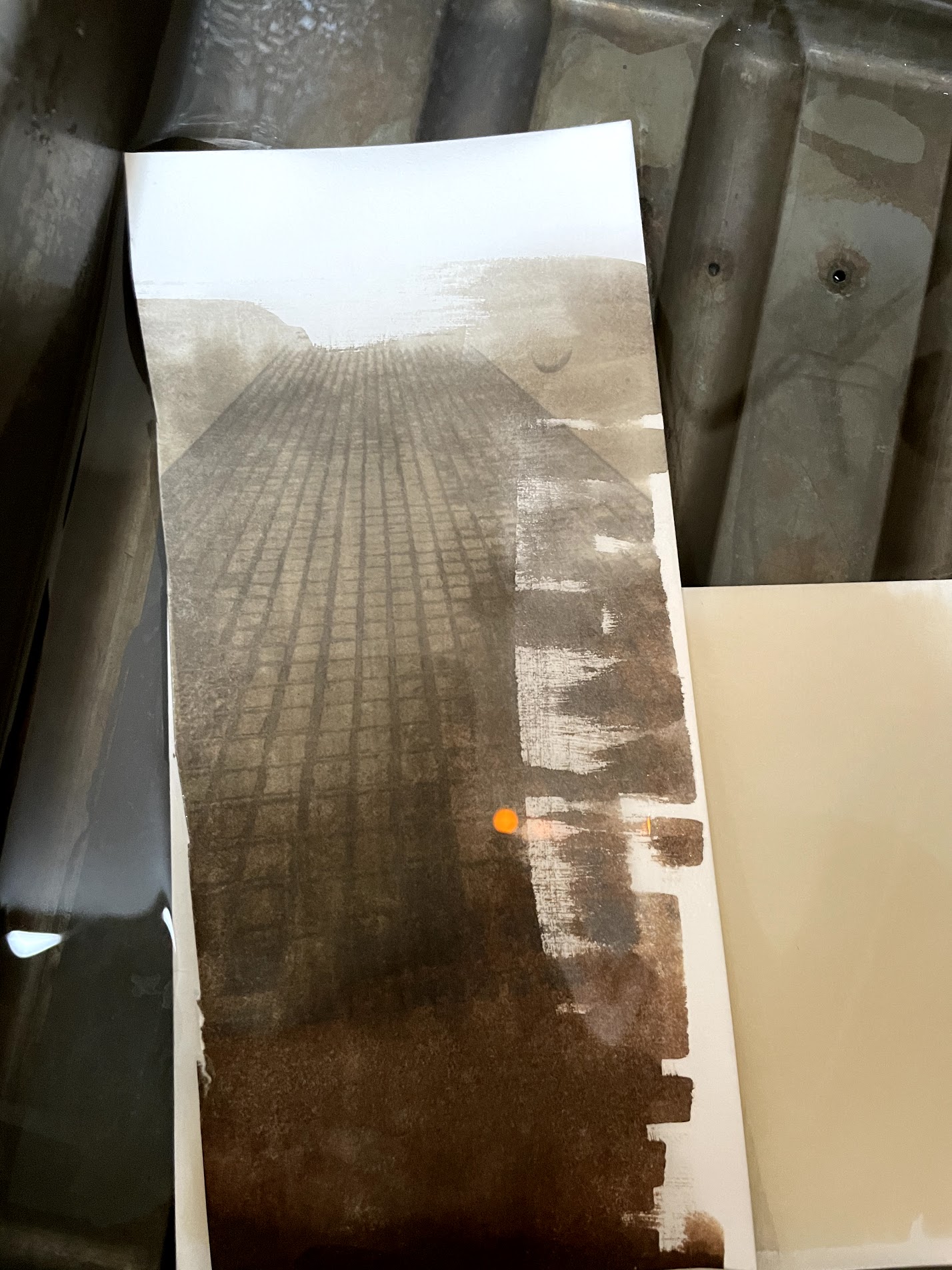

Before I say ferric sulfate is a total wash, I accidentally created a direct positive iron image from a test strip I had left over. Developer contained TEA, hydroxide (pH ~12) and ascorbic acid. Attached image shows the result after bleaching (with ferricyanide) and fixing the top portion of the print. The remaining image is poor (high dmin, poor dmax), but appears to be a pure iron based image. I tried replicating the result without silver, but instead only got a mild grey dmin and no apparent light sensitivity (no image). This could be because I was impatient about waiting for the ferrous sulfate to finish reacting, or the silver actually serves a key purpose. I have no idea how this could really happen though upon analysis. In theory it should be possible to lay down an iron based negative image by adding a strong reducer like ascorbic acid to the developer, but I'm completely unsure why unexposed ferric sulfate would reduce to metallic iron first, creating a positive image.
Also FYI, TEA is also confirmed to be a reasonable traditional kallitype developer AND clearing agent. Even at highly alkali pH, TEA will complex with any ferric and ferrous hydroxide produced, leaving perfect clear whites after development, and then following with a regular tap water rinse. Using a citric acid stop bath afterwards would actually be a bad idea in this case because the Fe-TEA complex breaks at low pH. The image produced is fairly warm tone. Not as warm as citrate, but much warmer than the TEA-Acetate I was using. My coating was kind of bad on the test print I used, but it seems to produce a deep warm brown, and grey-orange highlights

I tested my home made ferric oxalate and it does work, but like a much more mild version of oxalate.
-What do you mean by "home made ferric oxalate?" Did you use oxalic acid? Or just ferric sulfate?
A fun experiment to do, but ultimately not useful for what I want to accomplish, back to regular ol' ferric oxalate. I think I'm now starting to understand why oxalate developers require a "developer" though. Really the developer is more of a solubility agent. Without it, the silver nitrate would wash away faster than the ferric oxalate could interact with it. I don't understand why citric acid or other acids aren't used instead of their salts though, and what effect does pH have on the "developer"? In theory I'd guess too low of a pH will restrain the short lived "development" (since ferrous salts are less reductive at low pH), but it's still pretty difficult to make sense of. I also know many of these acids will complex with silver nitrate as well at least for acetic acid, citric acid, and oxalic acid. Unsure about rochelle salts/borax. TEA also can form a complex with iron and silver compounds (iron more easily than silver), but there's been basically no one crazy like me to try to use it for kallitypes so I'm still in uncharted territory there.
Most of the acids you mention will make insoluble salts with silver, so they can't be used to clear unreacted silver - that's why you fix in the end with thiosulfate. They also won't make effective "solubility agents' as you describe (which is a good way to put it, by the way) for ferrous oxalate, so not good as developers. If they did, there would have been no need to use any of the exotic chemicals such as sodium citrate or potassium oxalate. But you can see for yourself by trying to develop a regular kallitype with citric acid or oxalic acid.
TEA, by the way, might have some health concerns - amines are not very friendly in general so do check out the MSDS on that one.
I doubt you have a pure iron image - more likely a Fe(OH)3 image.
Try making a print with no ferric of any kind, just silver nitrate and you will see you an get a pretty good image (as long as you are using buffered paper.)
:Niranjan.
I meant ferric sulfate, though I also did a single test with plain (not home made) ferric oxalate, which produced no reaction without silver
Yes, I didn't intend for the TEA to be a fixer, but rather to eliminate the clearing bath step (typically citric acid or EDTA)... however, in theory it would actually require less fixing than other developers. TEA will not react with silver nitrate to form anything insoluble, so in theory IFF the only form of silver on the paper is silver nitrate and silver metal, then fixing would be "optional". However, I think it's impossible to prevent silver nitrate from reacting with stuff in the paper, so fixing is likely still needed for archival processing. I did notice that unlike a regular developer though, the tonality change in the fixer is extremely minimal if not non-existent, also indicating that the remaining silver nitrate stays behind in the development solution. It's conceivable I think to consider that this could be a "almost but not quite" archival monobath for kallitype, excluding the toning of course.
TEA is not bad, but DEA and MEA are quite a bit more concerning (and much more smelly). I'm using 99% TEA with minimal impurity (other than some extra water). TEA is often used in soap making, shampoos, and ointments, though of course it is neutralized and not used as-is. DEA is also used, and DEA neutralized by coconut oil is a common foaming agent... though also listed as a possible carcinogen heh. Either way, wear gloves etc but this seems safer than oxalic acid salts honestly.
Regarding iron image, it is definitely possible I'm generating some ferric hydroxide, but I can confirm there are no ferrous salts left behind since they'd turn to prussian blue in ferricyanide. I'm unsure how to test for ferric hydroxide in a way that won't affect metallic iron though. I will run a test later to confirm if ferric hydroxide is solubilized by TEA as research seems to say though, in which case even if some were generated it wouldn't actually matter. Regardless, as long as either pure ferric hydroxide or pure metallic iron is being generated and the silver is bleached away, then it would be fairly "archival" (well, as archival as iron can be)
And yes, I've made salt prints and some test prints using just silver nitrate. The big difference between that and kallitypes is the sensitivity and speed. Salt prints take ~1 hour to expose in my setup and kallitypes take 5 minutes. Kallitypes also have more contrast due to the lack of compensated shadows (ie as density comes up in POP process, it slows down rate of exposure)

So I decided to actually test TEA+water with raw solutions and tiny coatings on paper. I don't understand the exact chemistry behind it, but here is what happens.
Adding silver nitrate to dilute solution of TEA+water: reveals pale brown precipitate which quickly goes into solution. Solution color: clear
Adding silver nitrate to alkalized (pH 14, sodium hydroxide addition) of TEA+water: reveals dark brown precipitate which goes into solution, but more slowly. Solution color: clear
Adding ferric sulfate (acid, undissolved powder in saturated solution) to dilute TEA+water: powder drops to bottom of solution. Enters solution very slowly. Adding very much will cause it to stop entering solution due to low solubility limit. Solution color: orange
Adding ferric sulfate to alkalized TEA+water: powder drops to bottom, quickly entering solution. Solution color: very pale green, with a lot of ferric sulfate addition, stays translucent without precipitate but turns darker blue-green
Adding a lot of ferric sulfate to non-alkalized TEA+water: solution remains orange and opaque with ferric sulfate powder settling to the bottom with standing.
Adding tiny amount of sodium chloride to alkalized TEA+water+silver nitrate+ferric sulfate: causes silver to immediately drop out of solution as a dark greenish grey powder. Does not reenter solution upon addition of thiosulfate nor additional TEA
Adding tiny amount of sodium chloride non-alkalized TEA+water+silver nitrate: Same result as alkalized with ferric sulfate
Silver nitrate paper added to sodium chloride + alkalized solution: orange silver on paper
Silver nitrate paper added to alkalized solution: paper remains perfectly white
Silver nitrate paper added to non-alkalized solution: paper remains perfectly white
Silver nitrate paper, made from non-ideal paper for kallitypes: paper turns orange (unsure what is actually in this paper). Solution is unaffected
It's really hard to make sense of what is really happening here, but TEA is definitely unique in its ability to precipitate some kind of silver compound from silver nitrate, only to then dissolve it again. I'd be super interested if anyone has an idea on the potential chemical equation happening here.
Regardless, this proves that TEA is a reasonable fog-free kallitype developer, but might benefit from an addition of alkali, going against pretty much everything taught about how kallitypes should be developed. Higher pH will result in more complexing ability with ferric compounds. I didn't test iron hydroxide because its such a mess to clean up, but I assume barely soluble ferric sulfate is a reasonable approximation. One risk of what could be happening here is reduction of ferric sulfate to ferrous sulfate, which is much more soluble, however at such a high pH that should also cause silver to fall out of solution so I think that even if this mechanism does happen, the silver compound generated is extremely resistant to reduction. Adding ascorbic acid+hydroxide in a less precise test caused silver and possibly iron to immediately fall out of solution as grey metal (creating a colloid, metal did not fall to bottom). Ferric oxalate (20% solution) seemed to do nothing when added to any of the solutions, solution remained clear with no precipitate. Also, the addition of sodium chloride causing a silver powder I believe is proof that this is not generating silver nanoparticles as may be indicated by some papers (I believe this requires a surplus of silver nitrate to do)
I made a few videos because I thought the reactions were pretty fun to observe
silver nitrate addition:
Ferric sulfate addition:
Sodium chloride addition:
Edit: also further evidence that the stuff to fall out of solution is mostly silver and not iron, it leaves a fine coating on glass ware after the sodium chloride addition. This could not be cleaned by hydrochloric acid which would have dissolved iron immediately. It did dissolve and was cleared however by addition of copper sulfate+sulfuric acid+sodium chloride bleach, and then for good measure rinsed and thiosulfate added. Afterwards beaker was spotless clean
