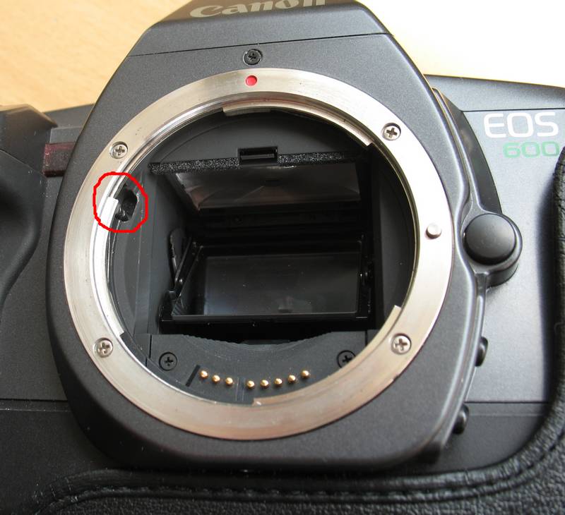

Anybody know what this lever does?
I thought that the EOS system is fully Electro-Optical, but obviously this lever must be useful for something.
I have noticed that if you push the lever upwards and simultaneously press the shutter release that the mirror will flip up while the shutter remains closed. Holding the lever in the upwards position and pressing the shutter release once more makes the mirror go down (but the shutter still does not fire).
Could it be that this feature is there for technicians wanting to get to the front side of the shutter? Or is there a more obvious, picture-taking-related explanation? I've searched the web but nothing's shown up to explain.
Thanks for any help,
Sander

This switch doesn't exist on digital EOS that I'm aware of. Folks selling Mamiya lens adapters on ebay generally say they are compatible with EOS digital, and say nothing about film bodies. One seller linked to a series of photos showing this switch pushed up and a wad of paper placed in the slot as the way to get adapter compatibility with film cameras. I couldn't get it to work for me. And I have no idea what this little switch does.

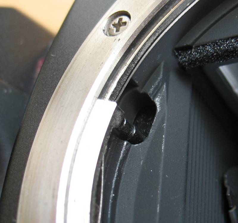

Ah, interesting. The thing is, I purchased a Leitax adapter for my favourite Leica lens (I have only one anyway), the 35-70/4. All my EOS bodies (I have no digital EOS) refuse to fire (the mirror goes up, no shutter release) with the adapted lens mounted.
At first I thought of mirror jam against the adapter or the rear element, or the electrical contacts of the camera shorting against the adapter, but then I noticed how the flange of the adapter pushed up this funny little lever. I filed off some of the adapter's flange so that the lever stays put, and all seems well now.
The question remains though, what is this lever for?
It was on the earlier EOS bodies. You can stick a bit of paper in there to trigger it. The older bodies want to see it activated. I forget where I found this info, it's been a year or two. But that is the gist of it. The early EF lenses had a lobe on the mount that would press the switch.

My take is that the camera gets confused when the "AF micro switch" (or what you call it) is activated by a lens or mount that doesn't autofocus. The camera decides to lock up, not knowing what to do with the conflicting information. Maybe the camera is waiting for some sort of AF confirmation or feedback that never comes, and thus gets caught in a perpetual loop.
Advice to self and others: on cameras with the "AF micro switch", do not use non-CPU lenses/adapters that trigger the switch.

If your adapter has a compatible focus confirm chip, then you would want to activate the switch when it is mounted,
If your adapter does not have a compatible focus confirm chip, the opposite would be true.

Yeah, I got a wire between the + and - of the battery somehow. I remember it wasn't pretty. Now I checked all my lenses and adapters. Some chipped adapters (nikon-EOS and M42-EOS) have a short bayonet piece there, that probably doesn't flip the switch (don't know if they do or don't drain the battery). My chipless Samyang has a long one (and doesn't drain battery) and my chipped OM adapter has a long one too and does drain the battery. I'll do some more tests later this week.

In the mean time, I ground down the piece on my Mamiya adapter that was activating the switch (thanks, DWC, dunno why my brain couldn't sort that one out) and it works on the EOS 3. Next task is to take some actual pictures with a real lens mounted. :errm:
Lens mount index confirmation. The flange engages here and pulls it up, thus confirming with the body that the is in the correct position and electronic control state is readied.
