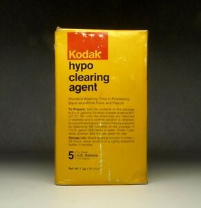

You are correct sir. The use of hydrogen peroxide for "nuking" thiosulfate is not a good idea. I will defer to PE and others for the exact explanation. Kodak warns people about this.
I use Kodak HCA for fiber prints and film (gets the purple out). The confusion comes from Kodak published a formula for "Hypo Eliminator HE-1" this is the ammonia water, hydrogen peroxide concoction that could cause problems.
I'm sure that if it meant hauling water, the Army folks got pretty creative. :smile:.
Obviously there's all sorts of wash aids out there.

Good points, I'm not sure when Kodak started selling HCA, I have a 1951 Kodak book on all their ready made stuff, theres no mention of Kodak Hypo Clearing Agent. I remember in the 60's Kodak Dataguide Kodak stressing the need for HCA to wash in cold water. If you were some place without realitively warm water you would never get hypo out.
