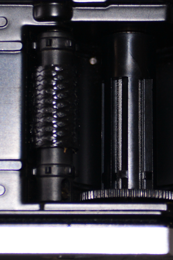

I have a Konica Autoreflex T which was modified for use with unperforated 35mm film. Instead of sprockets moving the film there are rubber rollers where the sprockets used to be.

I have modified a Nikkormat Ftn by adding sufficient textured rubber tape to the sprocket spindle that it provides friction to pull the film along. Negative spacing is non-standard, but it works a charm. Very cost effective.
