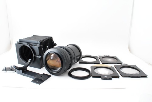

Hi guys,
I'm thinking about picking up this lens (link below) offa Ebay.
Anyone have any opinions on the fact that it has "some haze located on the edge of the front lens"?
I bought a few things recently from Ebay Japan, and had only good experiences, but this would be the first time i buy something that's not totally mint.
Thanks for your time!

You can't tell anything about the lens from the pictures, unfortunately. The one look through the lens doesn't look that great but the lighting isn't good in the photo. "Haze" is pretty vague. The lens isn't overly expensive, though.

You're right, it's hard to say much from the photos, apart from that the body looks in nice shape.
"Haze"is vague, but at least they say it! It seems that the Japanese are very fastidious about honestly declaring and describing faults with lenses (perhaps it's a cultural thing), whereas most other sellers from other countries don't bother and just say"mint" or "excellent", even when it's clearly not.
But yeah, not much money, i might just go for it, for some reason there are no mint examples of this lens available, whereas the RZ version has many to buy on Ebay.
Is haze always detrimental in a large way, or can it be very subtle or even invisible? I'm not after ultimate sharpness or clarity, otherwise i'd just shoot digital!

What haze does will depend on how much of it there is. A lot of haze, from coating damage or some kind of oil build up inside the lens element, will flare any source of light in the photo and overall reduce contrast - it may more or less obscure fine detail if there's enough of it. And I have an Elmar 28 that had so much damage to the inner part of the front element (I bought it cheap), you couldn't see anything through it.
Haze as described in that listing might have no impact unless the lens is used wide open with a backlit subject. But there is the chance it will cause the lens to flare more easily when the light is from the side - but a lens hood would help with that.
