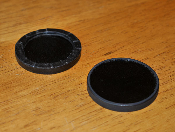

How large a piece of film did you need? Actually, I am not sure if I have any at the moment, but if per chance you were wanting to make a Series-VI size filter, I would be happy to send you one of the ones I made:
I can show a comparison between images made with the homemade E6 filter and an "official" IR filter too if anyone is interested.
