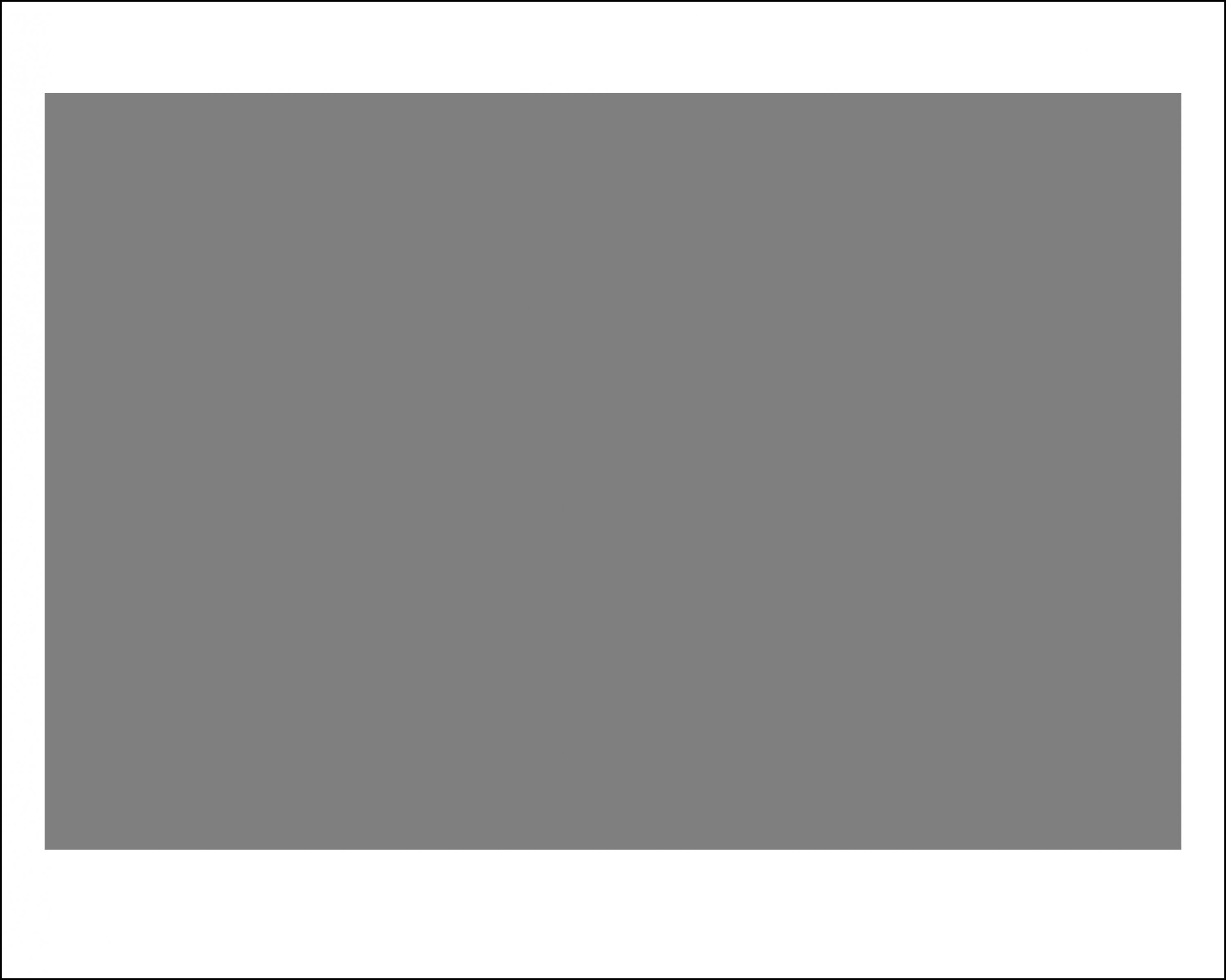

Print the full-frame on 8x10 paper, leaving a white border with slightly more top and bottom than sides. If you want to get fancy, make the bottom border a bit wider than the top.

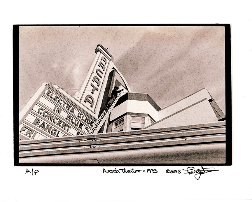

I love the 2:3 aspect ratio, so I generally print 35mm full frame at 6x9"-ish on 8x10 paper and 8x12"-ish on 11x14 paper, slightly bottom weighted. The white paper borders make an nice frame for the image. Sometimes with a thin black border (four bladed easel) or the full frame border (as below).
