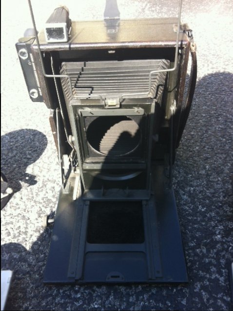

The Camera is a Speed Graphic 5x7, in good shape also has a flash that takes the bayonet style flash bulbs. Can't find too much info on the camera. The lenses are old, all barrel type except for the Schneider which is the only one that has a shutter and would work on my Monorail, the other 3 need to live on my Speed Graphic.

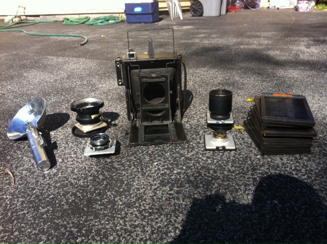

Here is everything...
Camera....

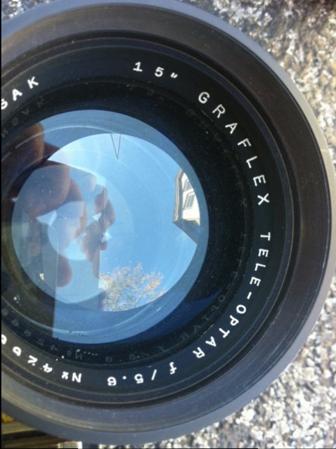

Graflex 15" tele-Optar ƒ/5.6

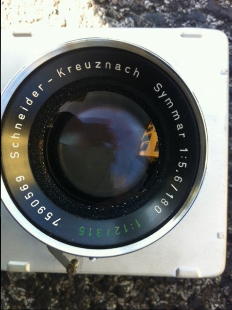

Schneider Symmat 180mm ƒ/5.6

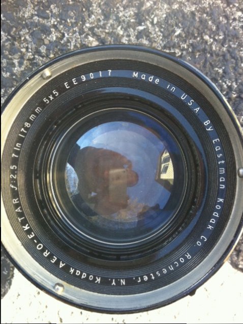

Kodak Aero Ektar 7" ƒ/2.5

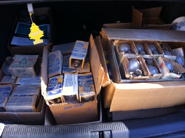

Trunk full of flashbulbs (this is about half of them) Plus some chemicals for making developer, etc...

Since the aero Ektar alone is worth more than $300, you got a deal.

5x7 film holders in any sort of shape still get some money, but photoguy is right about the Aero-Ektar-- I have been trying to get one off eBay for some time. SWEEEEET

Do some searching, it's a well regarded lens. (Aero ektar). Definitely scored on this haul, no doubt! 5x7 speeds are fairly uncommon I'd say, too.

The Aero ektar 7" is a very good lens but will only cover 4x5.
The Graflex 15" Tele-Optar ƒ/5.6 is also an extremely well lens but also will only cover 4x5.
I personally own a 15" Tele-Optar and use it often. (I would equate it to a 135mm lens on a 35mm camera as far a focal length goes).
The 5x7 Speed surprises me... I have never seen a 5x7? It must be pre-1930's

The Speed Graphic should have a serial number stamped on the inside of the top of the camera. It should be five or six digits. Some folks have a way of determining the year of manufacture based on the serial number.

The 15" lens might be a great portrait lens for me as long as I can get enough bellows draw from my Horseman

The lenses don't go on that camera. They go with a pacemaker (post WWII) speed graphic. The 5x7 would most likely use wooden lensboards. (which you can make yourself if you wish to use it) Looks like a decent haul. The speed graphic is probably 1930's or earlier. You'd have to compare it with photos of others online. I have a 4x5 speed of similar vintage that's late 20's early 30's.

According to Richard Paine's A Review of Graflex, the 5x7 Speed Graphic was produced up to 1941 with little of the updating found in the Anniversary model. If the tubular finder is original, your camera was made in 1939 or later.

Also of note: if the flash handle is a Graflex 3-Cell, which it appears to be, those sell for well over $100 on Eb@y because one was used as the basis for a lightsaber prop in the original Star Wars movie.
http://www.squidoo.com/graflex-3-cell-lightsaber-construction-guide
Jonathan
I knew it looked familiar! Mine is a 3-cell handle. Seems as though this and my Heiland handle were both used and modified as lightsabres for the Star Wars movie. If not for the fact that I absolutely love these 2 flashes and I'm sitting on over 300 flashbulbs I might have just sold it on the big bay.

Seriously. It covers 4x5 with no room for movements, it's horrendously heavy, it isn't the sharpest lens, and it's difficult and very expensive to put in a shutter.
The only reason to use one is for the very shallow DOF afforded by the wide aperture.
It's not original. I found the original flip-up gunner style finder in one of the parts boxes, the holes in the body lined up perfectly. I took off the tubular finder about an hour ago.

It covers 4x5 with no room for movements.
Not entirely true. I haven't measured precisely, but I can get some rise out of mine, as well as a modicum of tilt, swing and shift. I get dark corners when I tilt it back as far as the Speed Graphic's front standard will allow, but movements are indeed possible, especially at portrait focusing distances.
I will concede that, when used wide open, the movements are commonly used to augment the lens's quirks and to exploit its shallow DoF rather than correct for perspective in the traditional manner.
