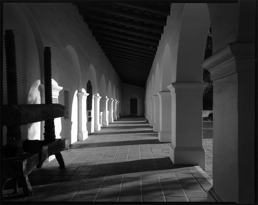

I've been shooting Delta 100 in 8x10 this year and have been very happy with the results in HC-110 Dil:B.
I usually make 2 exposures per scene, in case of dust on one of the negatives - one @100 and one @50. So far both ratings have given me perfectly printable negatives in the darkroom, although I usually prefer a denser negative myself.
This is a contact print from a negative that has more than enough range in both the shadows and highlights, so that I can emphasize either one as I need to without any loss of detail.

Actually, the grain is never a concern for me as I only contact-print the 8x10 negatives, and for 4x5 I never print larger than 11x14. Since I have to use a tripod anyway, film speed isn't much of a factor.
I mostly go by the results I get for the type of printing I do. I also use TMAX100 and 400 films, and have been very happy with them. I also shoot J Lane dry plates in 5x7 and 8x10, and those are available in ISO 2 or ISO 25 "Speed" plates. Trying to meter a scene at ISO 2 can certainly be a challenge.
Since 8x10 film is not cheap, I first tried this Delta 100 only because it was on sale at Freestyle. I really like the results, so I'll definitely keep using it.

I can only imagine the detail you must be getting from this film at 8x10 jim. Your photo above has some very smooth tones.

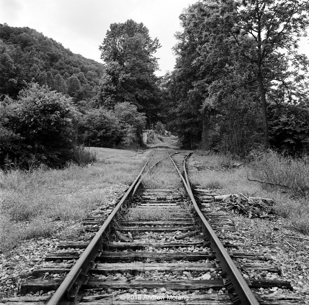

Here is an example of Ilford Delta 100. I like it but have not used much recently (for no particular reasons). As I recall, I exposed at EI=80. This is from a Rolleiflex 3.5E Xenotar with a green filter, tripod-mounted. Location: Topton, North Carolina, USA.
If I may say so, good use of the green filter for the trees which may have been too dark and otherwise spoiled the balance. It is the sort of scene that the need for a green might have escaped my attention. A useful reminder for me, thanks
pentaxuser
Thank you. I use green or yellow-green filters often. Here in the US South, the forest (jungle) pretty much dominates the landscape, and I try to get some texture in the foliage.
