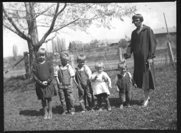

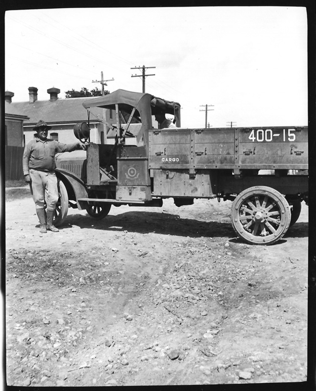

I recently contact-printed some old negatives for a neighbor who had received them from a family member. As far as I can tell, most were roll-film negatives from the 1910's to 1930's, all were either 3.5x4.5, or slightly larger. Probably taken with larger Kodak folding or box cameras. There were some scuffs and scratches and a lot of dust, but they yielded some nice images after a bit of cleaning. Here's a few:

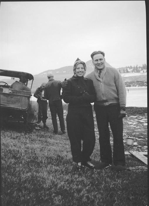

I've got all my Grand Father's old negatives from when he was a kid in the 1910's, and onward. All of them were stored in their original envelopes. No sleeves. All of them are in great condition.
My Gran and Gramps, skating on the Thompson River, Kamloops.

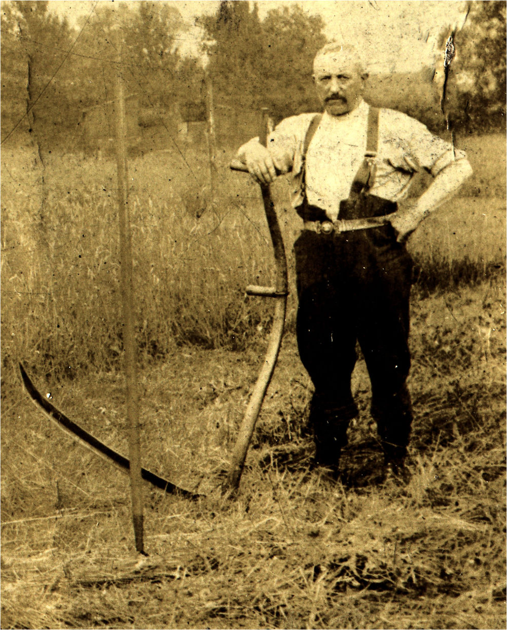

I have been working with some small old prints from a deceased relative which were obviously contact printed. Most on post-card size from 1910-1920 and I guess from 122 film. The detail in the prints is excellent, and are easily increased in size by a process we don't talk about here :smile:
here's one that was a very raggy faded postcard sized print that has yielded a pretty good image of a relative
