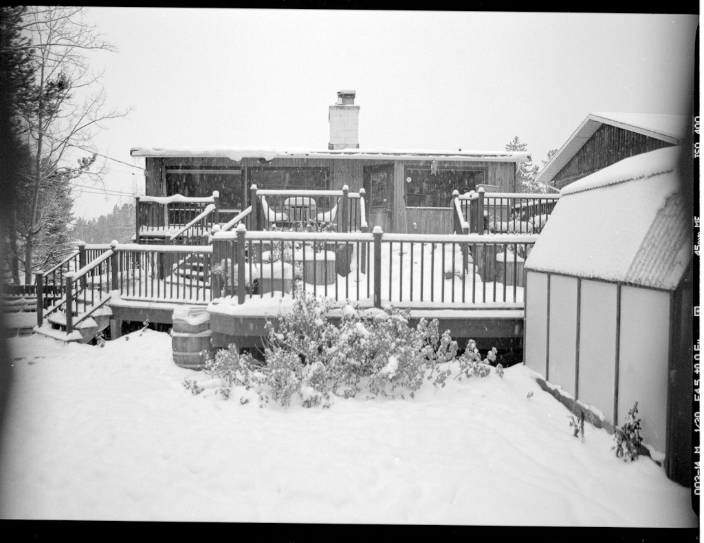

I processed three rolls of 120 the other day. I always do a single roll at a time just in case I make a mess of something. Anyways, six frames at the end of the second roll had dark, foggy edges. Normally when I screw up it because I somehow loaded the film wrong, is that what happened here?
Here is an example (unprocessed) scan:

Air bubbles along the edges maybe, or the emulsion side of the film sticking to the plastic reel and not allowing the developer to do it's thing.
johnielvis
May 21, 2010
966
could be from the reel when you develop it--that's what it looks like to me -- not enough agitation to get chemicals near the steel coils...this is 645 sized, right? if not then look inside your camera if this is 6x9....
but if 645 then maybe you do have loading issues or the reel is weird and gets closer to the image area...or somehow way too tight curl in the film that pushes the emulsion against the coils???? tough one...you'd be able to tell when you pull the reel out if it's been loaded wrong...

Interesting. Are those dark bits on the film-edges or are they the inter-frame edges? I originally assumed they were edges and that this is 645, but the exposure printing in there (and lack of film-ID printing) is confusing and makes me think this is maybe your 690, but this doesn't look wide enough to be 45mm on 6x9 and if that 003-14 means "frame 14" then has to be the 645...
Anyway, the weird thing is that the exposure-printing seems to have been developed nicely despite the image near there being darkened. And it seems to go towards a middle-grey rather than black; see in the tree at upper-left it's no darker than at the right.
Is there any chance you accidentally got some gloved fingers in front of the lens or something? What do the negs look like, do they have any slight milkiness or brown staining?

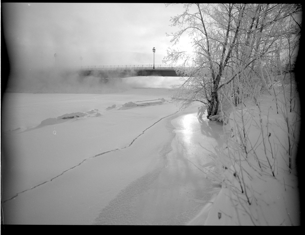

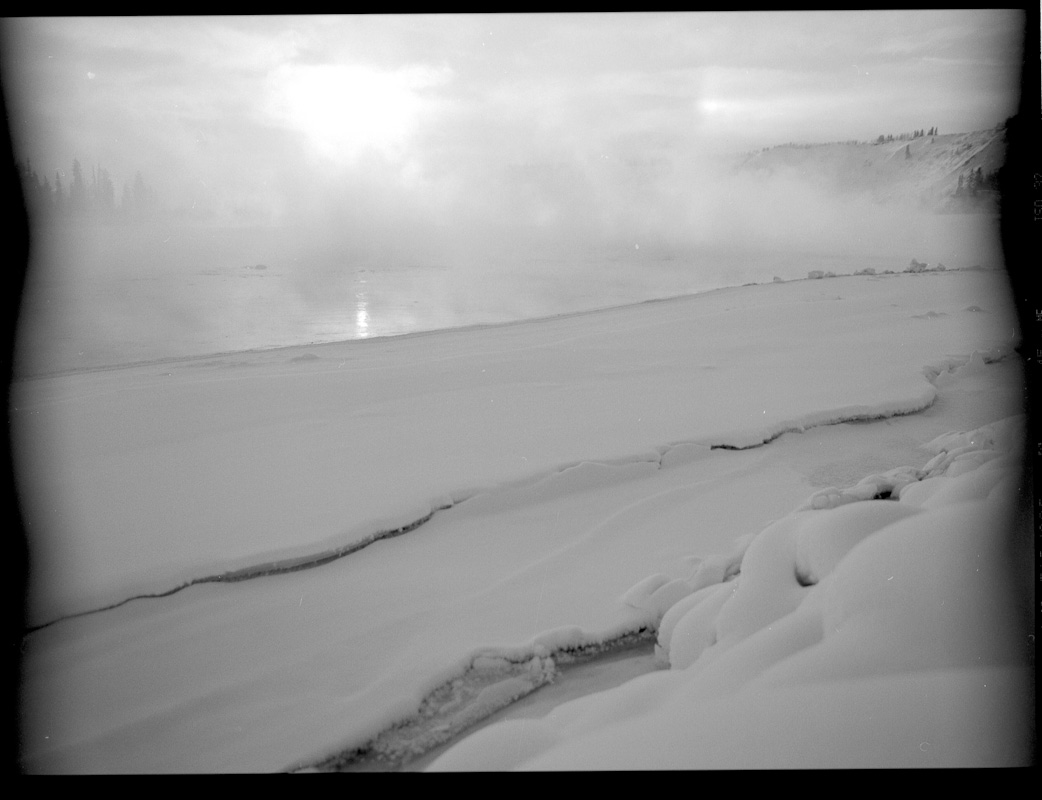

I just processed another roll from that camera and same problem. Instead of being 3-4 frames at the end of the roll this time it was 5-6 frames in the middle of the roll. It was a bone dry reel and everything seemed fine loading it and when it was coming out of the tank. I really don't think there is a problem with the processing, I've done enough rolls to know when I've screwed something up.
Since the sides of the negatives are dark this is leading me to believe it is a camera issue and the film is not getting light somehow. Would it be possible that I have film problem? Maybe the film is curling and so the top and bottom edges are not getting exposed? I was shooting at -30 C and the camera was very cold so I am wondering if this is causing some kind of problem in the camera.
I'm going to try shooting a test roll indoors to see if cold is a factor, and also will try a different film back to see if that is part of the problem. Maybe my pressure plate isn't working in the cold?
Here are some more scans, as always any thoughts and feedback welcome.

Was this shot using a Pentax 645NII? If not, what type of camera?
MARKNABIA
Oct 6, 2012
53
looks like the curling is pretty consistent on each frame.try to send your next film to the lab, then if it the same problem, you might wanna check your camera...

Yes, it's with my 645NII.
I have had recent rolls out of this camera processed by a lab and at home without this problem. So either it has happened very recently or it's somehow related to the cold weather. If I can shoot a test roll indoors without a problem then maybe I can narrow it down to temperature.

Well looking at the first new frame you posted, it almost looks like light is coming around the bump on the lower right side. Check the camera, something could be buckling in front of the shutter curtains and causing a shadow on the film, maybe?
