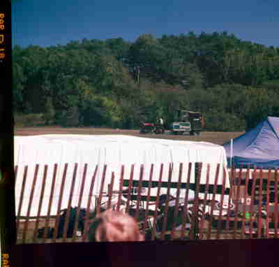

I have been taking pictures now for about 2 years, mostly slide film with a Mamiya 645 1000s and a big clunker of a RB-67 Pro-S. Now I had been using the Kodak 5L kit to process the film at 500ml of chemicals per run, and with the processing machine I put together, I went through about 60 rolls of e6 without a flaw.
Now that Kodak has discontinued the 5L kit,I purchased the 5gal sizes of the chems, with the exception of the bleach. For that I used a E-4 bleach which consisted of
Potassium Ferricyanide 120 gram
Potassium Bromide 24 gram
Disodium Phosphate 45 gram
Sodium Thiocyante 10 gram
Water to 1000ml

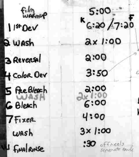

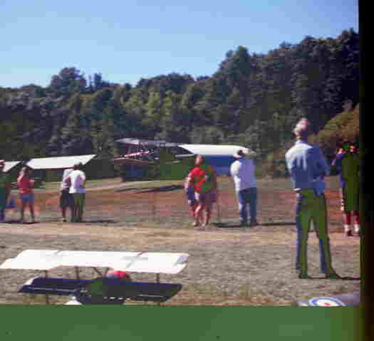

Now I split the chemicals as shown in picture 1 ; then I processed the films according to the times on picture 2(these are my standard times), but the slides came out horribly as you can see in pictures 3 and 4.
what bothers me is that the Provia has the green tinge, especially in the shadows, while the Asita has a bad magenta cast to it ,but they were run in the same batch, so I am at a loss besides blaming the bleach.
I did put 2 water rinses in before the bleach, so I didn't forget that
Any help you could give would be greatly appreciated, as I really want to go out and shoot more film,but I've got to be able to process it as well
Thanks

Well, with a Ferricyanide bleach in E6, you really need a good wash and clear before the bleach and after the color developer and you need a clear and wash after the bleach so the cycle would be:
Color Develop
Clear
Wash
Bleach
Clear
Wash
Fix
etc....
IDK how the lack of a prebleach or conditioner would go with this either. The Ferricyanide is so strong that it can oxidize the CD3 and form dyes and it can also react with hypo and form Sulfur. The lack of the prebleach or conditioner may mean that you will need a formalin step in there as well. IDK what else may accrue from this many changes.
Good luck.
PE

Thank you,PE. I have some Photo-Flo solution mixed with formalin to use as a last rinse/conditioner , so what I will do is a run thru with both rinse and clearing solutions(this with sodium sulfite added) and see what happens. It's just that 130.00 USD a bottle for Bleach III really makes me want to find a less expensive way to go

The Ferricyanide bleach is likely your problem. As PE points out, E-6 was not designed for that older chemistry. I have had no problems using a persulfate-quinone bleach with E-6. It works well for me with both C-41 and E-6.

For this type of problem, you cannot fix it. The harm is done to the colors. For dye stability, you can fix the problem with Formalin in the final rinse.
