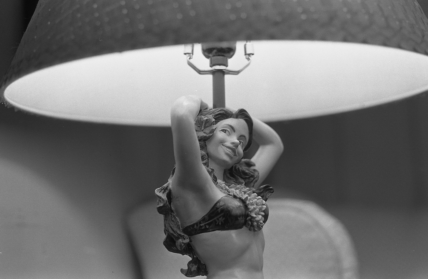

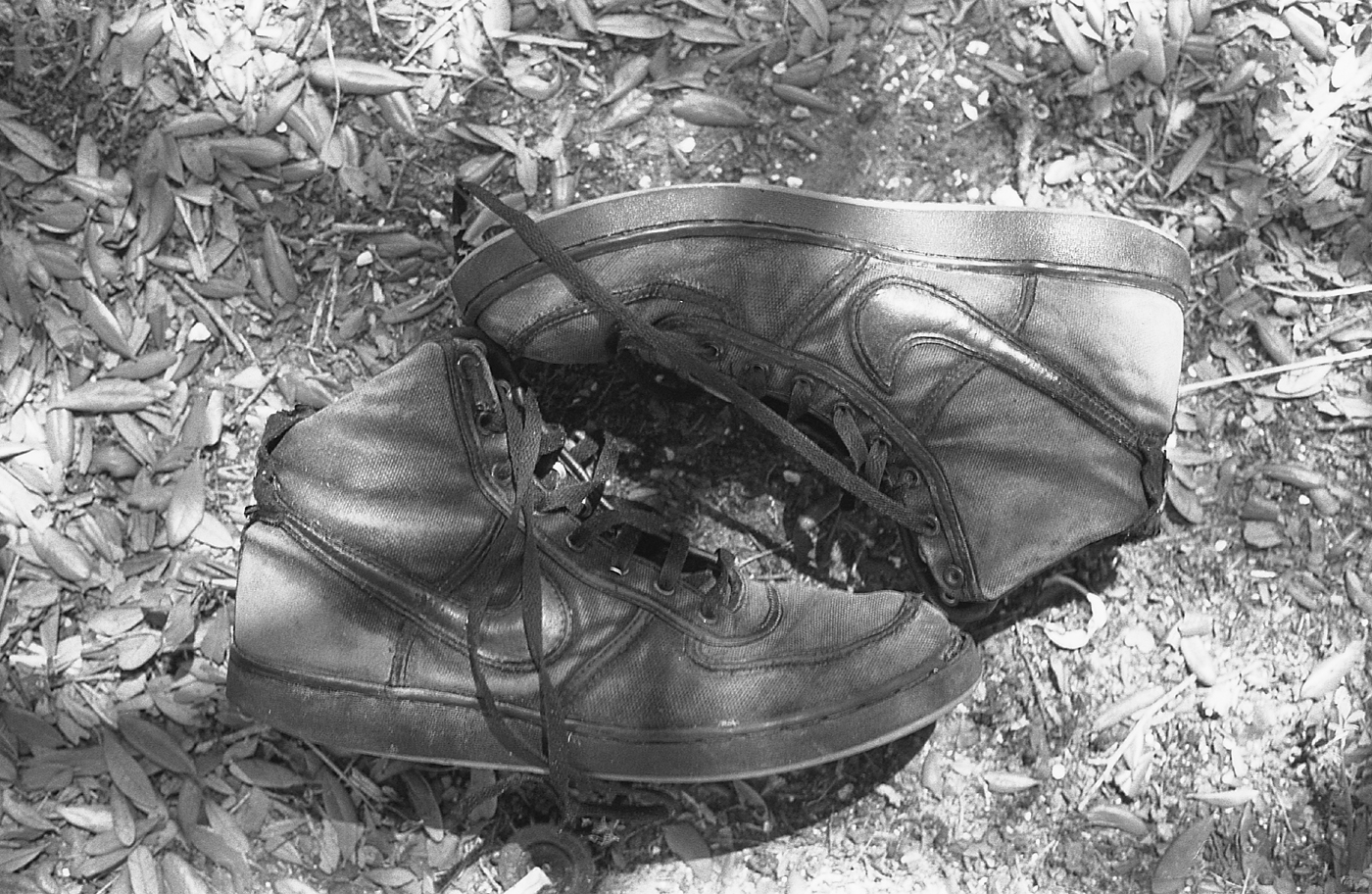

These were taken w/ the same camera and film (Nikon FG w/ non AI 50 2 lens, Arista EDU Ultra 100 film), and I developed the first shot in Microdol-X, the other two in Rodinal at 1:25. The pics were taken over a month apart, and the same shoes were still there on the side of the road! Things are a little slow here I guess.
Both developers worked fine, but the Mic-X tonality is more to my liking. In the low light shots, both developers gave nearly identical results. You wouldn't think they would, but they did. Rodinal grain, at my place, is totally dependent on agitation and exposure. Even at 1:25 using 35mm film I get very little grain, but underexpose it even a little and its there. It's not on the wet print however, unless you do huge enlargements, just on the neg. I find Rodinal grain beautiful anyway.
