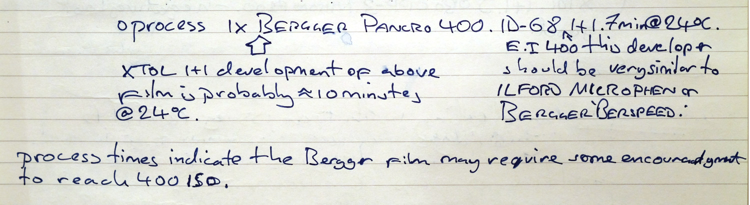

Tom Kershaw
Jun 5, 2004
4,975
Norfolk, United Kingdom
Paul Howell
Dec 23, 2004
10,033
Scottsdale Az
After developing my first roll of Bergger and ordered 5 rolls of Kentmeyer for my point and shoots, even at ISO 200 the negatives are thin, printable, the frames shot at 400 are too thin to print. I used Clayton F76+ 1:10 gave and addtiona minute over the times Bergger posted for Pancro in D76 10 m at 68F, using D76 time for Clayton has worked for every other film I have developed in Clayton. I have 4 more rolls, will shoot at 100. I usually don't get all up in the air over how folk advertise their products, this seems over the top false to push a ISO 100 as 400.
