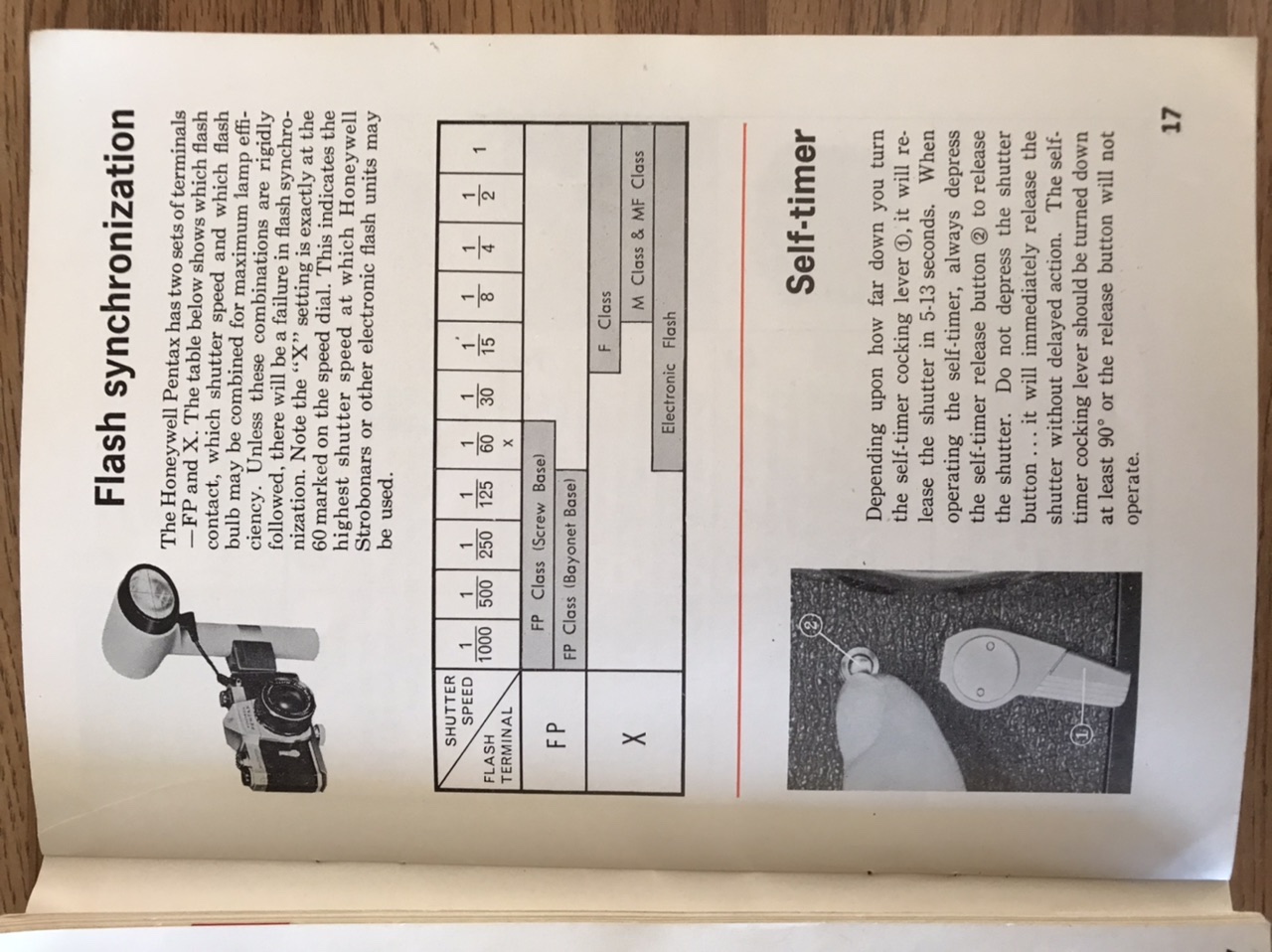

Here is a user manual for the Nikkormat FS (a meter-less FTN) that I found on the Nikon website (google is your friend).
See page 22 for flash sync info....
Nikkormat FS User Manual PDF

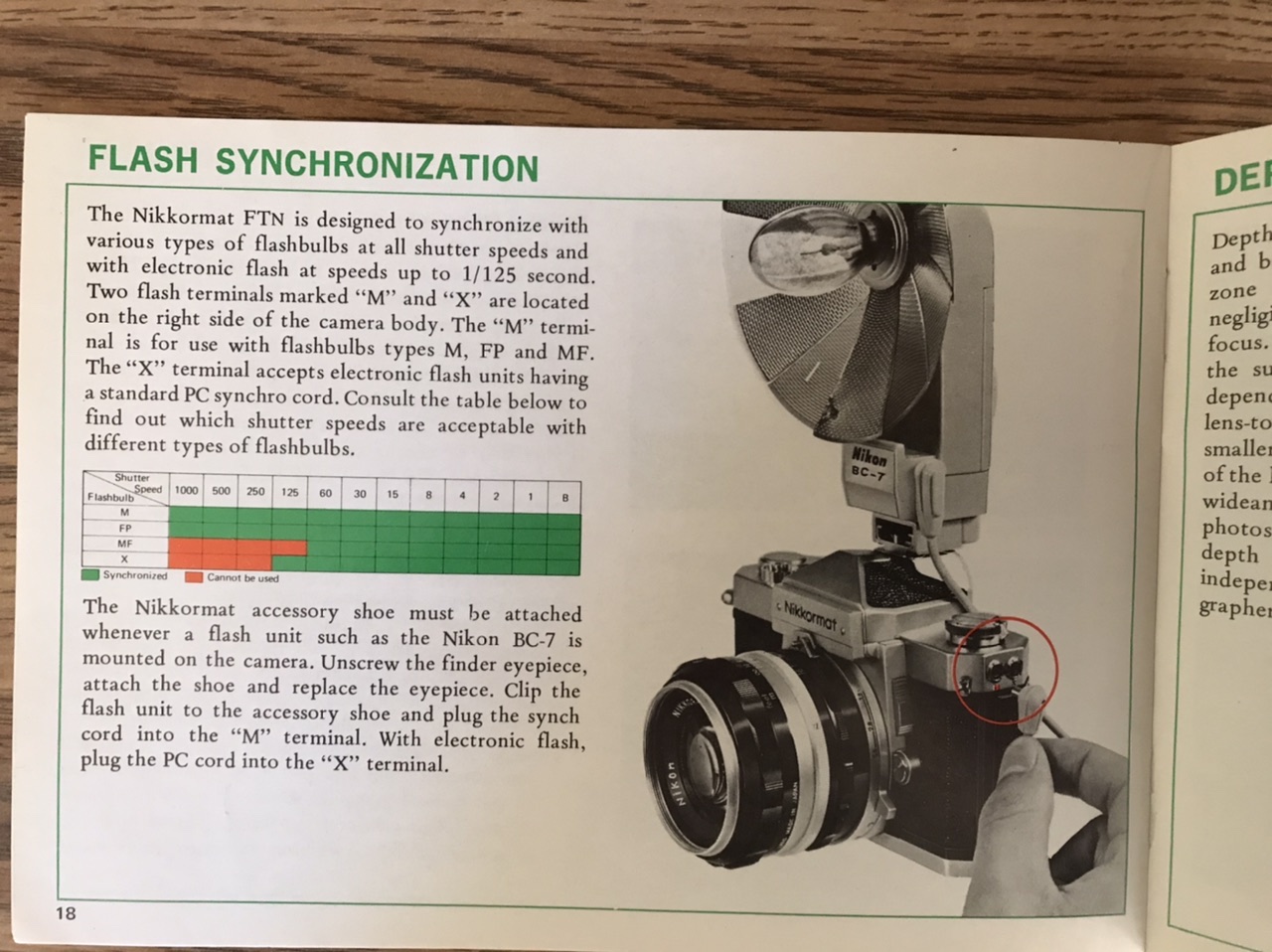

I mean, I own an FTn, I just wasn't near it to see what the second terminal says. I think it's F now that I think of it.
Anyways, M. Butkus should have the actual FTn manual, his Nikon section is very exhaustive.

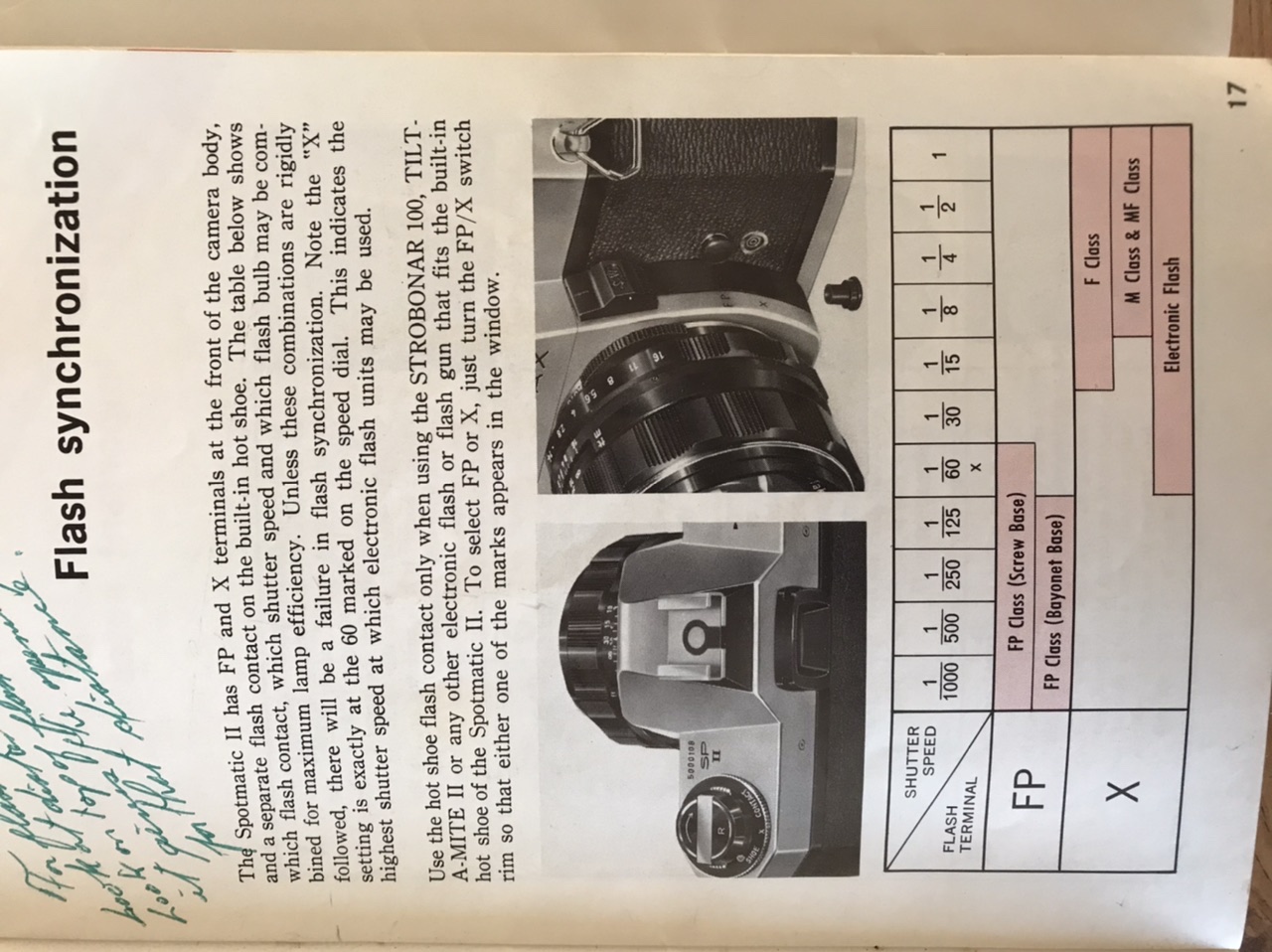

Oh for heaven's sake! Here...here's the page from the FTN manual.

and here are some spotmatics...
That's interesting. The large slits and short travel times of the vertical shutter seem to allow many kinds of flashbulbs to act like FP bulbs.
On the other hand it seems like the cloth curtains don't want to sync an M bulb at very high speed at all. A test is in order I think.
I see the same page saying you can use M bulbs at any shutter speed when using the M sync connector. So yes, acting like FP bulbs without needing an actual FP bulb. Apparently the slit travel time is within the bulb's "flat" brightness time.
These early all-mechanical Copals are some of the best shutters ever made. They last forever and they don't typically take damage if the camera gets dropped or banged into something.
My Nikkorex F should have the same flash sync characteristics.
