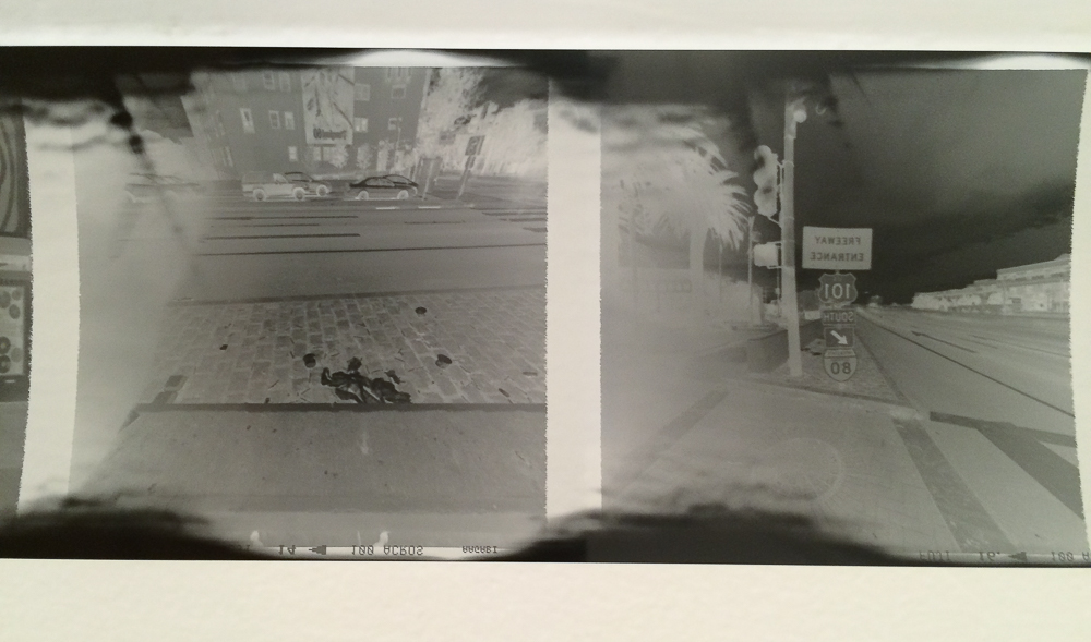

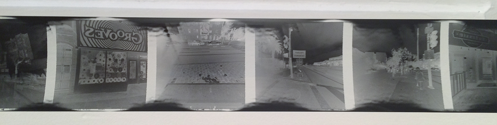

Are these light leaks?
This was my first roll with my new Ondu 6x6 pinhole.
Acros 100 processed the way I usually do:
HC-110 dilution E, 8 min @ 20°, total 600ml fluid in a Paterson tank With a rubber band around the post to help the reel in place.)
I'm wondering if light somehow leaked in the two days the roll was sitting on my counter after it was exposed.
I appreciate your help!
Adam

Yeah, I'd say light leak.
JW PHOTO
May 15, 2006
1,148
Lake, Michig
It's a like leak, but the pattern makes me wonder if it isn't camera related? Of course if it was lying in the horizontal position, with a strong light above, then it could be from a bow in the exposed roll. The tern "new camera" makes me a little more than just suspicious in this case.
winger
Jan 13, 2005
3,980
southwest PA
Because it's not in exactly the same spot on each frame, I'd say it's more likely that the roll wasn't tight enough rather than the camera. When the roll is done and you remove it from the camera, it doesn't always stay rolled tightly (some cameras don't make it tight to begin with). If it's loose at all, the light gets in easily. It doesn't take much. Yup, BTDT.
pbromaghin
Sep 30, 2010
3,863
Castle Rock, CO
I got something almost identical when a film wound too loosely onto the take up spool and I removed it under bright sun.
Adam W
Jan 15, 2013
228
San Francisco
Thanks for all the replies. Upon closer examination, the leak marks are worse towards the end of the roll, so I'm pretty sure it's a spooling issue. I'll try another roll and advance the film more carefully, load and unload in subdued light, tape the roll carefully, and keep the exposed roll in darkness until I process it. (All best practices I should've done anyway!)

I guess your pinhole is not keeping the film flat during expose.
