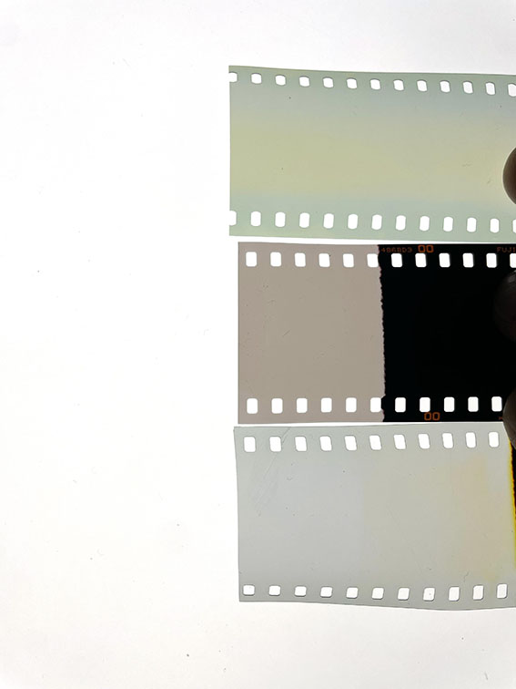

What causes this color on the exposed leader of Ektachrome E100?

Both were developed in the same batch of Unicolor (Film Photography Project) 1 pint E-6 kit. I dev'd 3 films in the 3 reel Paterson tank and the E100 is the only one with this color on the exposed leader. The other film shown is Fuji Sensia 400. The E100 is not expired. Anyone know why it's happening?

There’s a clean line with the partially exposed leader. It makes it look like the E100 was loaded into the camera in a darker location. It received some light and then the leader was pulled a few mm exposing an additional few mm which shows up as the darker shade. In contrast the roll to the right was loaded into the camera in light and the leader was fully exposed to the part of the film that remained in the canister.

Hmm. I stored the E100 outside of its canister before shooting it, in a clear plastic bag, because I needed to get it checked by airport security. Its leader was exposed to daylight for many hours. That's why I would expect it to be perfectly clear. It's a curiosity.

Yes it's been dry for a week. I'm at a loss to figure out what's happening, part of me is wondering if the darker area of the film is somehow bleeding into the clear area.

Exposing E6 film from the back looks exactly like in your images. It happens when loading your camera.

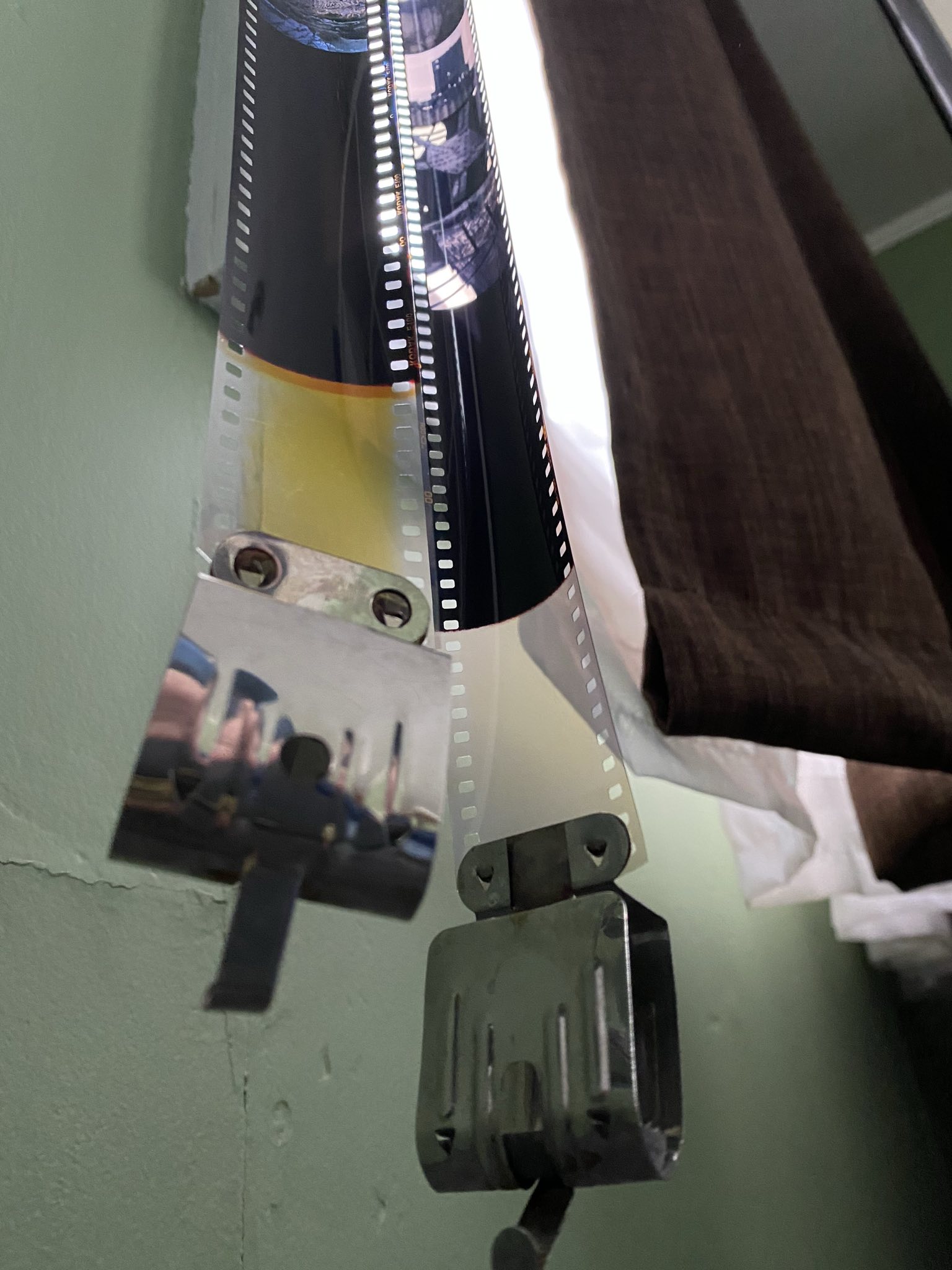

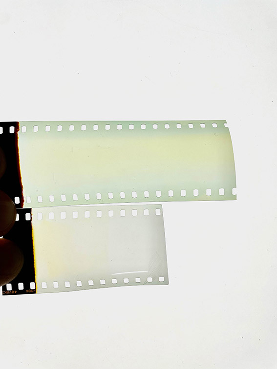

I bought a roll of fresh Kodak Ektachrome -in a roll of 122m. I wound 10 rolls and developed for the first time in Bellini chemistry. I am puzzled by the greenish color of the runners. I don't recall having such before when developing in Jobo chemistry and before that in Fuji. My first thought was that there was something wrong with the chemistry, but it turned out that I also developed Fuji Provia and it is standard as I always had. In addition, I have the impression that the photos are a little cooler, but here it remains a matter of time - I had 7:20 as in Jobo. What do you think. I show two sample photos: the first with two tips are from one of my developing and it is Kodak and Fuji. The second photo just for the sake of example - there is a run-out from Provi in the middle but I received this developed only for scanning. I don't know how it was developed.

In my case I was getting confused about the yellow color but apparently that's just what happens when the slide film is exposed through the reverse side as in loading a camera due to the filtration through the film's layers.
The middle film with KS sprocket holes is too dark in the highlights. This os typical when the FD is exhausted (used for multiple times, stored for too long, etc.) This could be the cause for the greenish tint, but if the FD was fresh, one possible culprit is final rinse contaminating the first developer (equipment not washed properly after processing). I doubt there is anything wrong with the film, but suspect this is an issue with processing. Different brands of films can react differently to contaminated chemistry,

Thanks for the responses. At first, I had similar thoughts—that either the FD was contaminated or the CD had the wrong pH, or that Bellini makes weak chemistry. But after comparing it with Provia from the same developing tank, I can’t really agree that it’s the chemistry’s fault—probably :smile:.
Maybe the issue lies in a light leak that occurred while rewinding from a large spool into the AP packaging machine. I noticed the leak after about 20 minutes in darkness; before that, I hadn’t seen it. It came from sunlight filtered through a frosted glass pane.
As I mentioned earlier, I feel like the warm tones are missing—not by much, but just a little :smile:. What do you think?

To me this looks like uneven agitation. Agitation was greater at the perforation than on the image area - or vice versa. I am not familiar with color development, so depending on which bath has what effect etc., i assume such an effect to occur if agitation was not even across the entire film.
