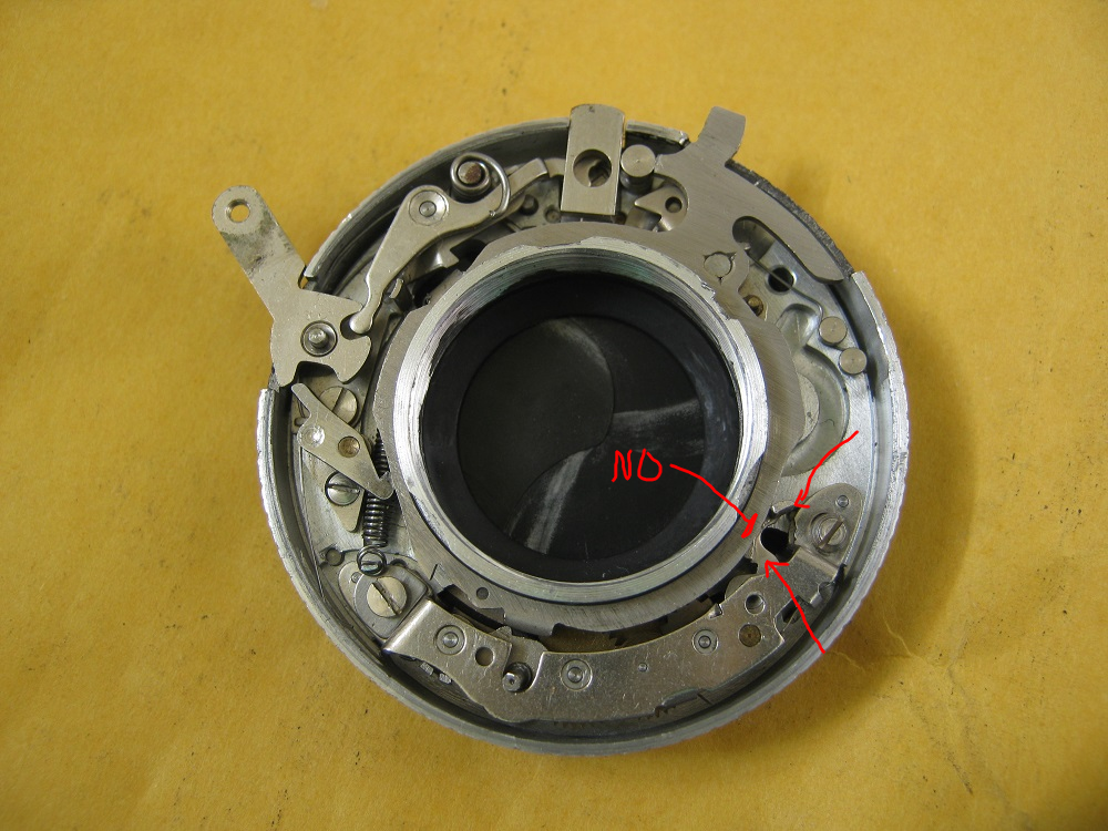

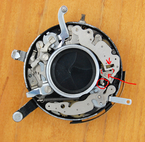

Sounds as if the slow speed escapement is not disengaging. Shutters have a lot of designs so it's hard to be specific. In this photo, you can just see a small gear under the top cover that has a series of triangular pointed teeth. This is the star wheel. Below that is a silver part with a largish screw through it. this is the pallet. The pallet has a notch in the middle with two 'teeth' one at each end. these teeth rock back and forth on the star wheel for the slow speed escapement. For higher speeds, the pallet is pulled away from the star and does not engage and you get the faster speeds. A common cross-over point is between 1/10 and 1/25, which soulds like what you have going on.
There is usually a tab of some sort that gets moved by the cover plate to push the pallet away from engagement. In the photo, it is circled for that shutter. There will be a cut-out on the cover plate that moves this tab in and out.
No idea how this is handled on your shutter. Post a photo if this doesn't make sense. Anyway, basic issue: the tab is bent and not engaging. Not uncommon to put the cover on not knowing that this is an issue and the tab gets pressed down.

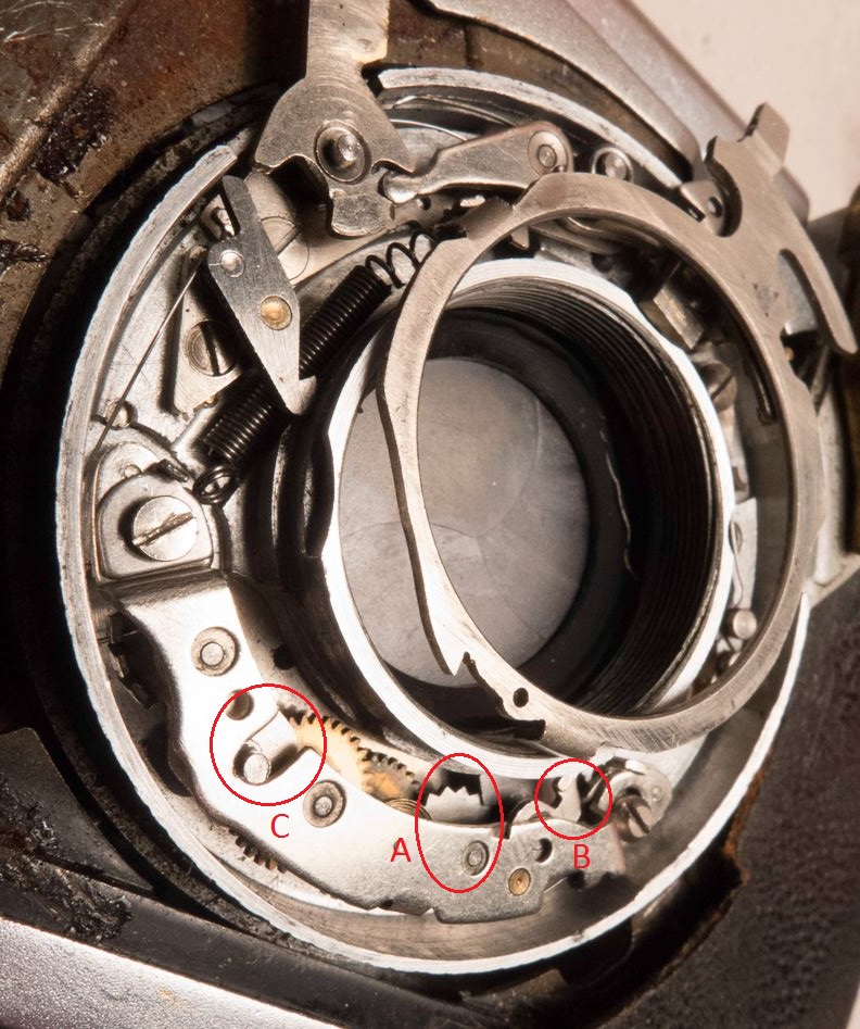

Here are the pictures from internet blog. They are not mine but exactly look the same.
So it looks like A is what you call "sun wheel". "B" maybe the tab for the pallet? But "B" doesn't get pushed by the speed cam unless the speed is set to Bulb.
"C" is the axle of a gear that start to spin from close to the center when the shutter tripped open and when it reaches its resting position at the notch then the shutter closes.

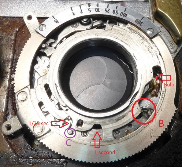

Below is the shutter with the speed cam installed. On the right side the slope will disengage lever "B" on Bulb setting, that is the only protrusion on the speed cam that can touch lever "B". If you continue to rotate lever cam counterclockwise to 1 second then lever "B" will reengage the escapement and the notch at the bottom of the picture will give gear "C" full travel (1 second) and as you continue to rotate clockwise notch changed to slope where it reduces gear "C" travel time : 1/2...1/5 so on. Interestingly, as marked by arrow on the left, as you continue to rotate the speed cam to 1/25, the speed cam has another notch with same depth as 1 second which will give gear "C" full travel. Rotate counter clockwise again to 1/50 sec and the gear "C" position is about the same as 1/10 sec.

The speed cam, when set to higher speeds pushes the pallet lever B outwards.
This disengages the gears connected to the star wheel A which the slow speeds use.
The retard post C is then freed to move inward, this controls the high speed rates (except the highest speed).
If B is not being pushed outward enough then the slow speed gears are still engaged.
FYI, this is all explained in the Nat Cam course material.
So you are saying that lever "B" is pushed clockwise when higher speeds is set? At the point where the speed cam touches lever "B" on the second picture? But in my case the speed cam will just pass on top of lever "B". I was thinking that I might accidentally bent lever "B" inward and the cam should actually touches it but lever "B" won't move clockwise even if I use tool to try to push it.

Yes, the cam pushes B outwards to put is into a disengaged setting.
If the speed cam is put in on top of the pallet lever it will not work correctly. You have to push the pallet lever outwards when putting the speed cam on.
I think you need to show what your shutter with the cam on looks like.
OK I am sorry, upon careful checking it seems my unit is a little bit different than that picture. The lever B is different. Let me see if I can take clear picture of it and post here.

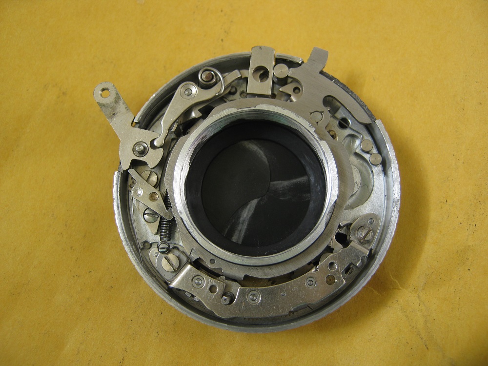

Well, after comparing the pictures it turns out that my shutter is exactly the same. This lever "B" that disengaged when shutter is set to B will always engaged in any other speed settings. Scratching my head here. And there is no other lever that engages/disengages when hitting above 1/15 secs. Am i missing any parts?

Put the speed cam back on top ... and then look at where the levers and things interact with it.
The speed cam is the one that sets the position of the palette lever.
If that is your shutter, the cocking ring is not installed properly. The B lever has only the upper tab riding on the cocking ring. It should have the lower part, now hidden by the cocking ring, riding along the side of the cocking ring. The tab that projects up rides along the speed cam slot. Maybe, as suspected, the B lever has been bent downwards and is riding under the cocking ring, not the cocking ring not being seated down enough? It looks seated at the 'timing tab' position (wrong term, but the little gray tit at other end of escapement).
Well, I think. Again, need to see speed cam in place.
There is no lower part. As you can see from post #5 with pictures from another person on internet, 1st photo shows lever B. And 2nd photo shows the speed cam in place.

Turned out you are correct, lever B was bent 0.0000001 mm downward. Its protrusion should sit higher and makes contact with the speed cam exactly at 1/25 secs and higher speed. Thank you!
