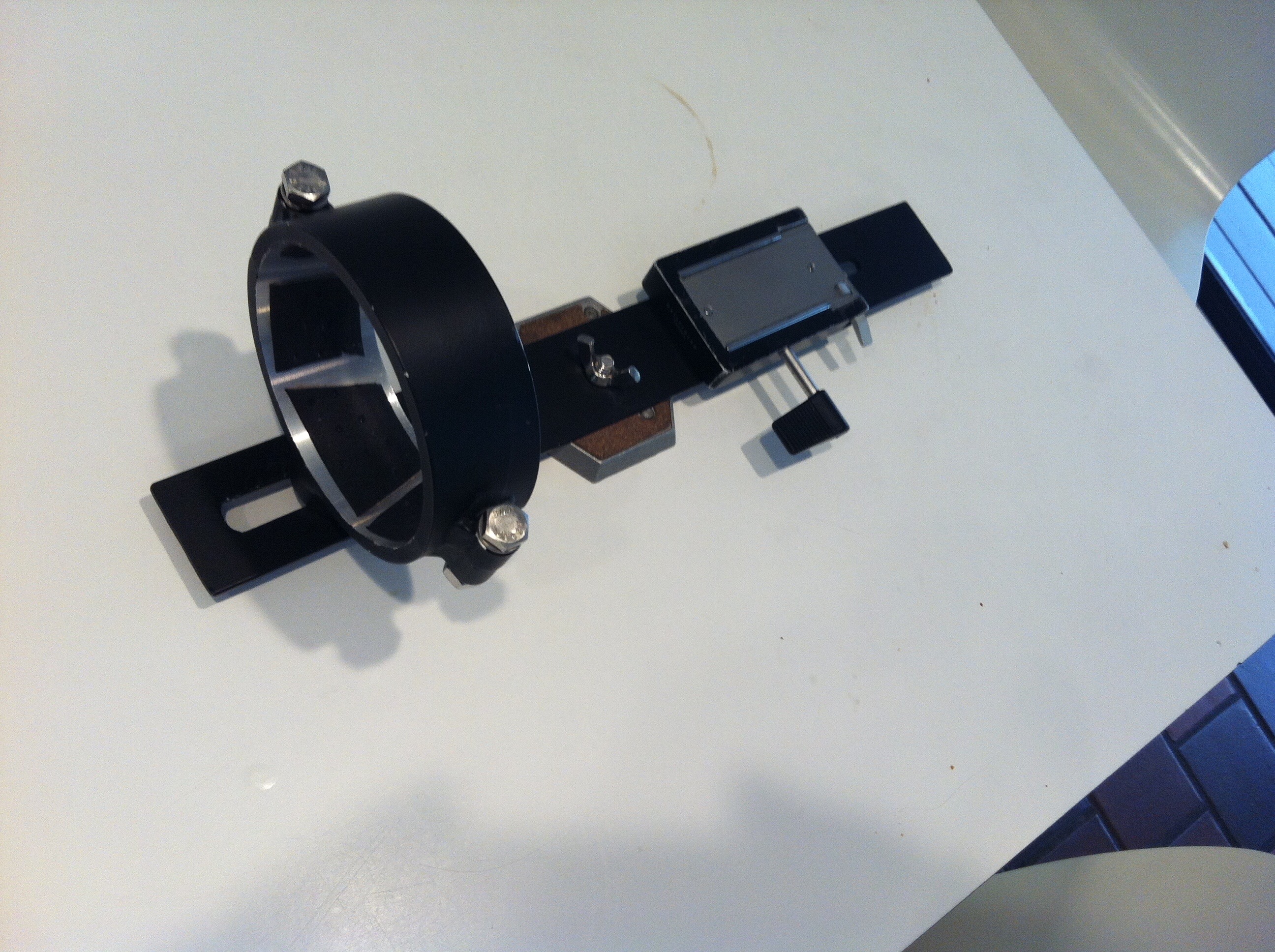

I also have a Hasselblad 350 and needed a support. I designed my own and had a machine shop make it. It is simple and very sturdy. It is also adjustable length wise but could be modified to have different collar heights. The lens has a tapered barrel so they had to match the taper It is aluminum and I added some tennis racket wrap inside the collar so there’s no slippage or metal to metal contact. The camera quick connect, tripod quick connect and collar are all adjustable length wise to balance the weight and if I want to use a 2x The cost was $60 not including the 2 connectors which I already had. The main cost was matching the taper
