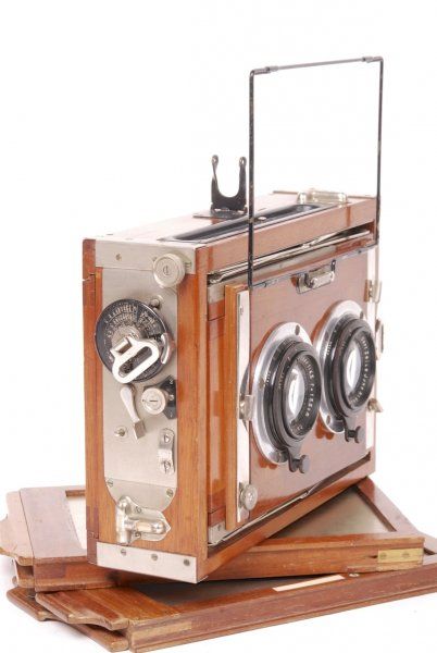

I found this image on pinterest. There was a link to a French site, but since the camera was sold, the page from the site was gone. "Google" Images was of no help.

Some sort of stereo camera, but I do not see the two speakers.

Based on what we can see, it's a plate camera, with a strut folding front standard. There were a large number of different models of glass plate stereo cameras, often in a format that was double in one dimension of a standard plate size like 9x12 cm or quarter plate (3 1/4 x 4 1/4 inch). Ernemann made at least a couple different ones, and nearly every company that was making plate cameras as of the 1890-1910 period made at least one. Without more photos, we'd probably need to hear from someone who owns that specific model to get a positive ID.

Deckrullo tropical stereo by Nettel / Contessa-Nettel / Zeiss probably. It has Carl Zeiss Jena lenses, you can see that if you zoom in to the image.
Stereo version of these: http://camera-wiki.org/wiki/Deckrullo-Nettel
See for example: https://www.liveauctioneers.com/en-...eiss-ikon-stereo-deckrullo-tropen-6-x-13-1926
I don't have enyclopedic knowledge of these things, but Zeiss + tropical + stereo + sheet film will take you a long way in searching.
Whoa, focal plane. No flash sync, but 1/1200 second shutter speed makes it very intersting for some ocasion. If you can adapt a roll film, it would be nice...

Be aware that most of the Deckrullo's have broken shutter cloth, and are not easy to repair. Their shutter was the example for the complicated but reliable Zeiss Ikon Contax shutter. I've repaired quite some, and the Deckrullo's are very nice to operate once they have a good shutter - however repairs come at a cost.

A "Stereo folding camera" search on google retrieved many similar results such as this "ca.1903 NETTEL Strut Folding Plate CAMERA Ortho Stereo F=63/120mm Doppel-Anastigmat Camerawerk Folding Camera Original Antique 1900s"
https://www.etsy.com/listing/751125232/
