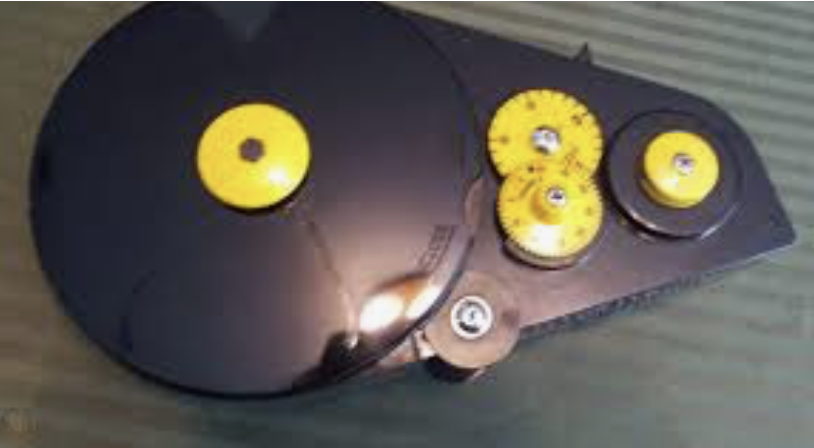

I got an Alden 200 loader in 1975 and to this day have never seen or used any loader as good. If there is a better one out there I'd like to know.
